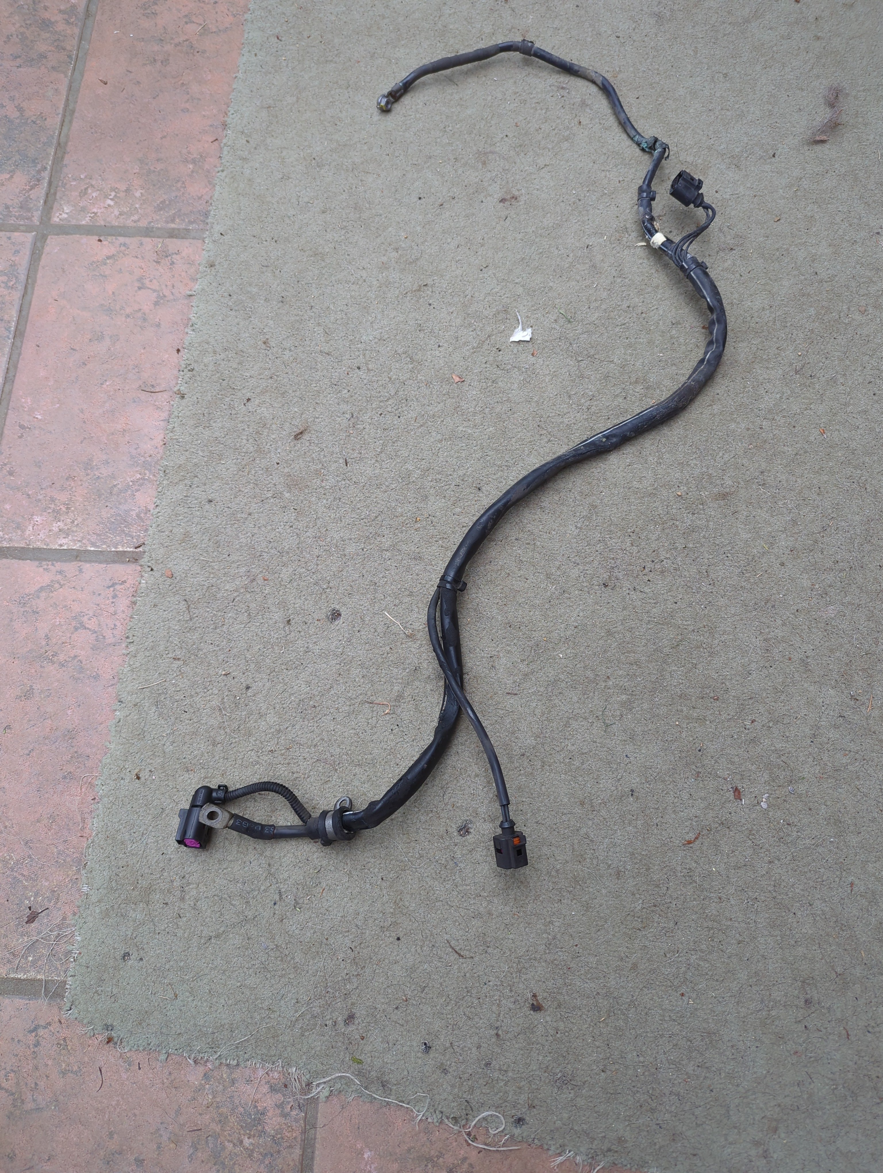

OK, so it's more than one cable wrapped up together, but in the pic with lots of green busted strands, isn't that the thick alternator cable part that's suffered?
Anyway, you've got to replace whatever's degraded dramatically there, so add your reg number or VIN, and I can try to find a part number for the sub-loom.
Thanks Pete you've been a big help here.
Removed the loom. And after looking thru eBay n google images finally discovered my loom doesn't go to starter...only the alternator and aircon pump (95% sure)

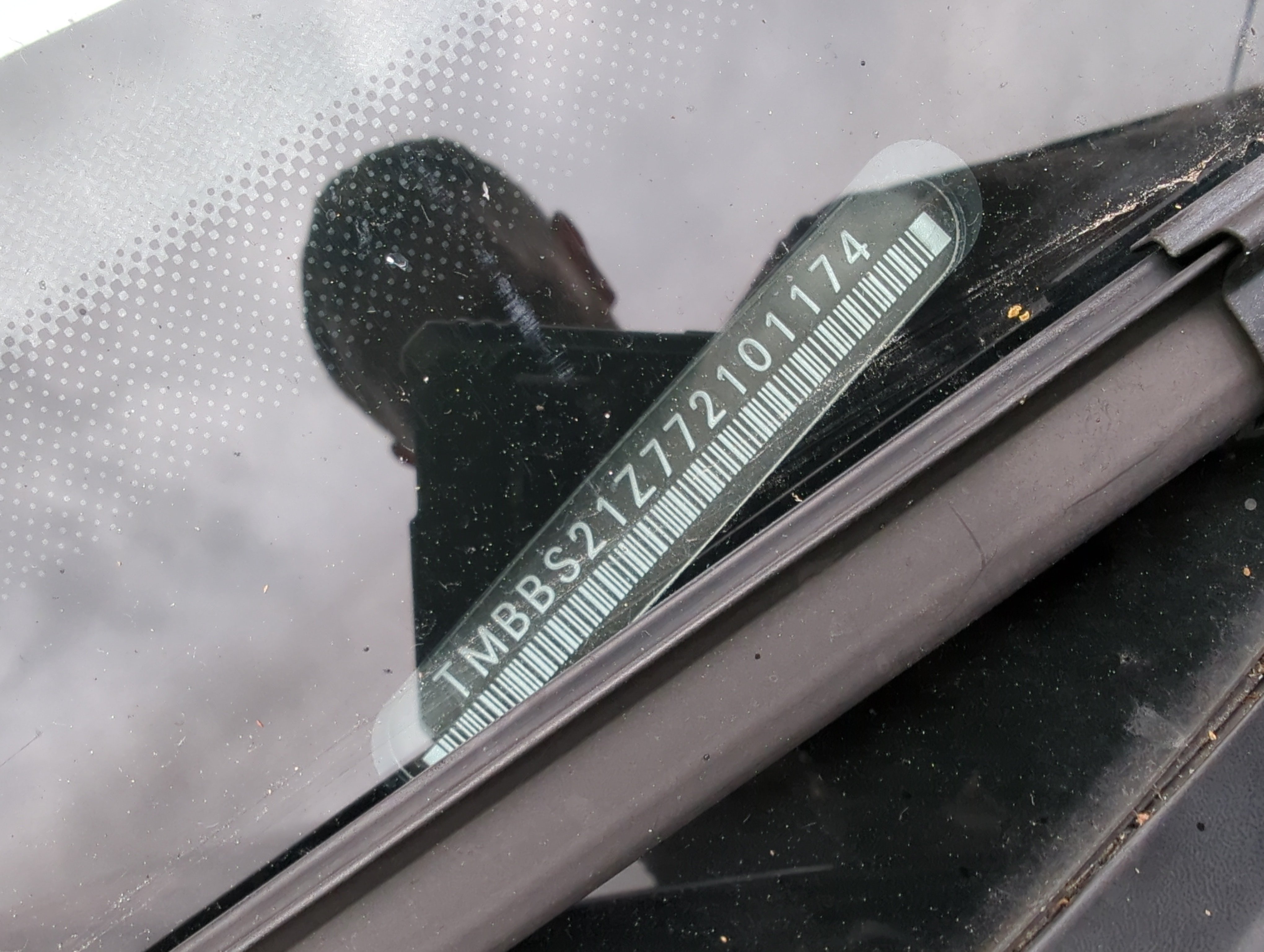

2nd pic the vin?
Thanks again
