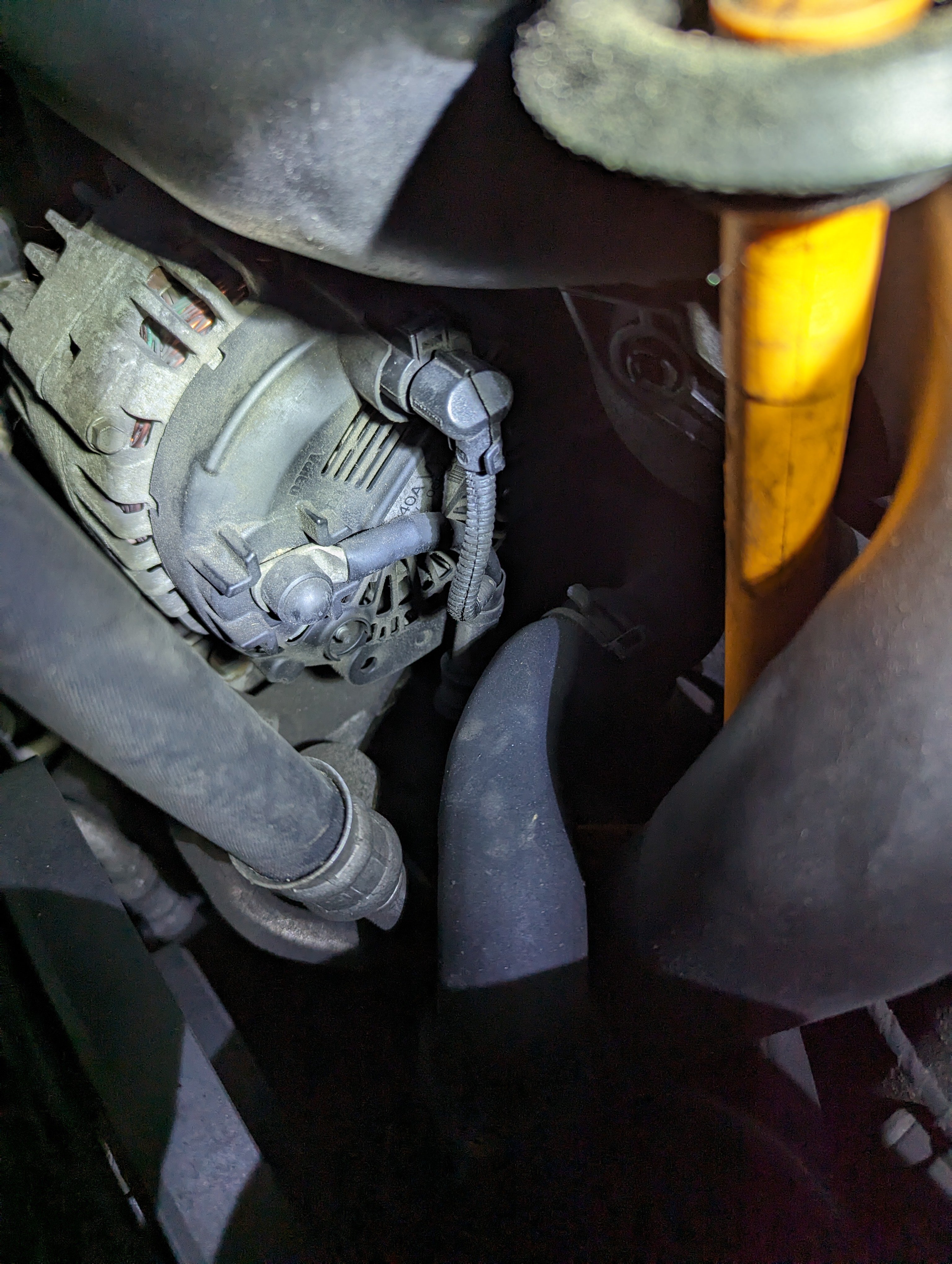

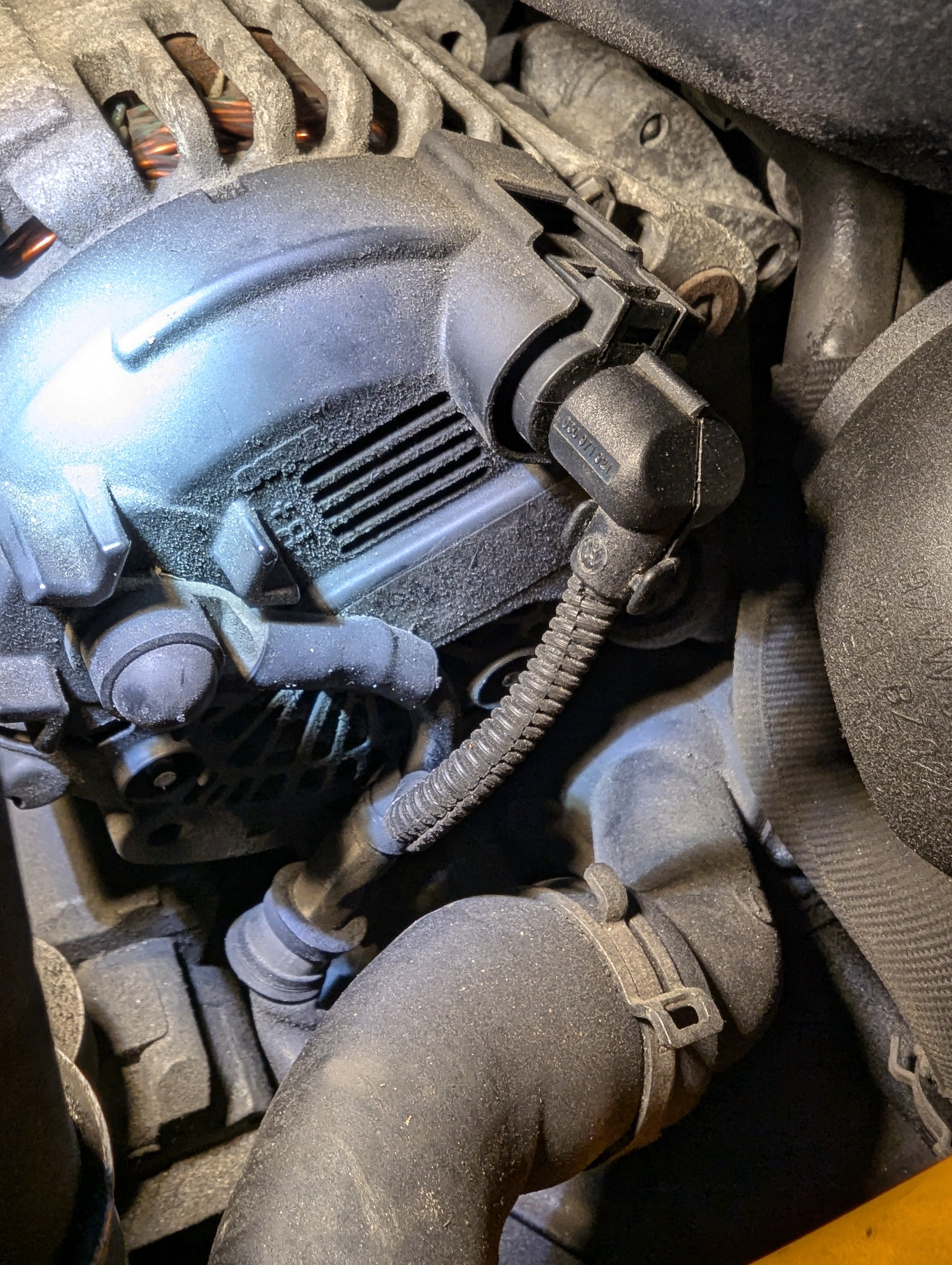

There was a black wire held on with nut. And another cable with the usual bag plastic connector. I disconnected it and touched multimeter to one the 2 pins on the alternator and got the reading off that and the metal case as an earth.
Does that make sense:)
Can't see 'main red cable' anywhere. Just those two in the pic
Where the black cap is that wire you want to be on

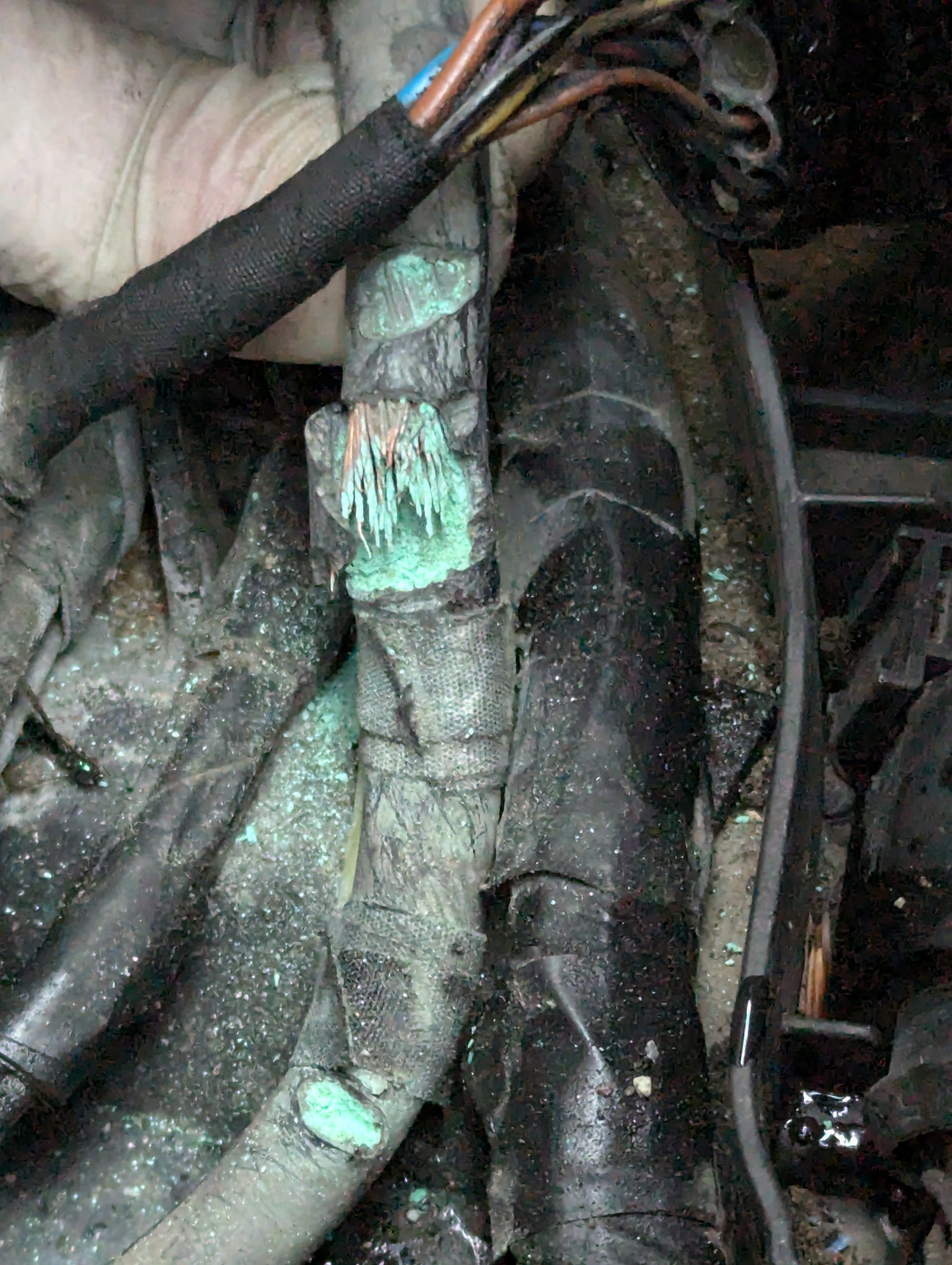

I think one of those cables running back toward battery was chewed by rat. Just noticed some corrosion. I'll try get a pic
The chewed cable with bit of green corrosion on it is behind front left headlight
Edited by huwants2no
Add info to pic in post
If it looks to you as though water has got into the cable then replace it.
Major sign to look for is the internal multistrand copper conductor turning black.
Doesn't look great. That wire goes from alternator to starter and battery, might be worth replacing the harness to start with.
The copper wind inside the alternator?
Bloody rats jesus
No, I was refering to the chewed cable in the photo.

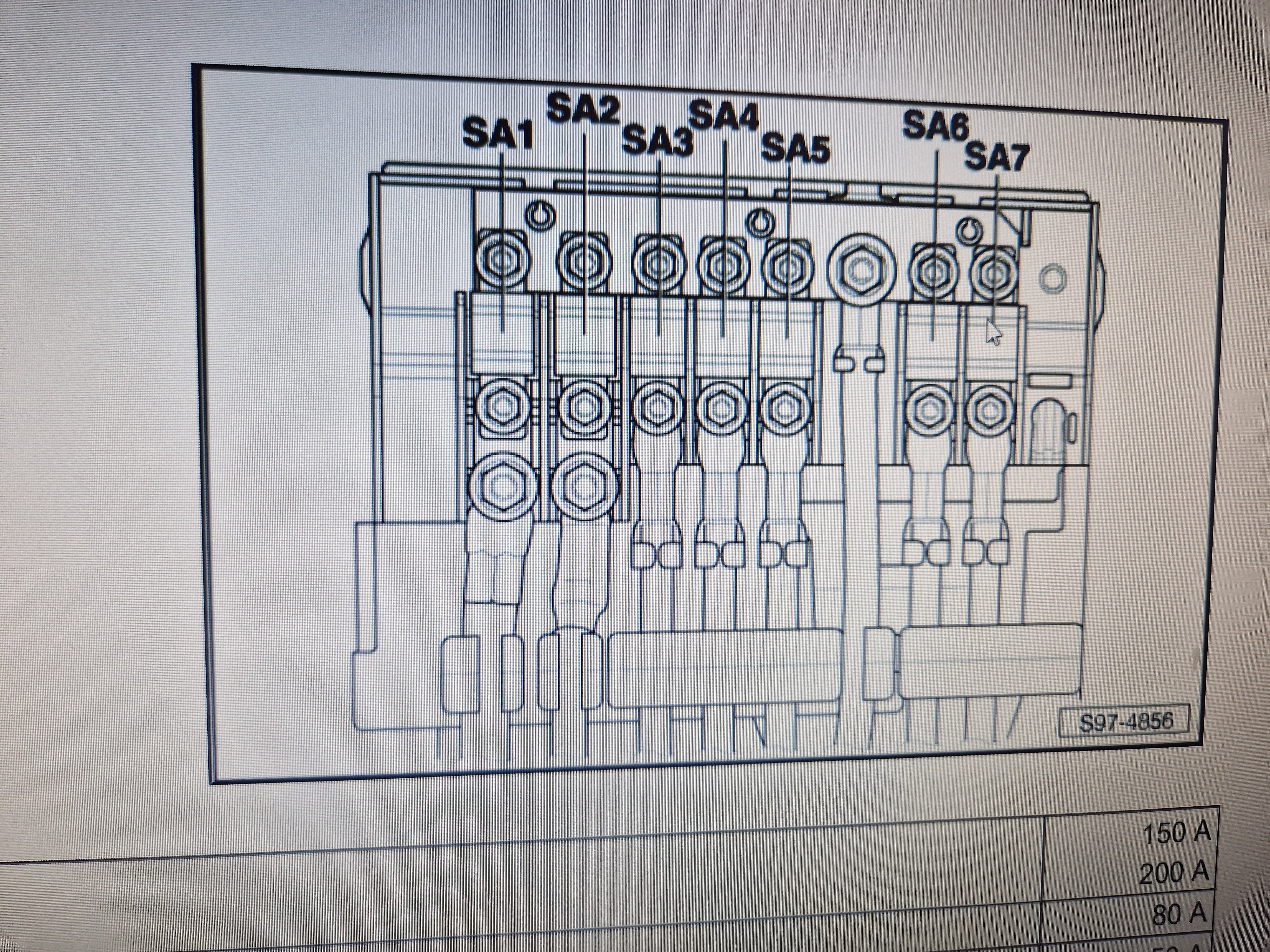

That alternator output wire doesn't go to the starter motor, it goes direct to the leftmost (as viewed from front of car looking into bay) big vertical fuses at front of engine bay fusebox.
Wire gauge depends on alternator rating fitted, 16mm squared unless it's a 140A alt, then its 25mm sq.  Looking at your earlier pic, it appears to be a 140A alt.

SA1 is the fuse it goes to.

Ok thanks for that and the diagram. Whatever it is it's annoying as hell. 330k miles on this girl,maybe time to move on

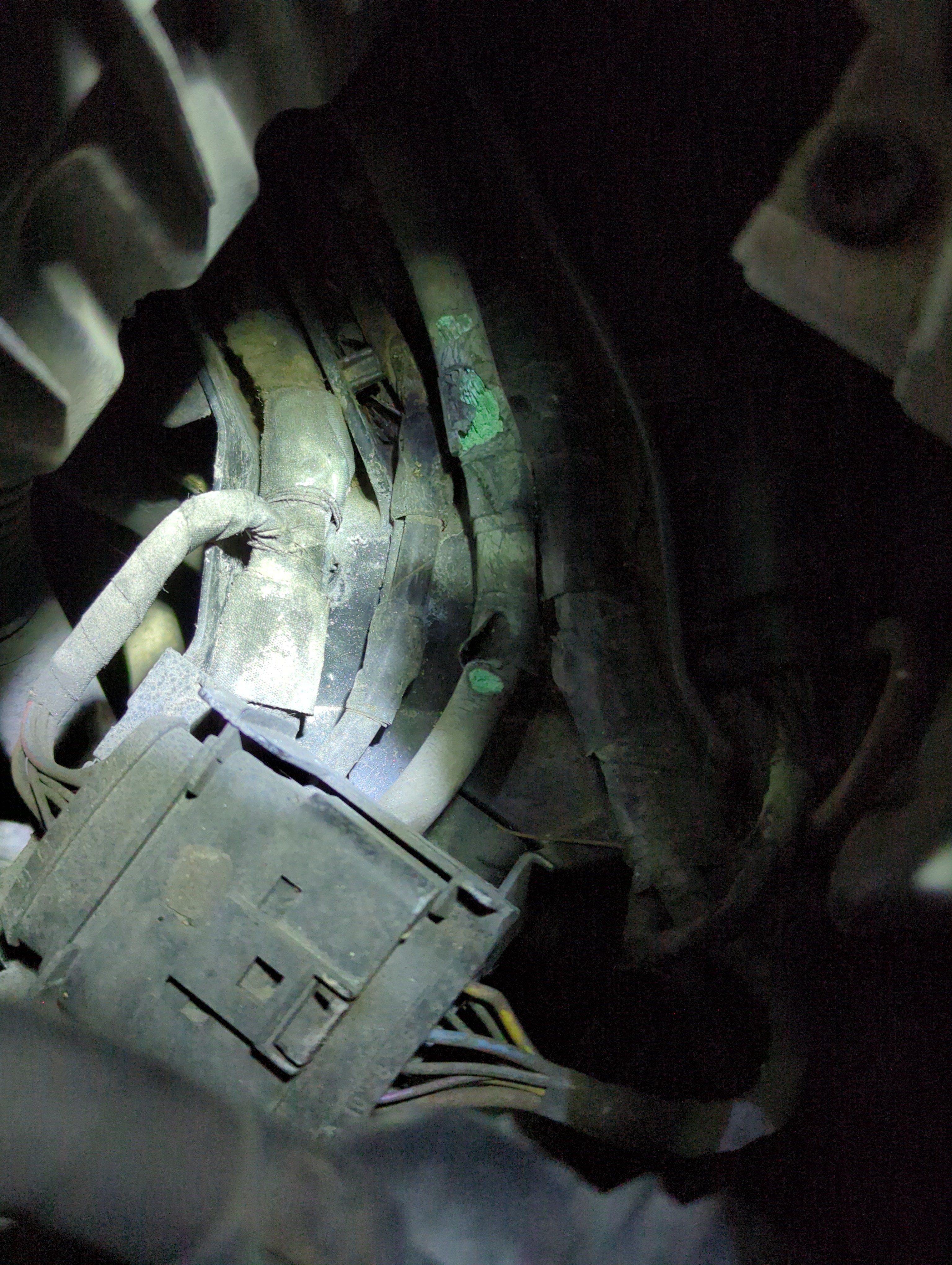

Ok. Removed battery tray and few bits for better look around.amongst other things discovered that the wire I referred to earlier,one that goes into fues box at SA1 I believe is nearly cut thru completely. I'm guessing and I mean guessing that this would cause battery drain when car sitting.
I'm hoping I can replace it.

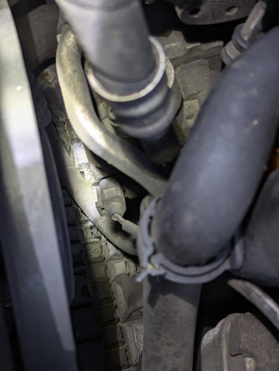

It runs from that fuse box SA1 across to the pump under the alternator. Is that the power steering pump?
Would anyone know is that a cable that I can order online or dealer only.
I'll try add a pic of where it connects...

No it's not that one. Goes to a 2 pin connector on whatever is directly under the alternator on my model. It has metal pipes going to it
Power steering pump?

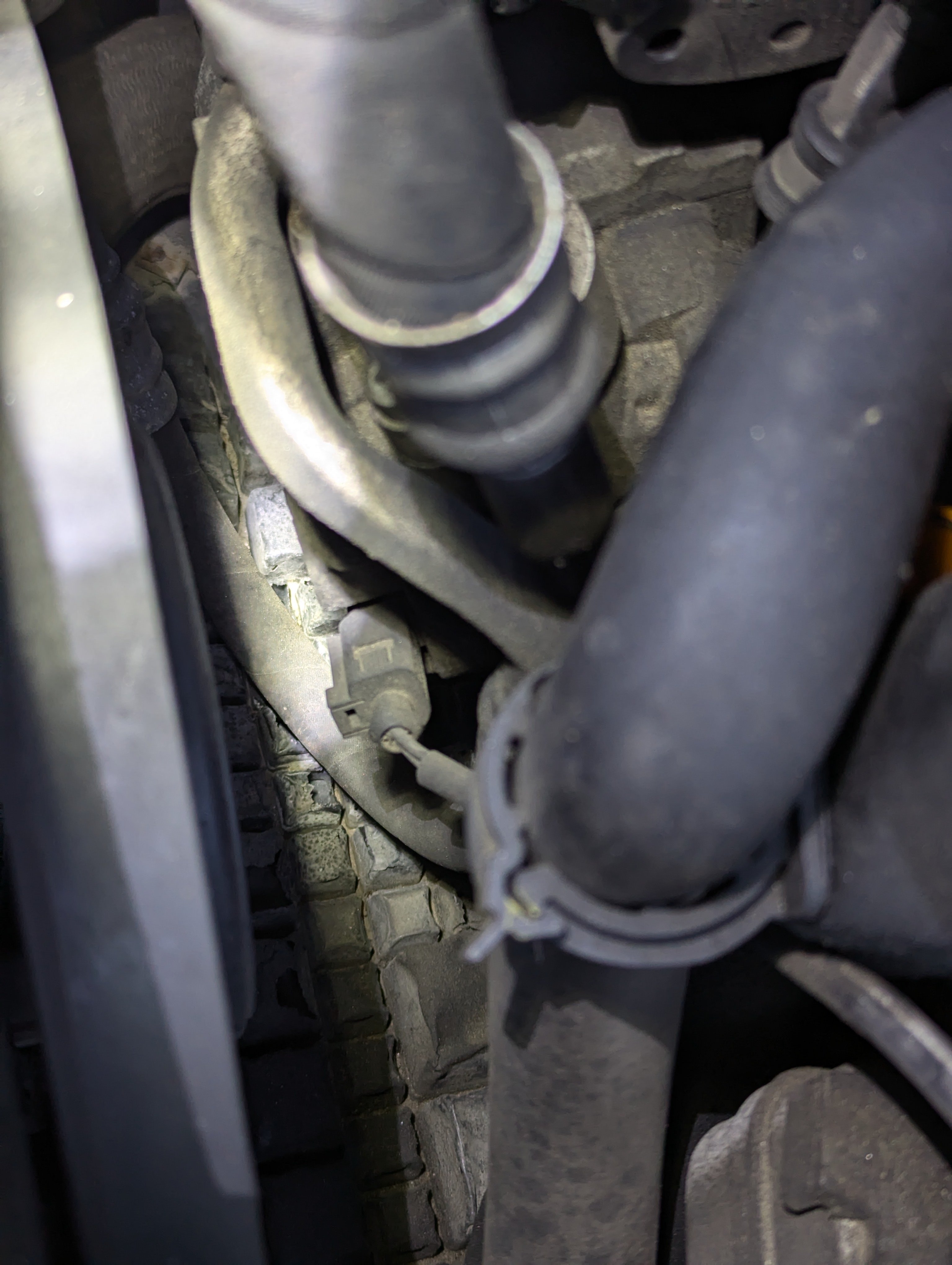

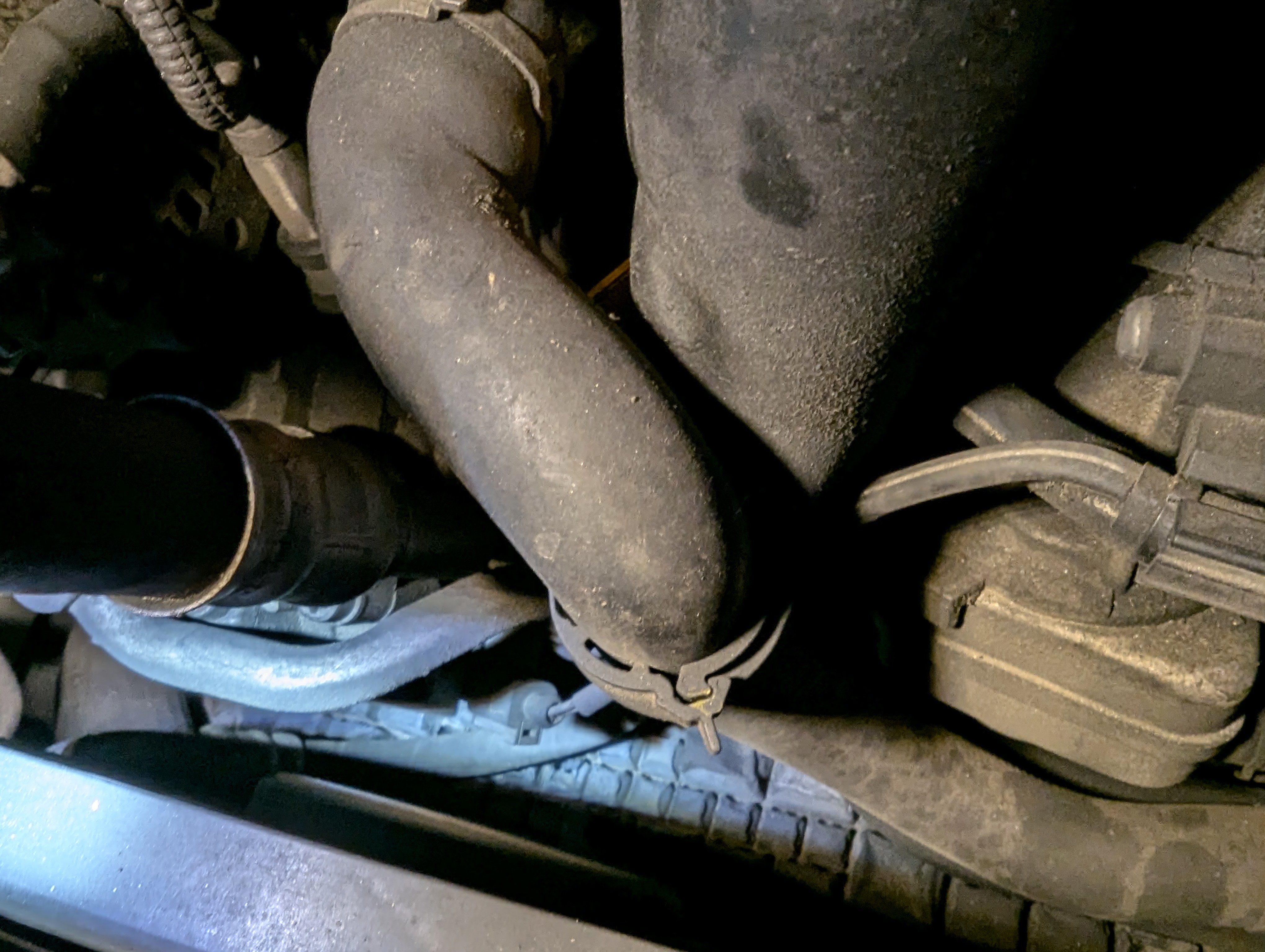

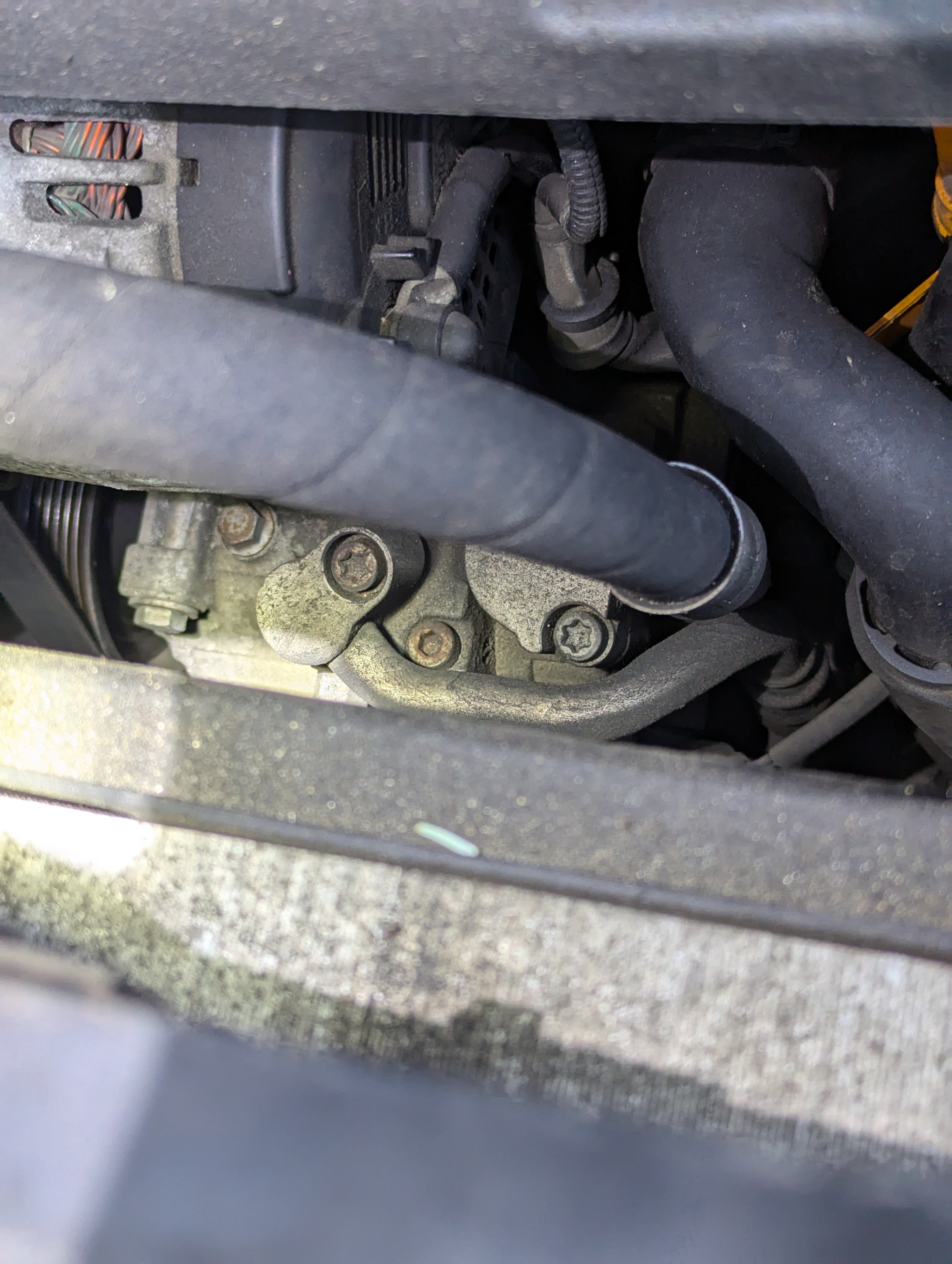

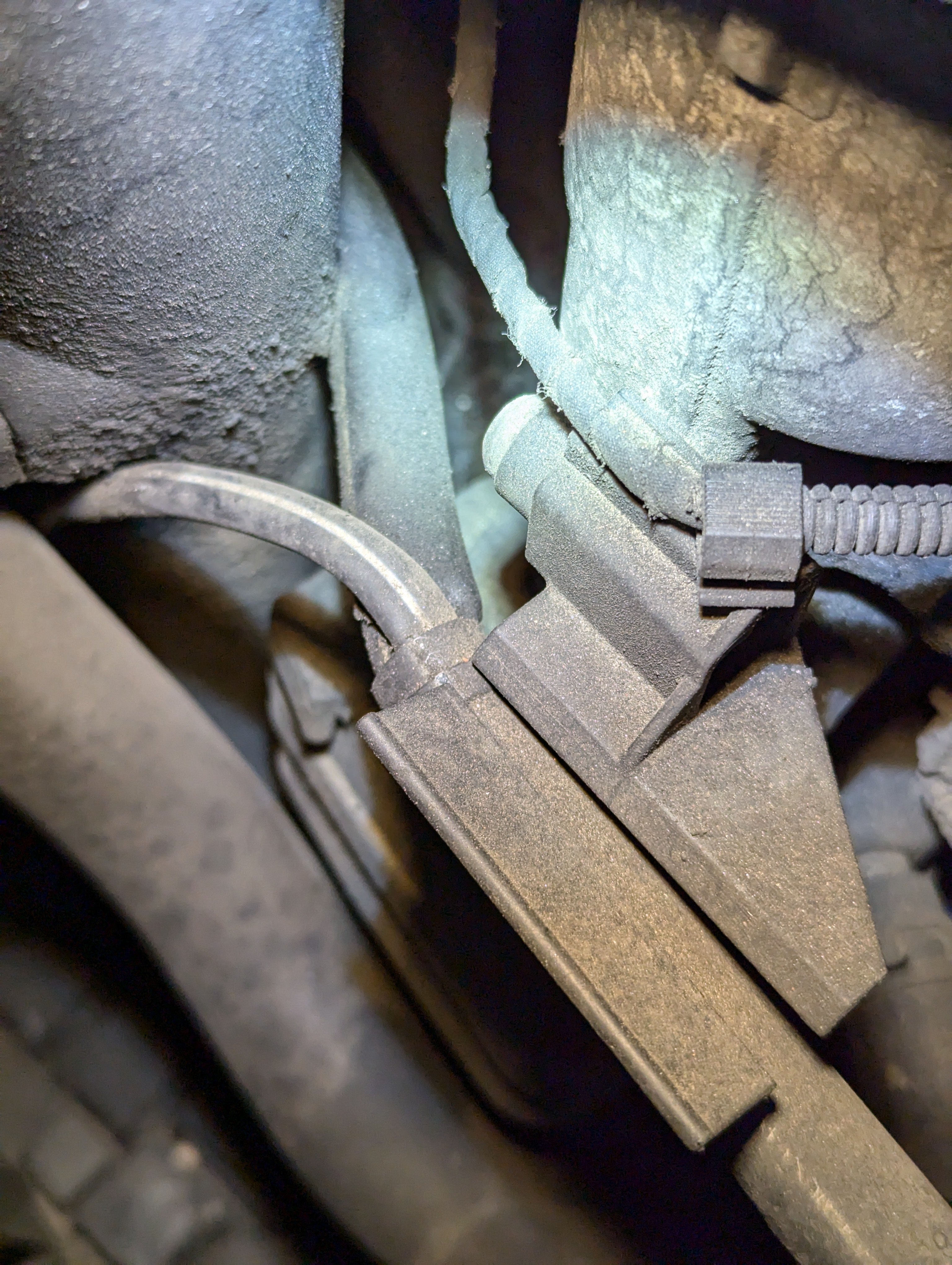

I just looked again. From what I can see and those 3 pics I hope you can too the wire from SA1 comes down and then splits. One goes down to whatever is under the alternator and the other goes to Alternator itself where it also splits again...if you follow me:)
In the top pic it's the smaller cable with the white line that runs down to the other thing (I really gotta find out what that is)
