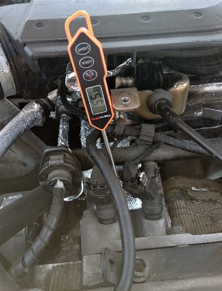

OK then, i the future i will use the IR gun and the digital thermometer, i have them with me.
I would probably give greater acceptance to the digital thermometer than the IR gun pointing at different surfaces and a set positioning on a stand/tripod and not knowing its reliable accuracy and calibration checking from new, the thermometer could have it's own issues but is more likely to be used in the same manner each test and a, hopefully, acceptable range of accuracy in tests.

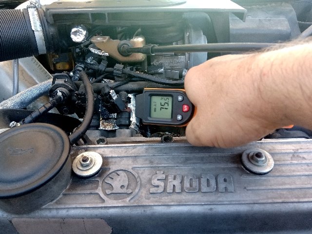

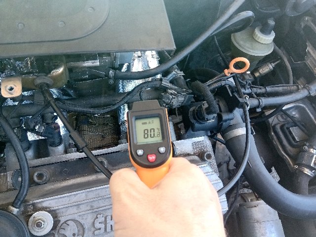

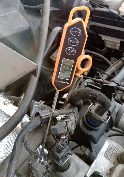

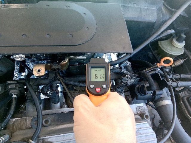

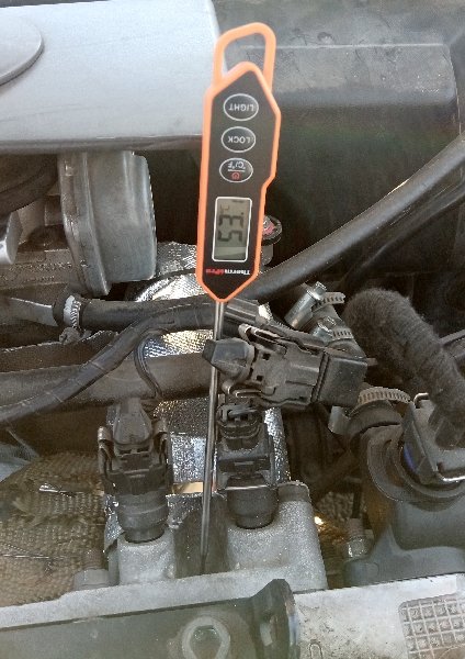

Here are some measurements that i took few days ago, keep in mind that i am not interested for an ''ultimate test'' nor for ''exactly numbers", i am just trying to see the effectiveness of the Heat Shield so 1-2 'C more or less it's not significant for me.
With Heat Shield left-right side
and without.
The difference is about 20 'C which leaves me satisfied and i think this would be reflected in the Fuel Consumption in long term use.

20c that's a big difference, presumably what's under the wraps are at least 20c warmer.

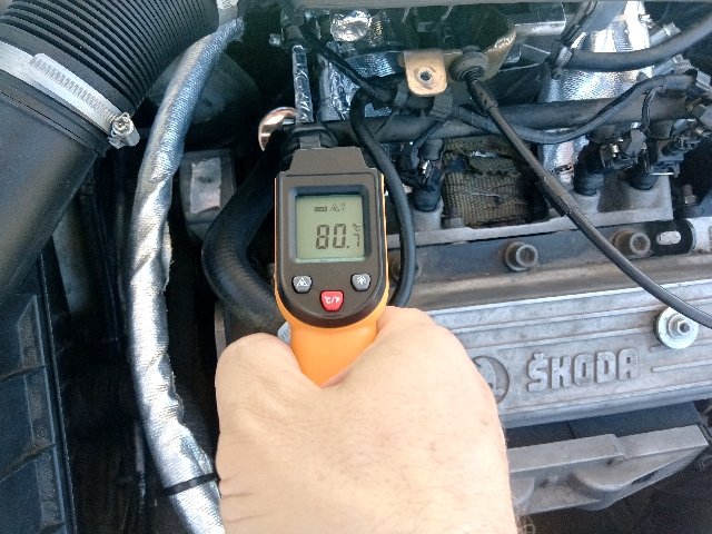

In that test the 80 'C were in the cavity between the fuel injectors, it's few cm below the Heat Shield covered area (on the top of that area are the 60 'C measurement).
Still shows a big difference. which presumably goes somewhere else.

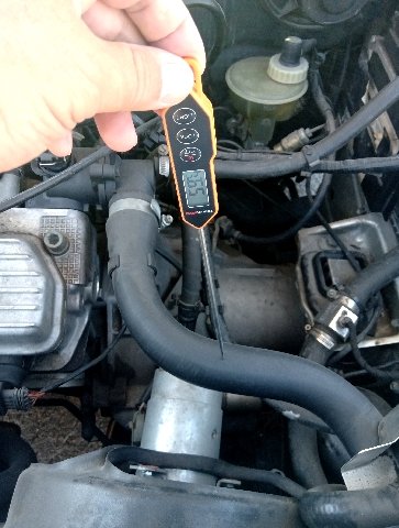

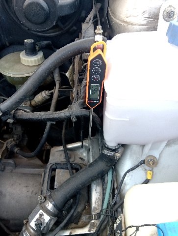

I have take a measurement from radiator hoses (external touch with the digital thermometer's metal nose).
Looked very normal, i will post photos tomorrow.

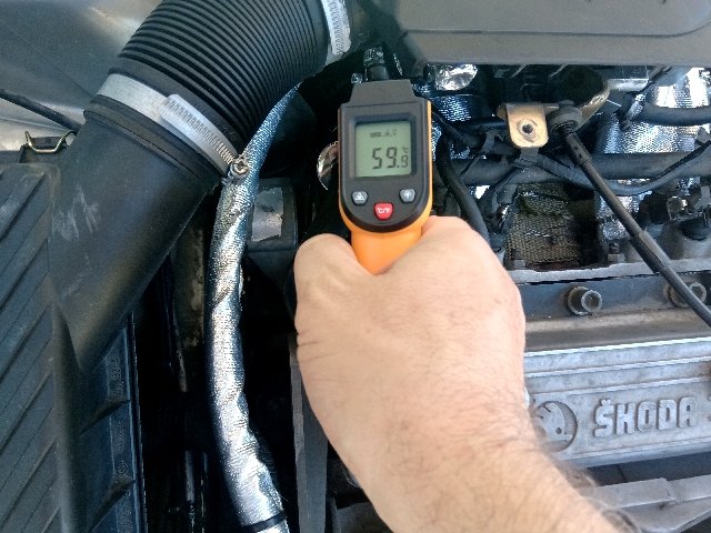

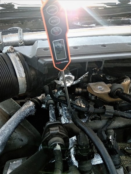

Just for the records.
Not good quality photo due to the sun reflection.
On the bare metal
and on the heat shield.
Now the other side, on the bare metal

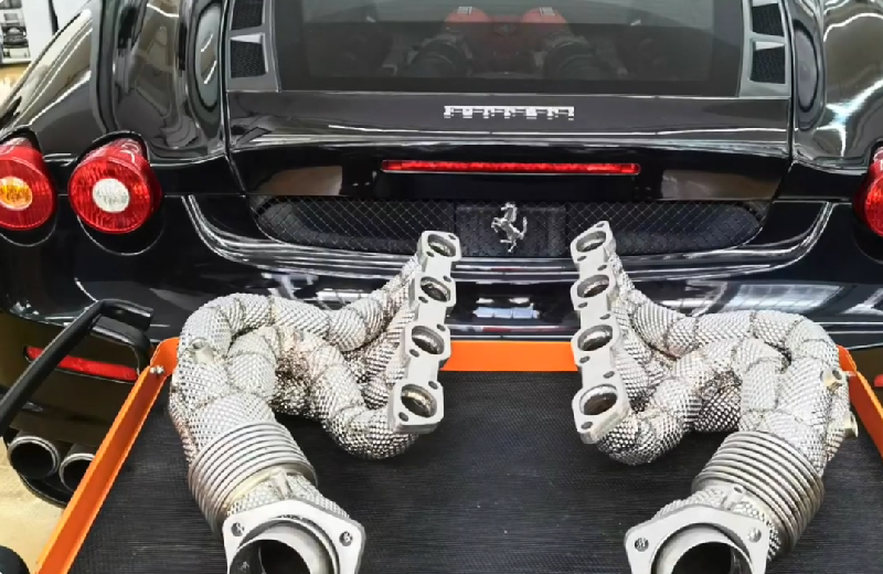

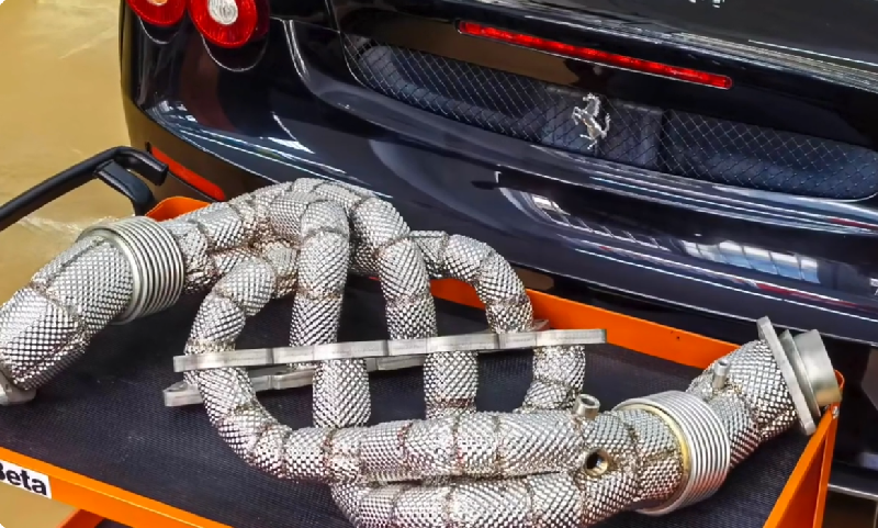

Ferrari 430, the owner of this car decide that needs exhaust Heat Wrapping.
For sure there is no comparison with a Felicia but the owner decide that this would be a benefit for his car
no matter what if an engineer could disagree.
