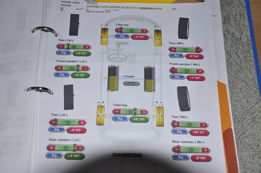

The OSF is stuck at - 1deg 23 mins and they cannot get it better, that wheel has too much negative camber, so classed as RED.
The NSF is - 30 mins.
All other geo is bang on.
Their explanation is there may be a defective bush in the NSF assembly, the car had 2 new top mounts last year, so i am guessing it is one or both bushes in the lower wishbone.

Car had an MoT this afternoon and failed.
The NSF lower wishbone bush(s) are worn, so a new one needed.
It is this corner that could not be aligned to match the OSF the other day.

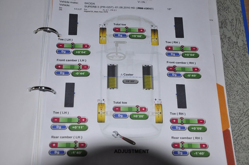

I should have concluded this little saga:
The car went in for a new NSF lower wishbone, an alignment 4 wheel check and adjust and the chassis is about laser straight. Prob better than it left the factory....
Armed with a PASS and 4 new tyres (Conti Premium Contact) and a laser sharp chassis the car drives really well! And so it should., and it all cost around £800.
Steering weight is far less than before and those tiny lateral shakes are all gone.

It was the NSF lower arm bushing that had failed, failed MoT and the tyres and the 4 wheel alignment..

For those interested, here are the suspension results before all the repairs, and as the car is today:
