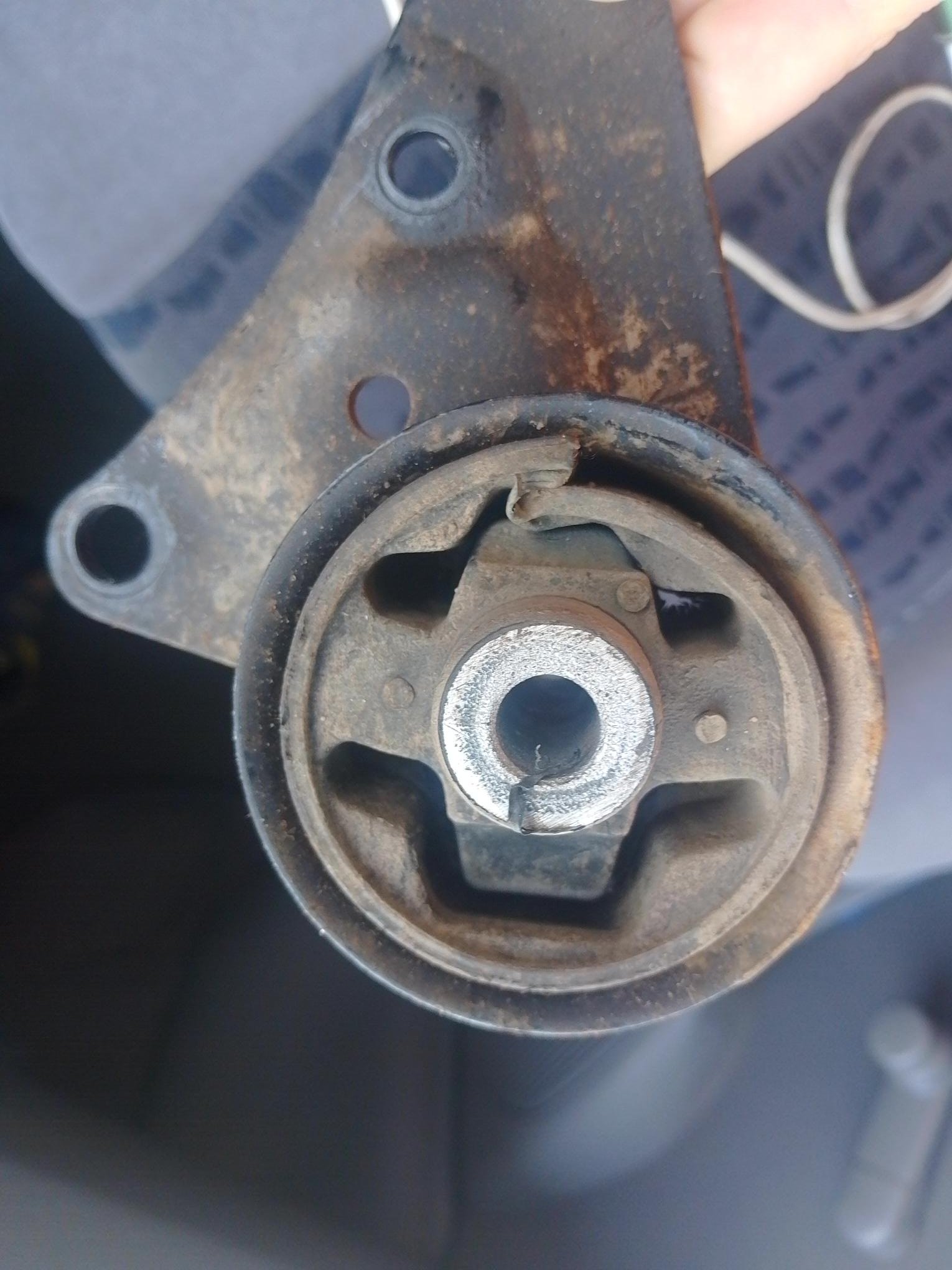

Got a problem that I cannot figure out here and was wondering if anyone else has solved it. I replaced the gearbox mount with a JP Group replacement. This lasted about a month and then failed (see image below). I then replaced it with a Vika one. This failed within about an hour.
Is there something else I am missing that puts too much pressure on these and causes them to fail?

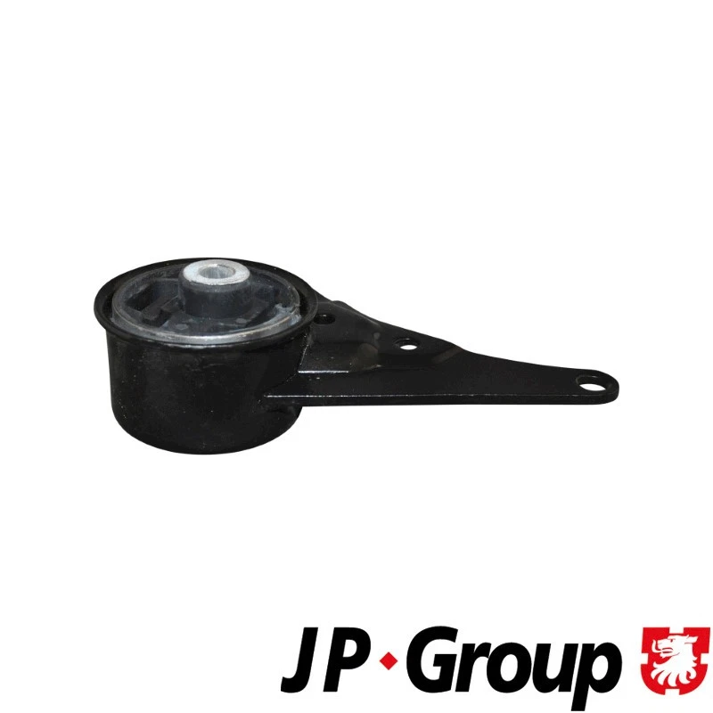

When you buy a Vika one or JP Group one, they come with the steel mounting plate like this:

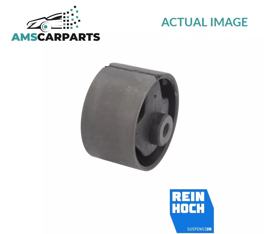

The MAPCO ones look like they are just the circular units that you have the press into the steel mounting plate:
Interesting the supplier of the MAPCO one has said that they do not think this is the correct part of a MK2 Felicia (2000) 1.6. Any thoughts on that? Is it because I am buying the wrong part that they are failing?
If the picture is correct, this is 1.3 engine mount. That indeed isn't compatible with 1.6.
The bottom gearbox mount is also different - 1.6/1.9 uses larger diameter mount and the metal brackets is slightly angled, because the VW engine is mounted higher than the Skoda one. But I cannot tell which is which just from picture.
for 1.3 there were full with bracket

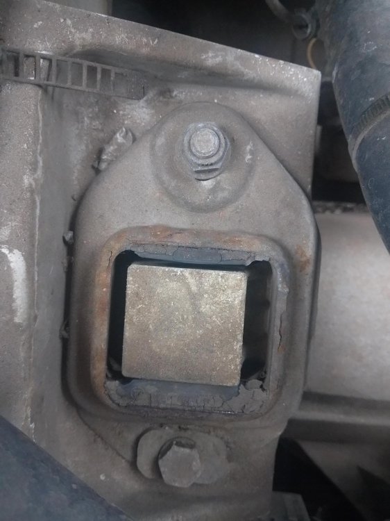

The 6U0 199 331 does look particularly suspect so maybe that is causing the 6U0 199 427 to fail:
I know from the Felicia Haynes manual that the positioning of this end mount in your latest picture is fairly important: as they recommend that you spray paint around that upper plate to guide yourself to the correct position when re-fitting it, which I always did. Maybe yours has been put back out of position in the past, as I can't see any paint!, and that could be causing extra stress on the rear mount?. Trial and error fitting this one last and maybe loosely fitting whilst supported underneath by a trolley jack and see if it settles itself to a particular position...
