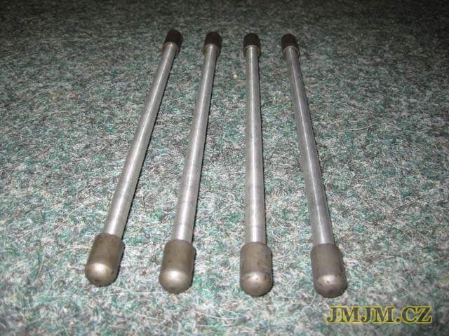

ISTR that some Skoda OHV engines have a mixture of steel and aluminium tappets.
Not tappets, pushrods. Injected 135/136 engines have aluminium pushrods for intake, steel for exhaust.
I presumed that the pushrods in question are monometallic, but the slack adjusters are always steel, If so, then you have bimetallic bearing faces at both ends of the intake pushrods.
the aluminium pushrods have steel ends.

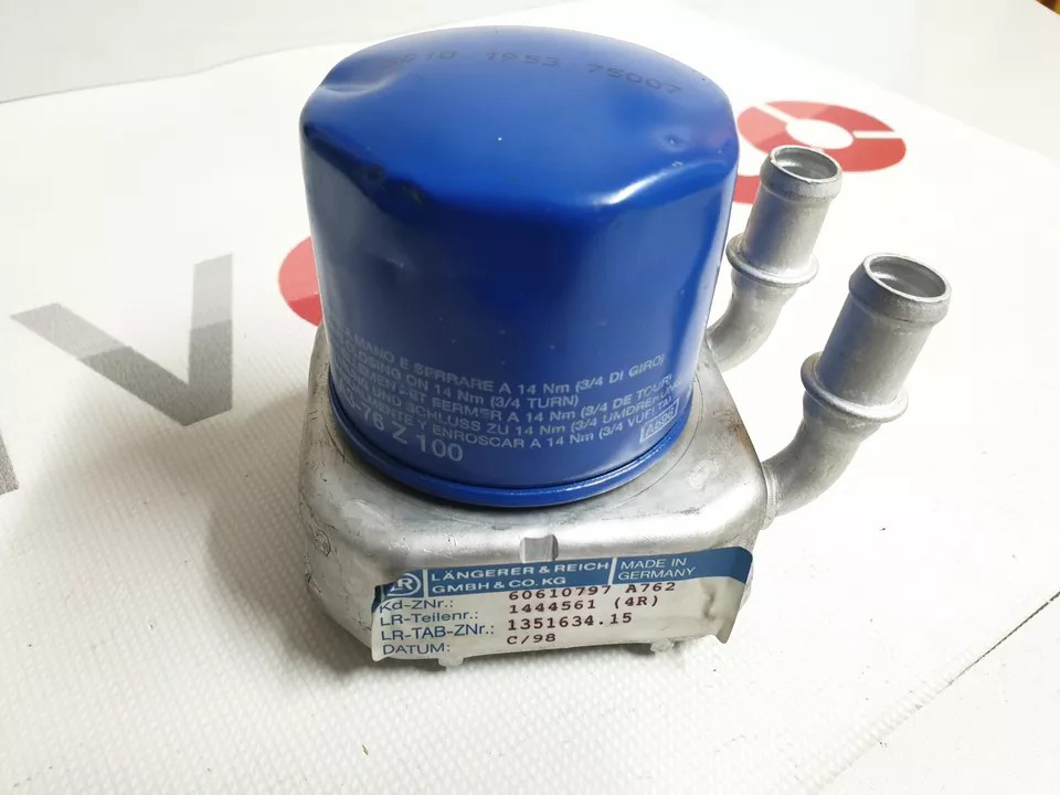

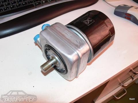

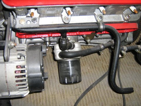

5 hours ago, D.FYLAKTOS said:
Like this?
Like this:

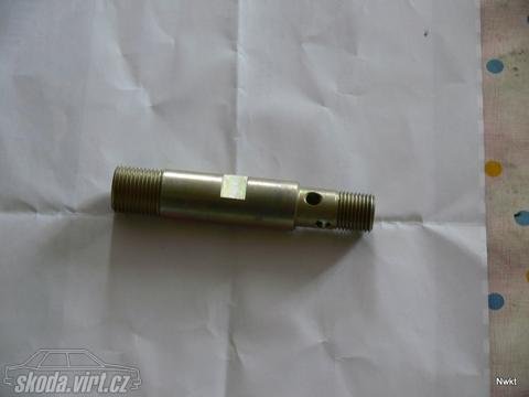

The heat exchanger comes from Felicia 1.9D or similar:
Unfortunately it requires a custom part due to different threads between Skoda and VW blocks. I remember seeing a drawing, but cannot find it..

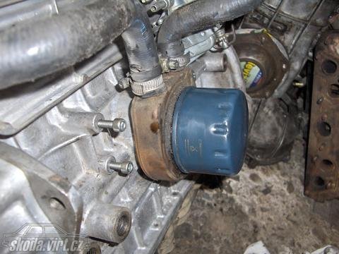

I also found mention of a Renault heat exchanger which is supposedly easier to fit, but I found no more info apart from this picture
Edited by Papez

I've also found some info about Ford pinto engine oil cooler sandwich plate might fit.

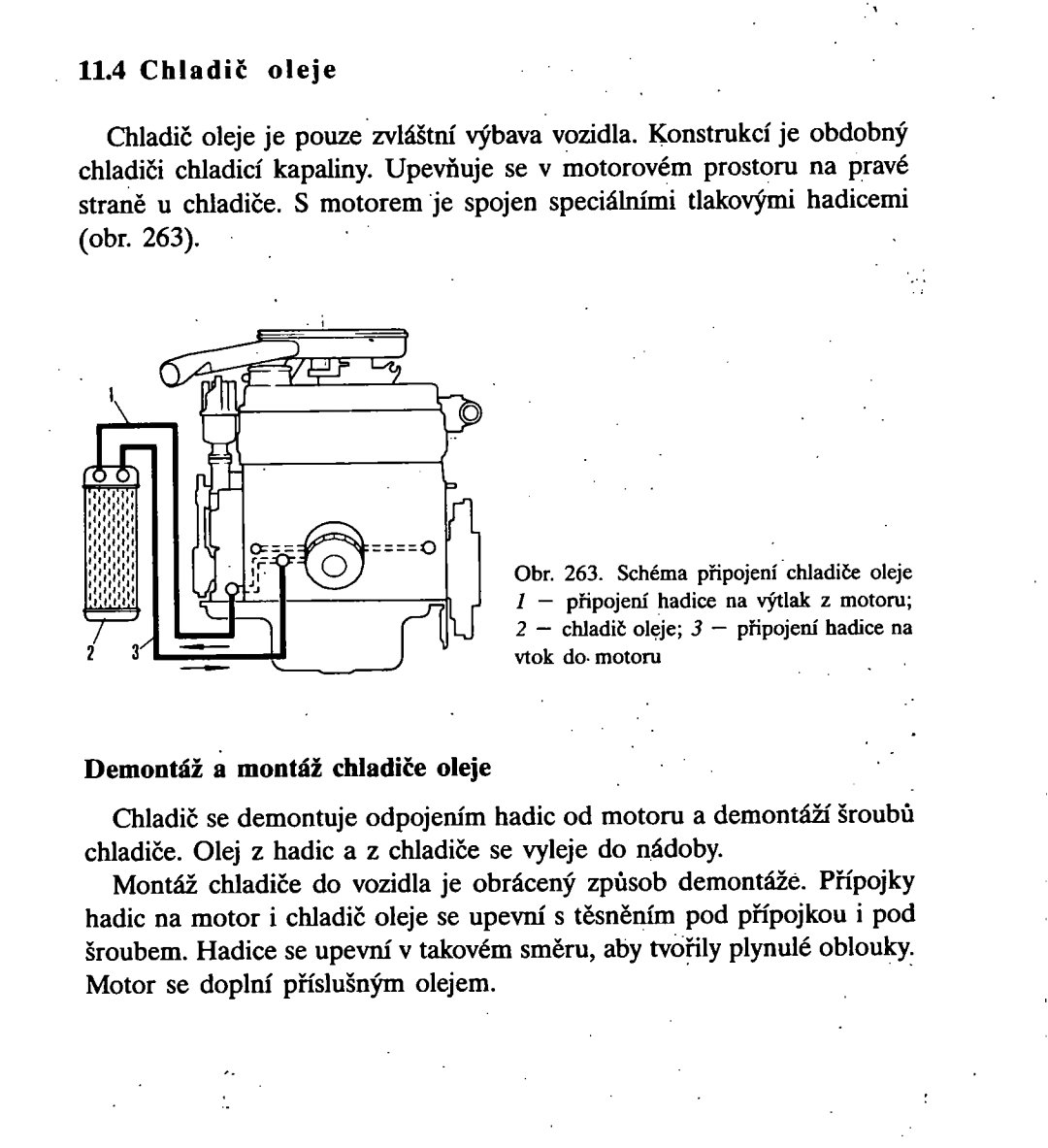

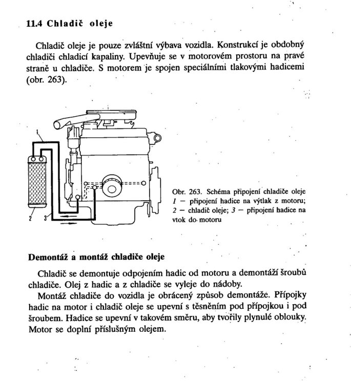

I found mention in Andrt's book, it says special/optional equipment but nothing about origin.. and no mention of thermostat.
Screenshot_20240705_154901_SamsungNotes.thumb.jpg.5e8c5d210573a48a2942f06f89710b7b.jpg

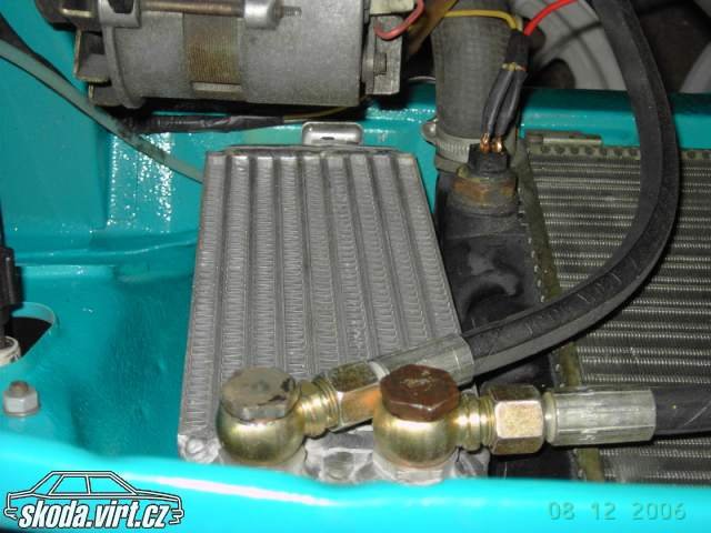

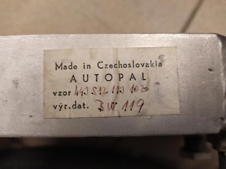

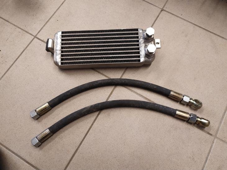

Trying to find some more info, I only found some old listings, showing that it was made by Autopal (manufacturer of the factory coolant radiators)
And photos of installed cooler
