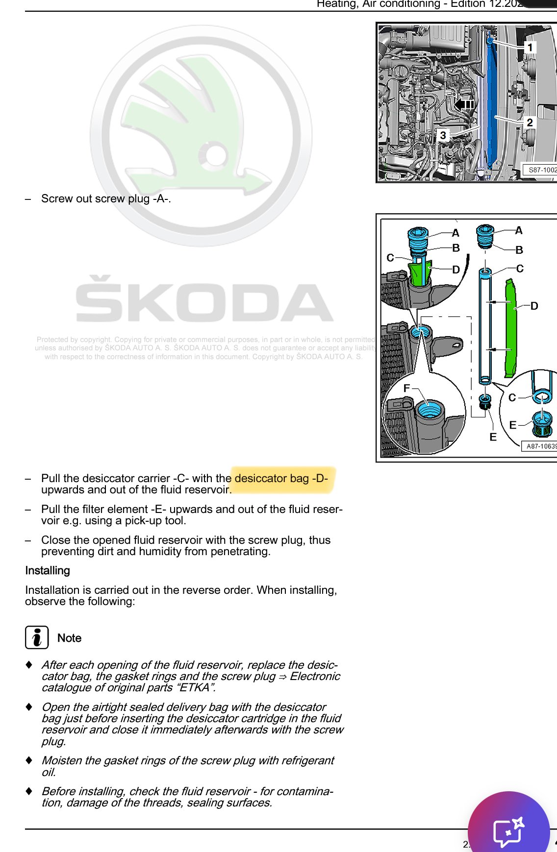

I want to mention that not only the engine cooling expansion tank could have a silikat bag but the AC system also has a dryer that contains pretty much the same material inside it in form of small balls, so maybe you are right about something being clogged up.
Edited by VAskodas
Adding screenshot

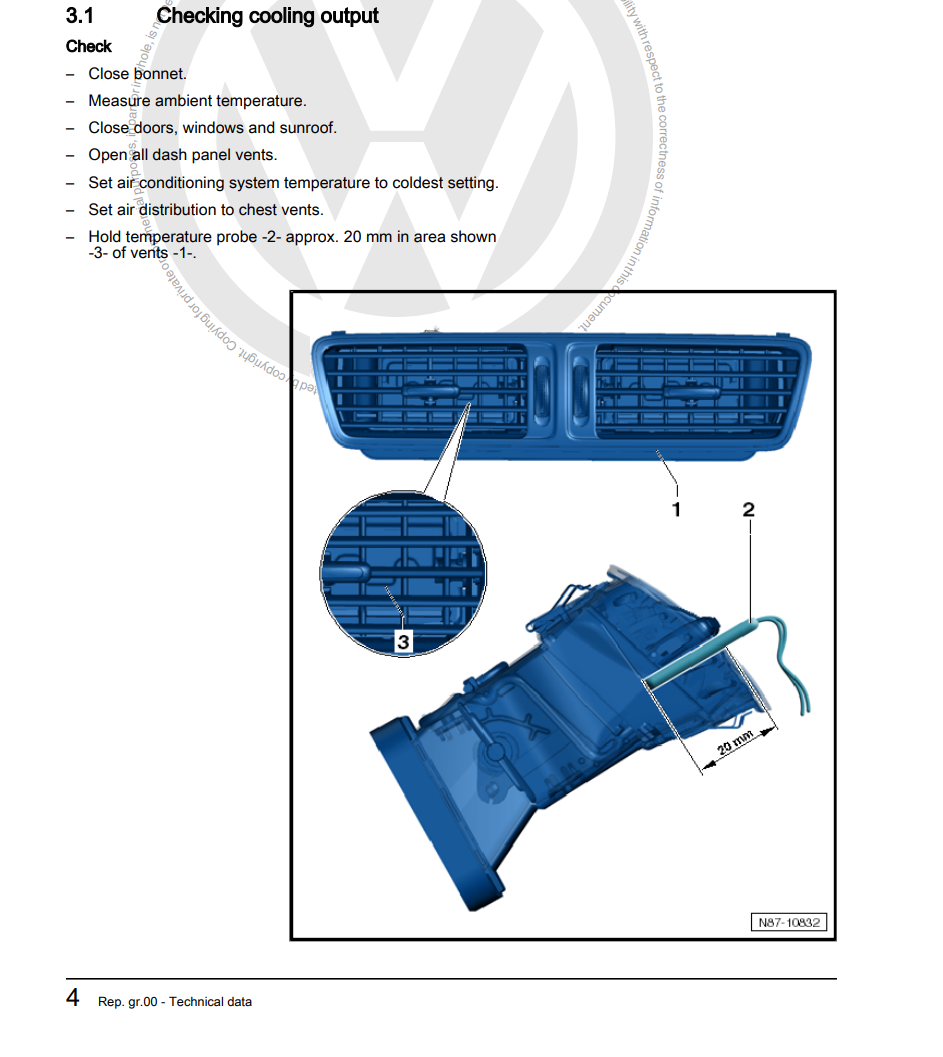

Just FYI, bear in mind this manual is for a Passat but it gives a good reference for expected temperatures at a given ambient:
image.thumb.png.f8ce9b67416375c895998de9a27289fc.pngimage.png.241fb477b85b40819f469883a837ceaf.png
Edited by SuperbTWM
