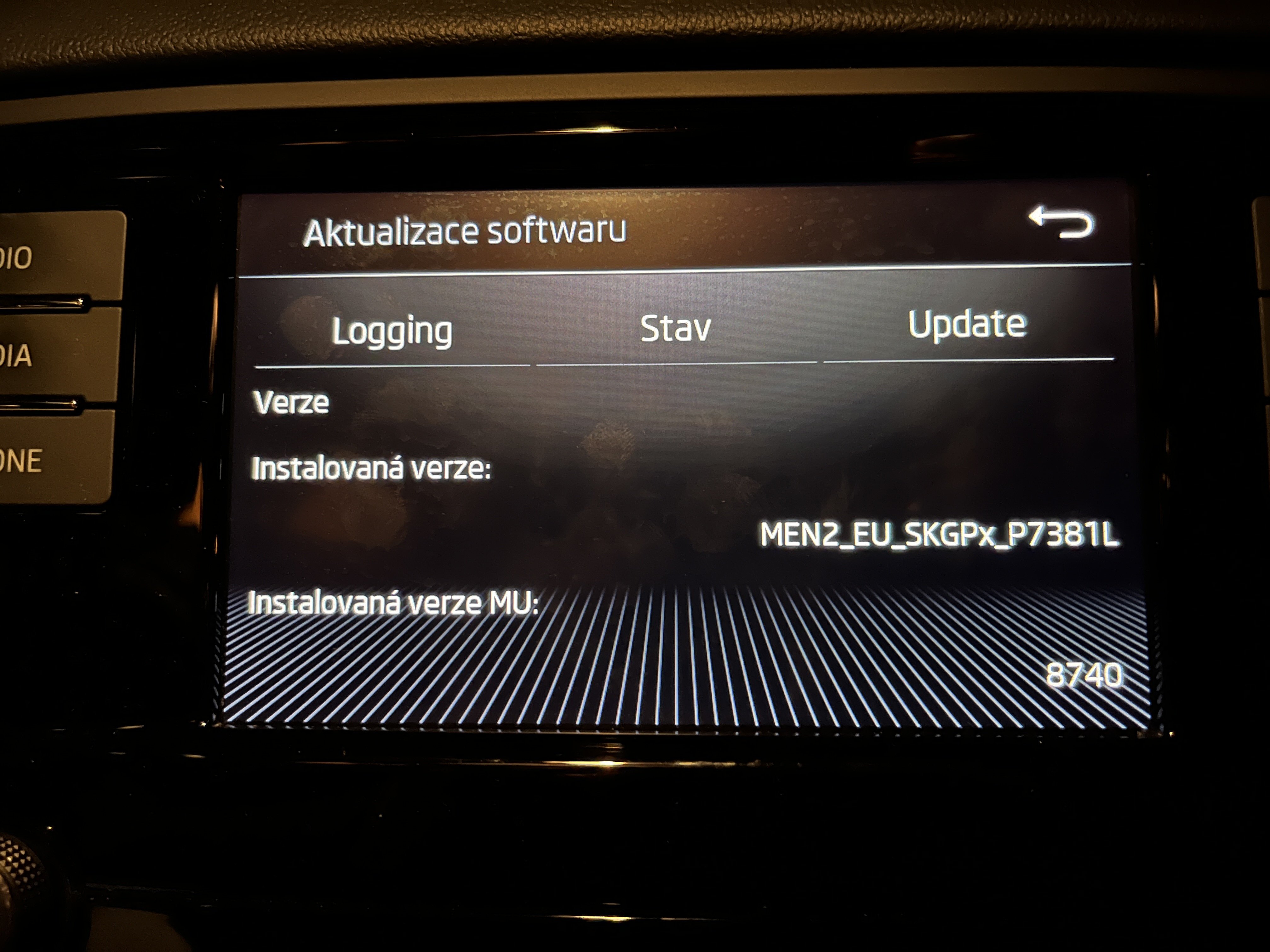

Hi everyone,
I bought a Fabia from 2020 and ist seems the firmware is very old and was never updated, photo attached.
Could anybody help with a link to the current firmware?
Thanks in advance,
Diemo

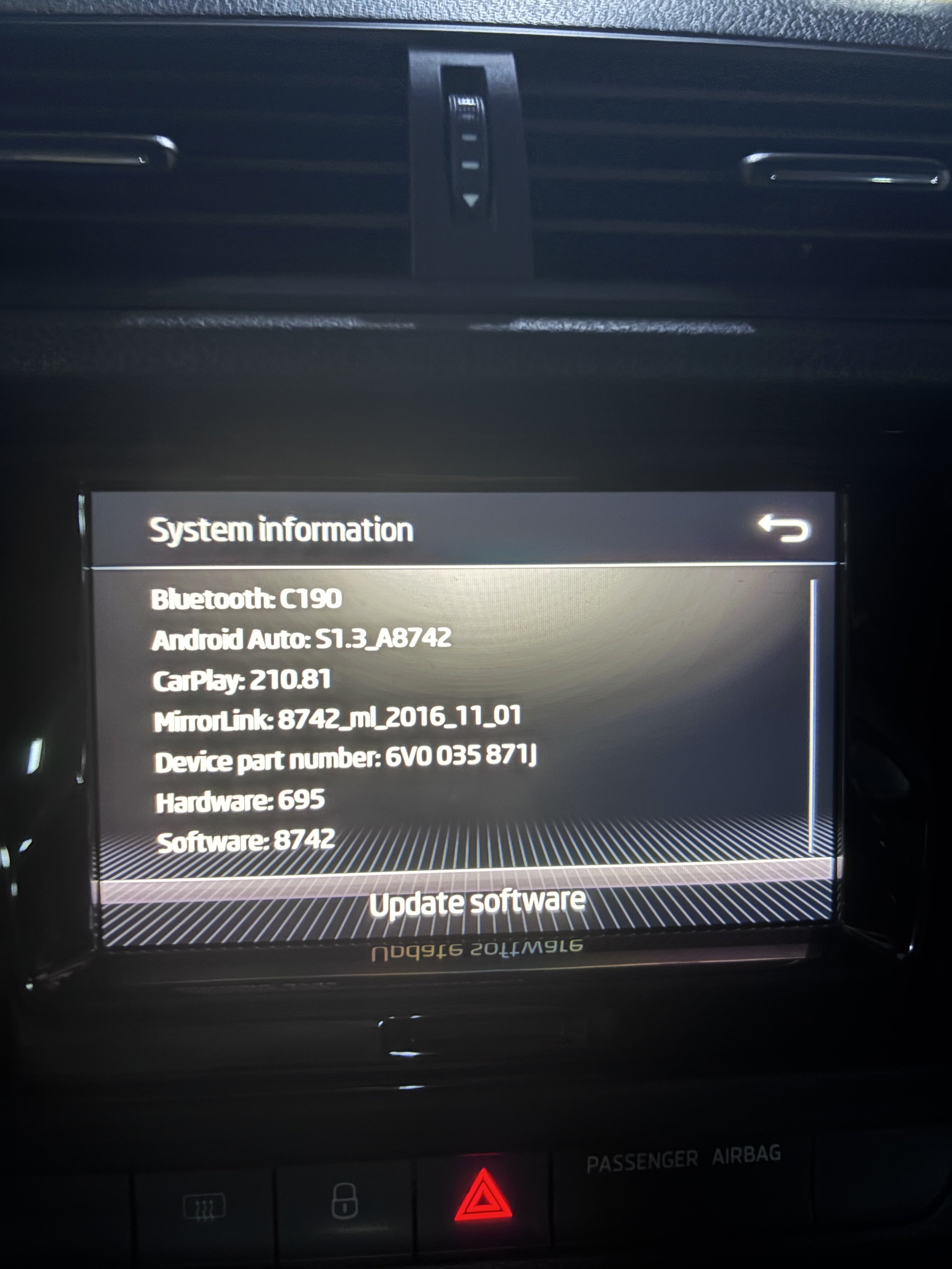

Hello,
I'd also like the update for my Skoda Fabia. I'm currently on version 8742 and I'm looking for version 8755. Thanks in advance.

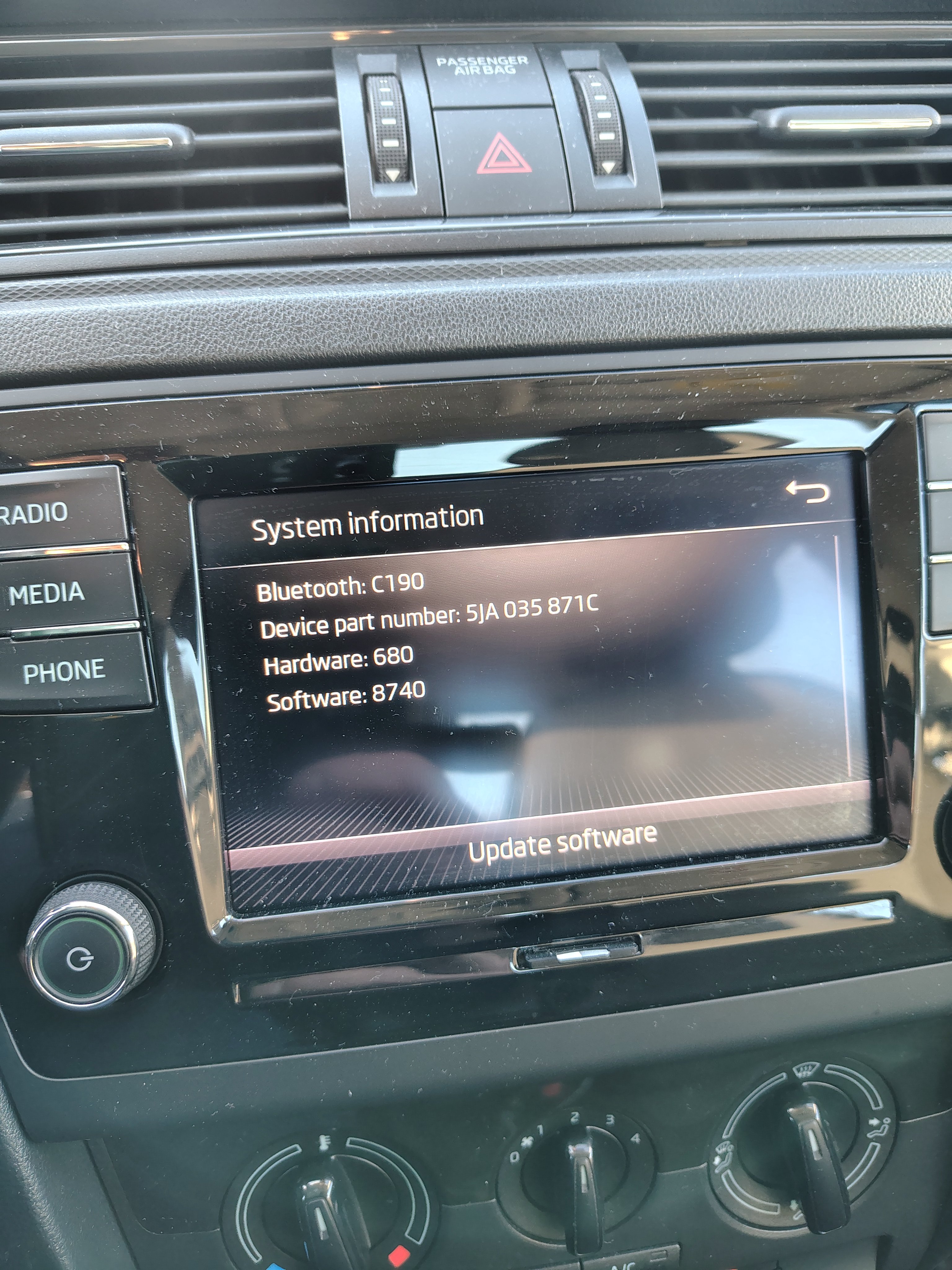

Hi, is it possible to get a download of MU 8755 also? Struggling with crackling on my system

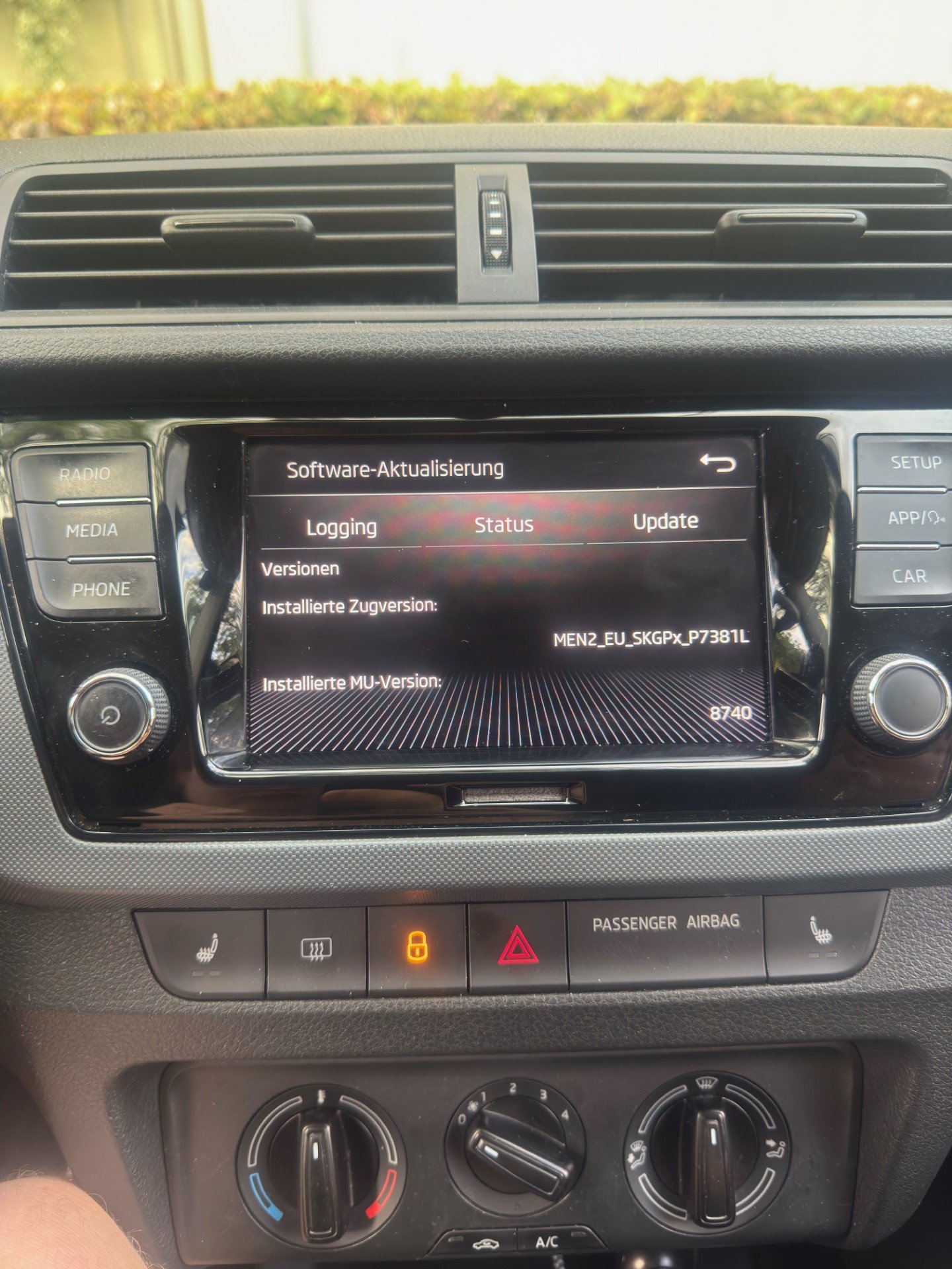

Hello, I have firmware version
MEN2_EU_SKGPx_P6473L
MU 8170
in Swing radio in Skoda Kodiaq 2017
I also have problems with connecting Android auto by my Samsung Z Flip 6 with usb cable.
Is it possible to update radio to MU 8755 or some other version newer then mine? And could you please send me firmware package? Thank you for your time and best regards )
All check your PMs.

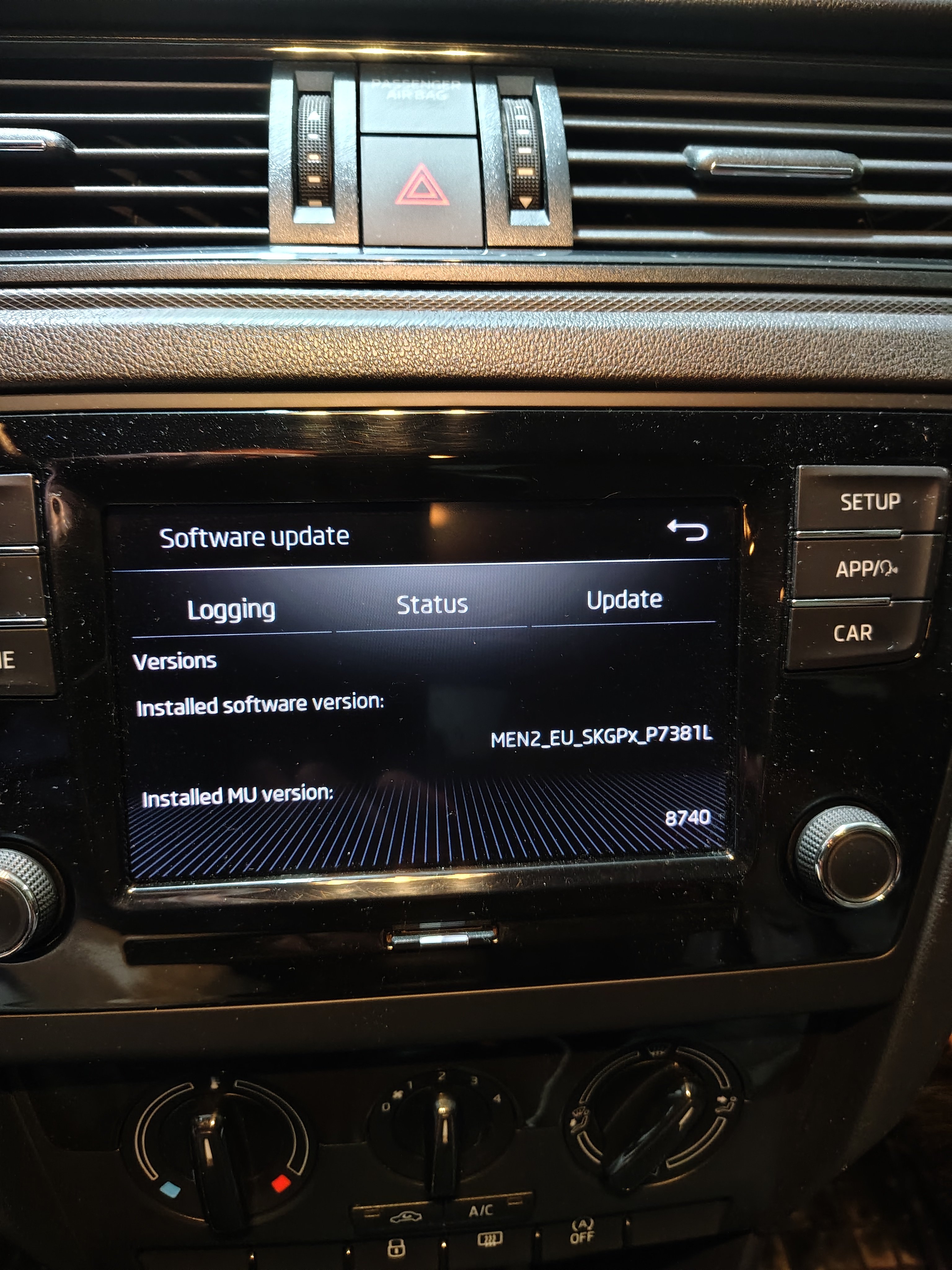

Hi @pab567 , I am a new member and cannot send PMs yet. Could you please help me with the SmartLink activation patch for my Delphi unit? Version: MEN2_EU_SKGPx_P7381L MU 8740. Thanks!

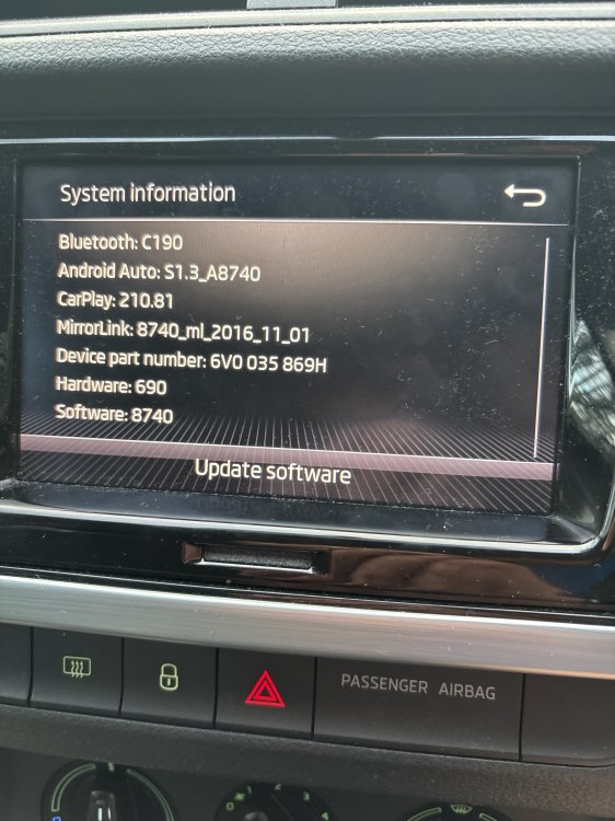

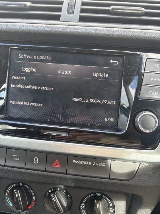

Hello everyone,
I hope you're all doing well.

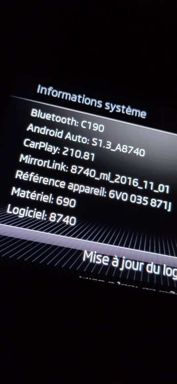

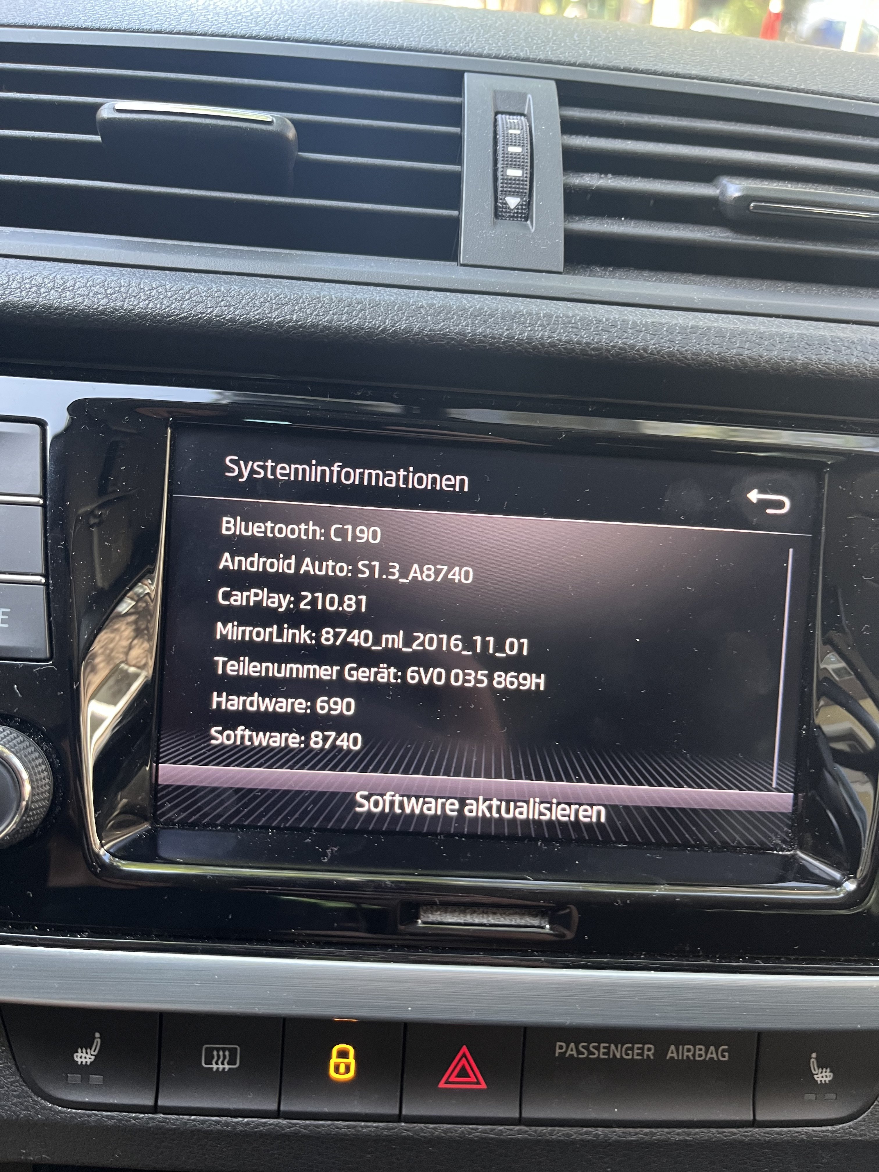

I own a 2019 Skoda Fabia 1.0 MPI and I am looking for some help regarding the infotainment software on my car. I checked the Skoda Update Portal using my VIN, but unfortunately it reports that there are no updates available.
My infotainment unit details are:
  • Vehicle: Skoda Fabia III (NJ), 2019, 1.0 MPI
  • VIN: TMBEA6NJ4KZ61****
  • Part Number: 6V0 035 869 H
  • Hardware Version: 690
  • Software Version (MU): 8740
  • Train Version: MEN2_EU_SKGPx_P7381L
  • Bluetooth: C190
I have seen discussions mentioning newer firmware versions such as 8755 and possibly newer train versions, so I was wondering if anyone could help me obtain the correct firmware package for my unit or point me in the right direction.
Another issue is that Apple CarPlay has never worked on my car since I bought it. I am not sure whether this is related to the firmware version, SmartLink activation, or something else. If anyone has experienced a similar issue or knows how to get CarPlay working on this specific unit, I would greatly appreciate your advice.
Thank you very much for your time and assistance. Any help, recommendations, firmware links, or guidance would be greatly appreciated.
Best regards,
Fabia owner from Romania
