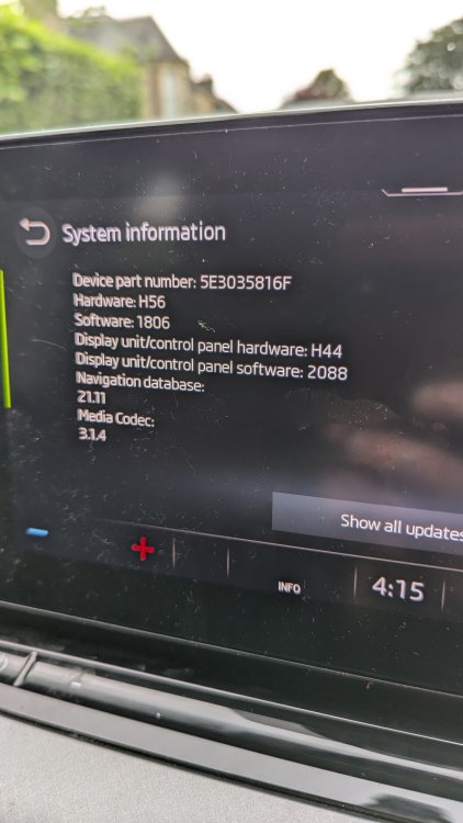

Infotainment switching on/off of its own accord. It doesn't matter if the car is switched on or off. Battery will likely drain very soon, this has happened to me just last week and the car needed jumping. Current system stats in the attached photo. Thank you.

/your first option should be to upgrade from version 1806 to 1941 or later.
