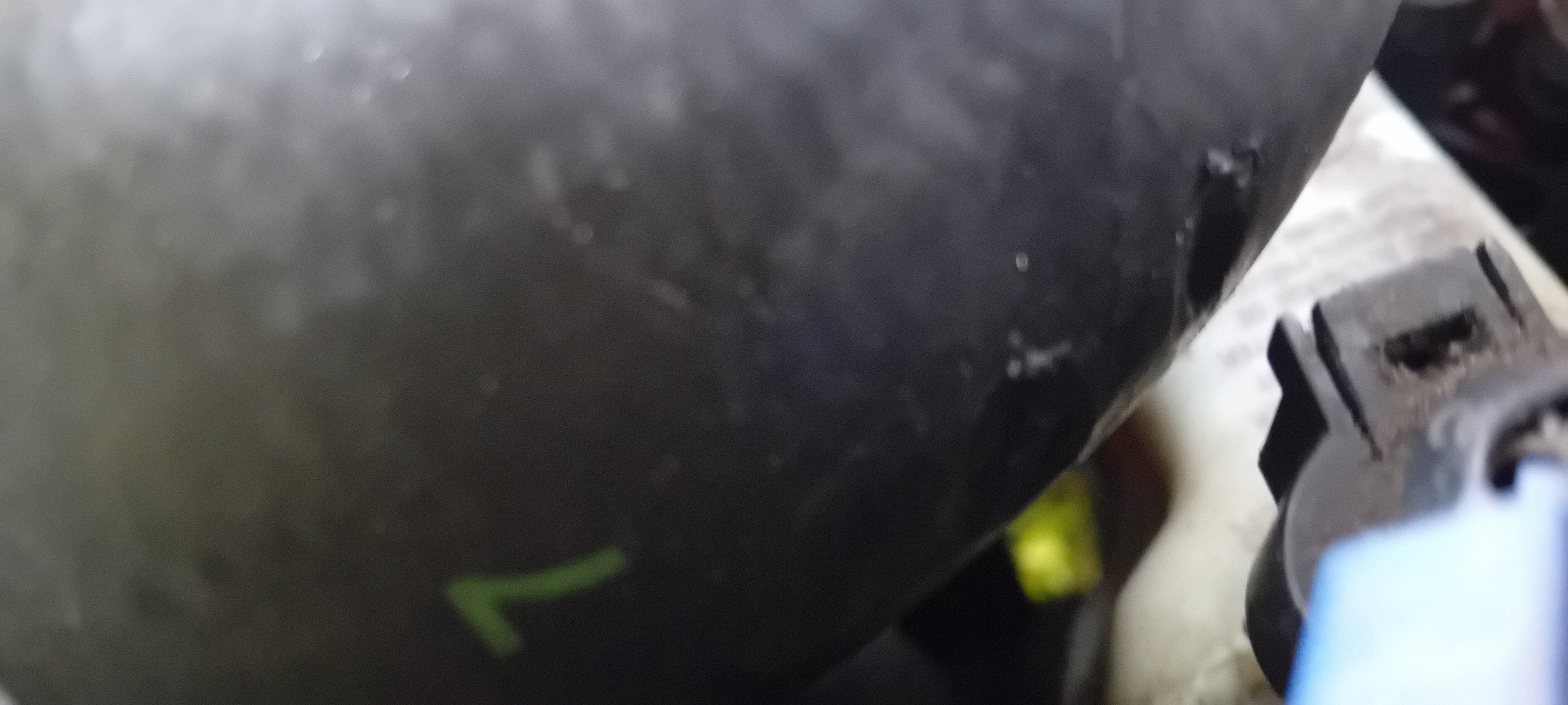

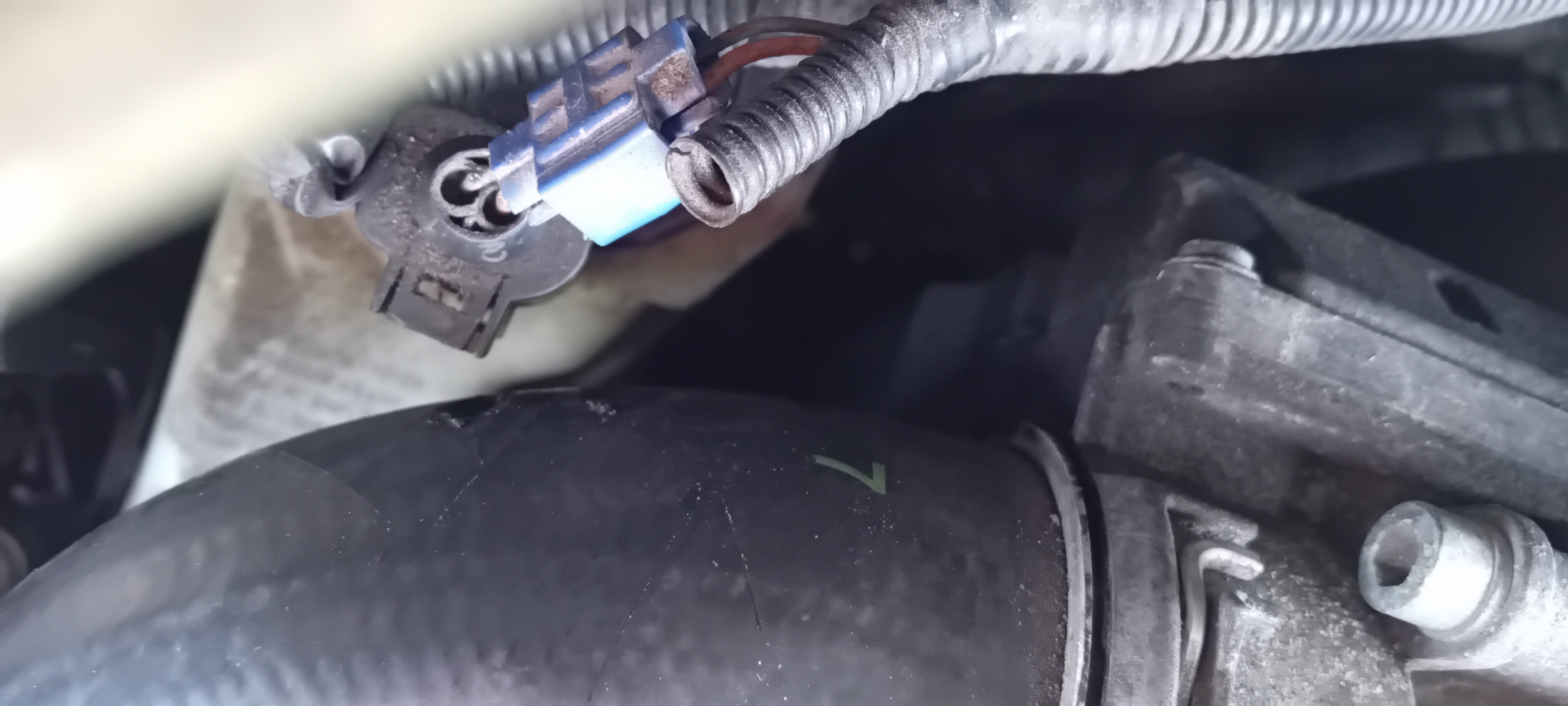

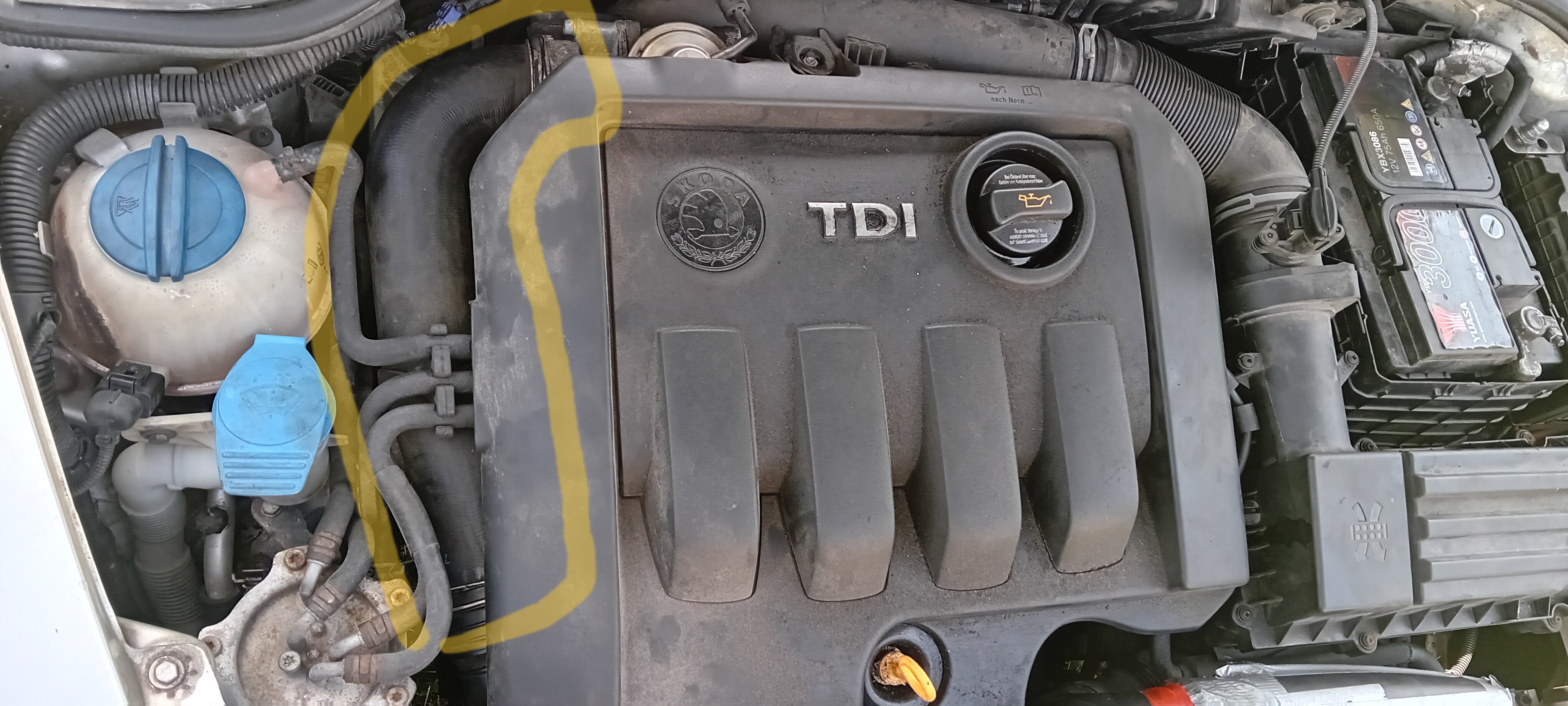

I have noticed the back of this pipe has been worn, possibly by the plastic wire clip about 1cm away from it (can't think what else it could be).  Pictures of pipe and damage attached.
Hasn't worn through, and I have patched it for now, but I have looked and tried the pinned thread but for the life of me can't find a part number for it.
Does anyone know the number so I can get a proper replacement?  (Unless people think a patch is sufficient!)

Ok engine code is BKC.   I think it might be the intercooler hose possibly.
Unfortunately someone has repaired the brake fluid low level warning wiring and it has damaged the hose. Try 1K0145838N

Well... for anyone interested, the hose seems to have been improperly replaced at some point.   The lower part (towards the front of the car) was coming loose as the metal ring had been put in backwards (so the metal teeth were not sitting in their grooves as they were pointing the wrong way) and was not securing the hose.
Ring in place properly now and the hose is tight and as there is no movement during driving, it has stopped rubbing the brake fluid wiring and is no longer wearing through (plus the small oil leak from the improperly fitted end has stopped).
