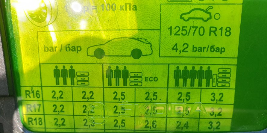

The green tyre pressure chart in the fuel filler cover has two columns each under Normal, Eco, and Fully Laden. It shows  2,2 bar in both under normal conditions, 2,5 in both for Eco running, but gives  2,5 and 3,2 under the loaded columns, the 2,5 under the image of 5 people, the 3,2 under the image of many sacks.
I can't decide if the pairs of columns refer to  front and back tyres or variations in loading.
If I'm towing our small caravan, ( max loaded weight 950kg, nose weight 75kg), should I go for 2,5 at the front and 3,2 rear, or 3,2 all round?
3,2 appears to convert to 46.4psi. I'm double-checking because our previous Volvo Estate wanted 38psi all round with the caravan on.

I've always understood the left column is front and the right is rear  as the orientation of the sketch of the car above.
I would suggest using the fully laden pressures should be selected.
Thanks - that seems logical to me, but it seemed best to check!

75kg nose weight is about 1 adult on their graphic.
