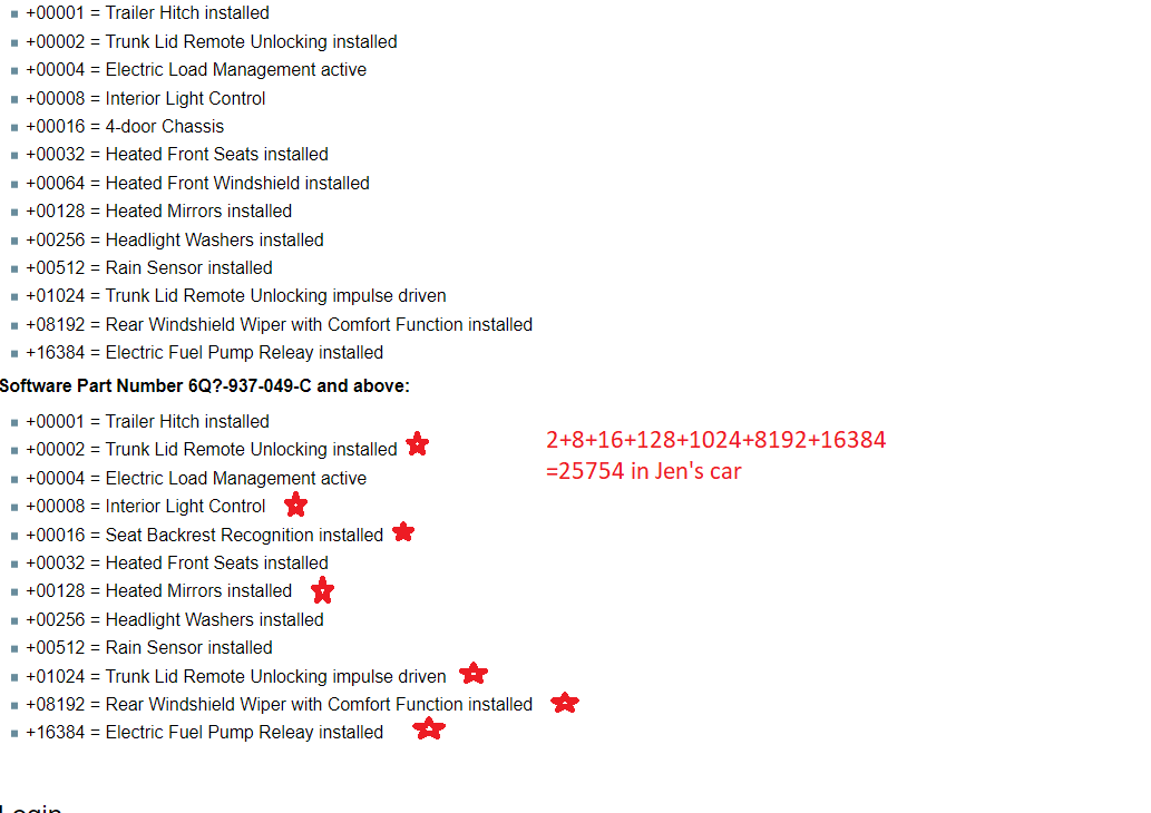

The coding structure for onboard supply control unit/ module 9 is as shown in this image.
The derivation of the code for my partner's 2005 car is shown in red. Pick the options that apply to your car, add them all up, and try that.

8 minutes ago, sepulchrave said:
What code are you using for the recode?
I've used the 16524 on 09 cent elect

  • Sponsor
None of the errors with E313, G85, or J492 seem to relate to any of the soft coding options in module 09, so I think these must relate to another control unit having its coding corrupted.
