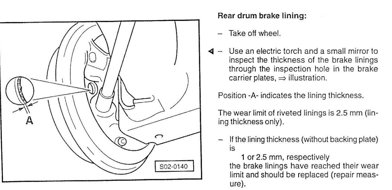

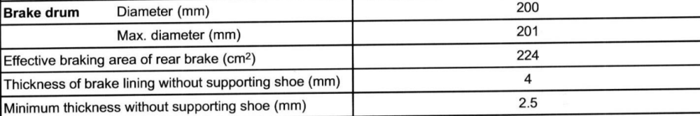

Felicia's mechanism is self-adjusting and works properly if clean and well lubed so you never mess with the adjustment (until you lock the drums and stuff), let the mechanism do its thing and be done with it.
The following info is useful if you so with to check the drum...

-What to consider if the brake drums might be worn and there are crap old car parts around.  Don't start a pile on.
Yeap that table answers R_U_AFA's question which I didn't know and couldn't find on a quick search so asked for, and you have provided it.
All's well that ends well.
