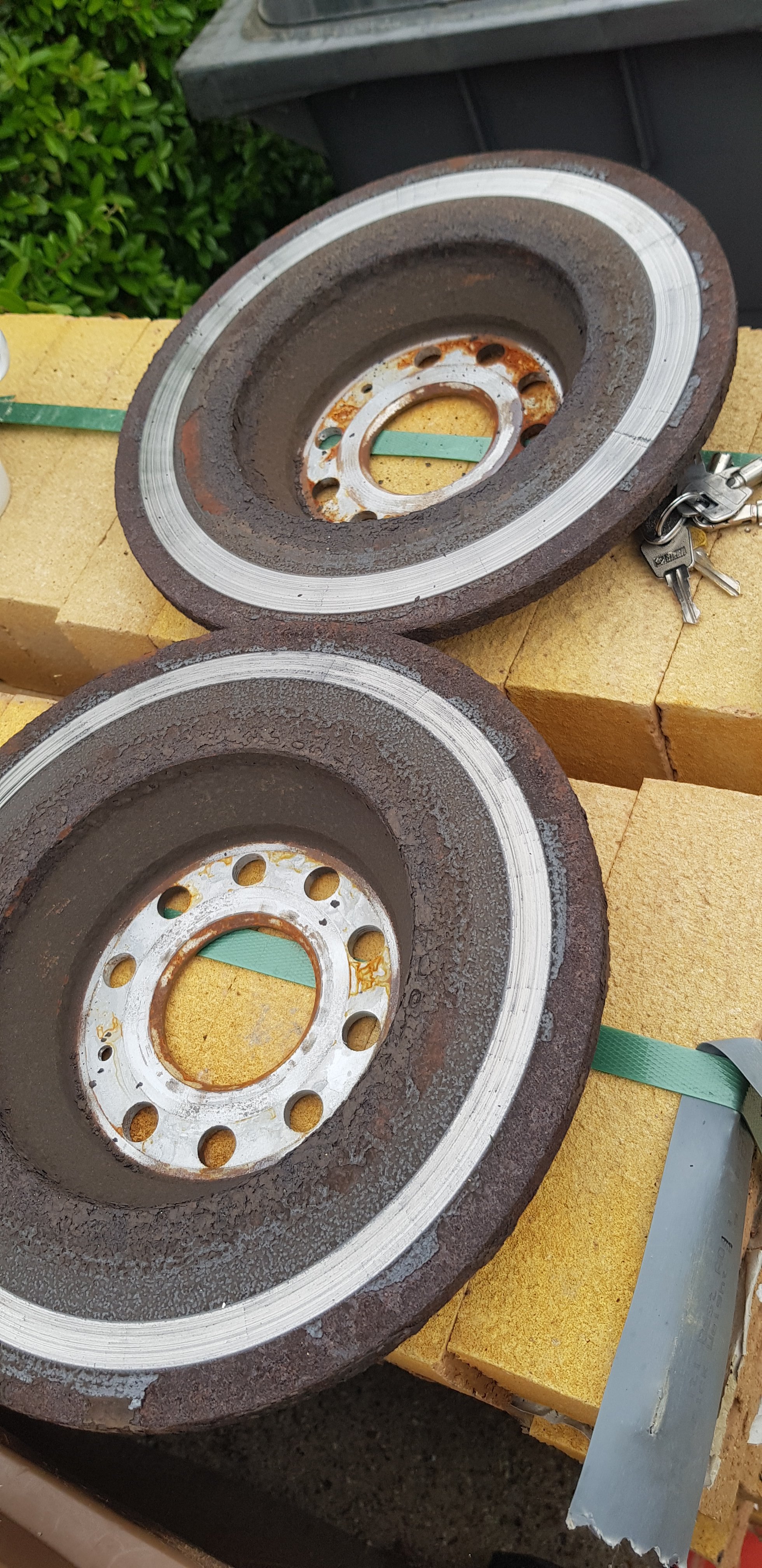

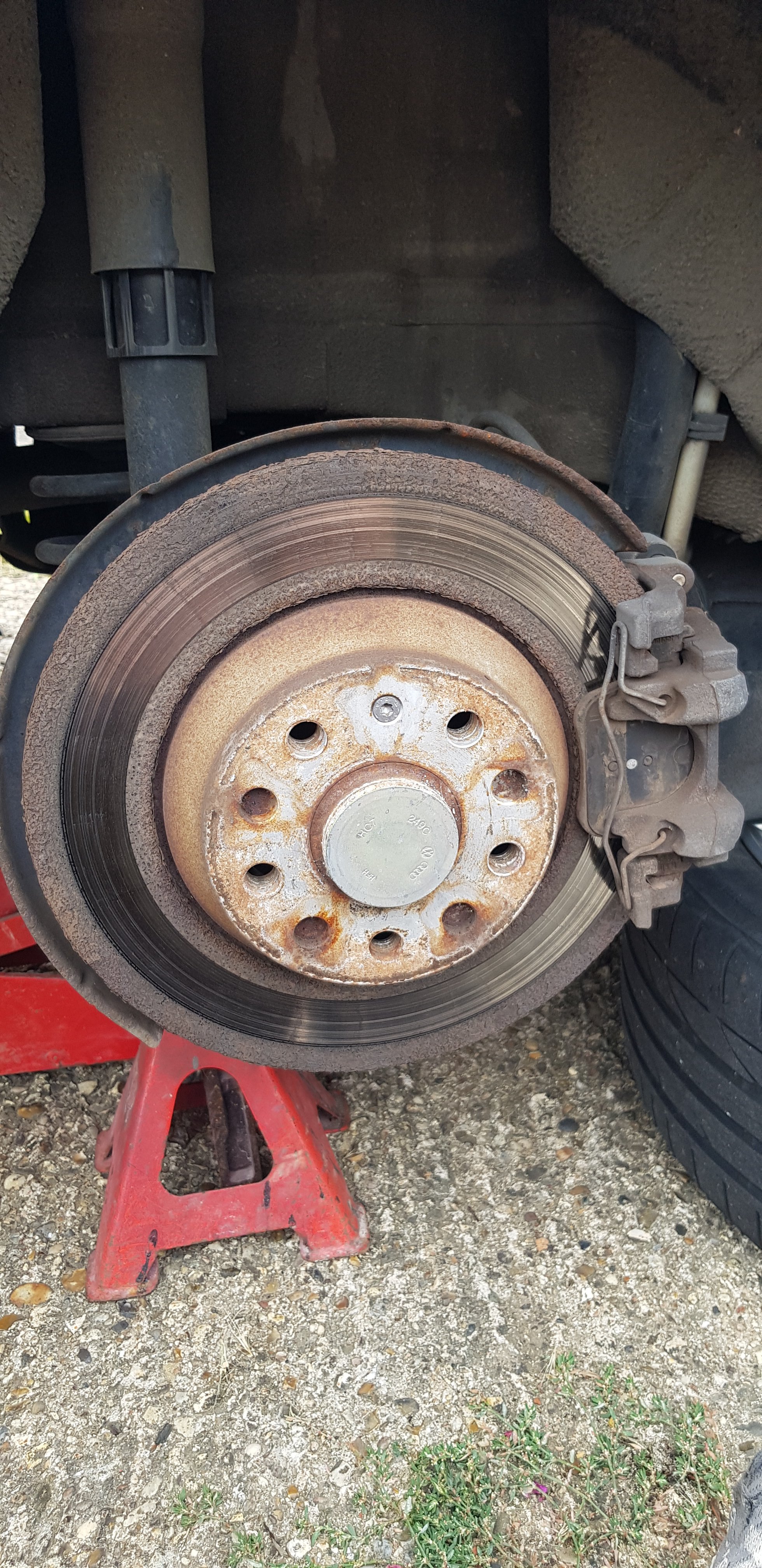

Pads are worn right down, but the discs are OK for thickness, just heavily corroded

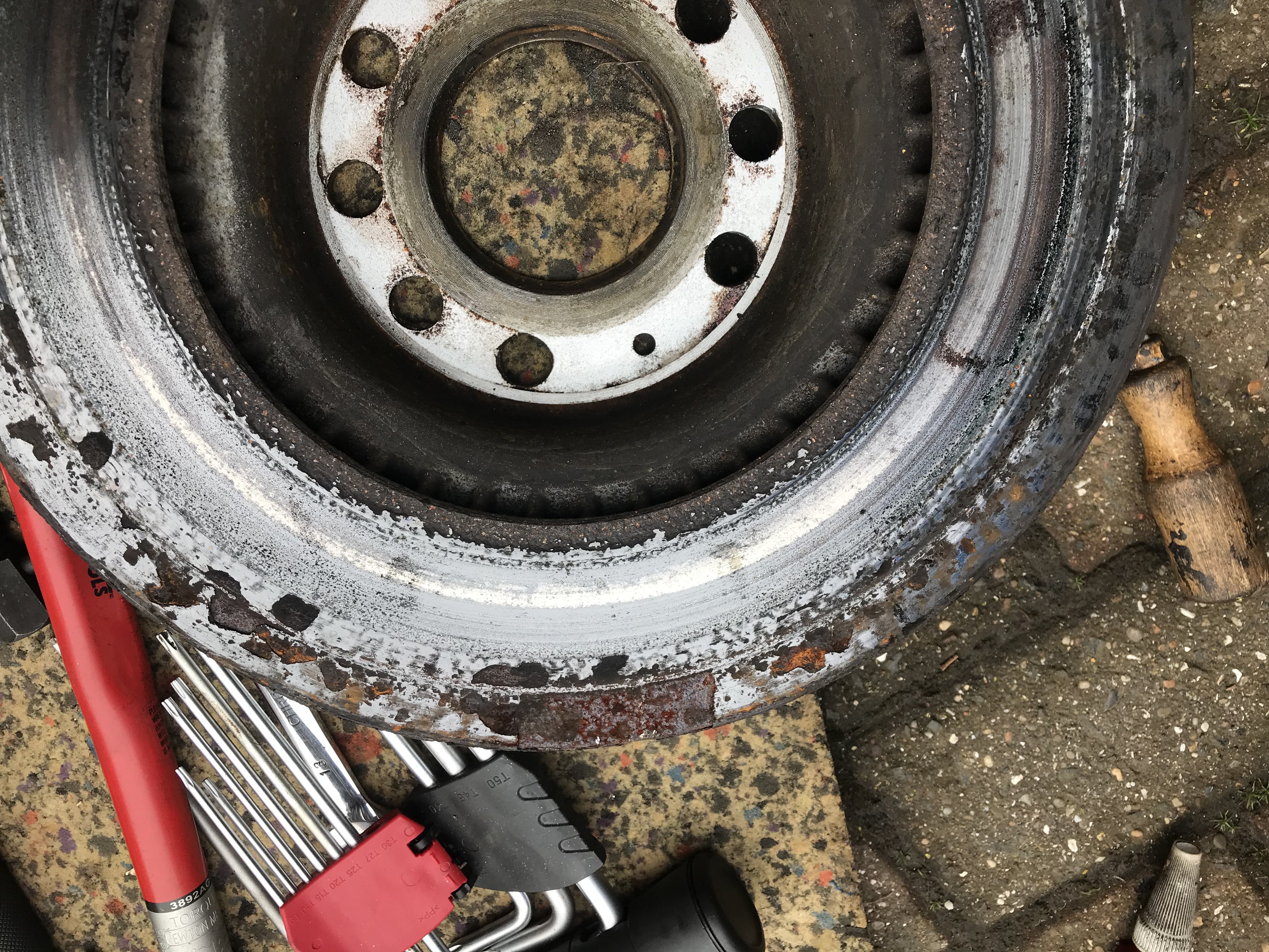

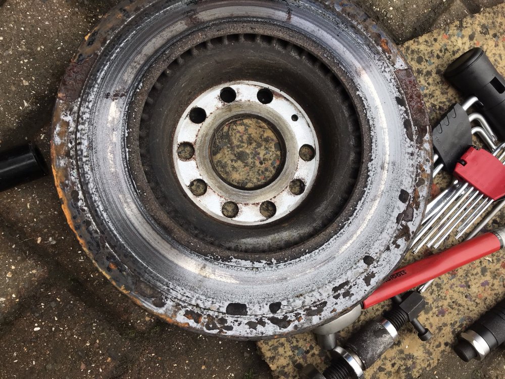

My rear discs were badly scored after 20k miles, they weren’t worn near limit but they had trashed the pads.  I replaced them with Delphi (which are quite cheap) and these lasted much better.
Cars done 49k miles. Hardly used in the last year but the disks look like they've been in the North Sea all that time.

Mine looked fine :o
Less than 22 k miles and 3 years old (= 3 winters) when replaced March 2023:
