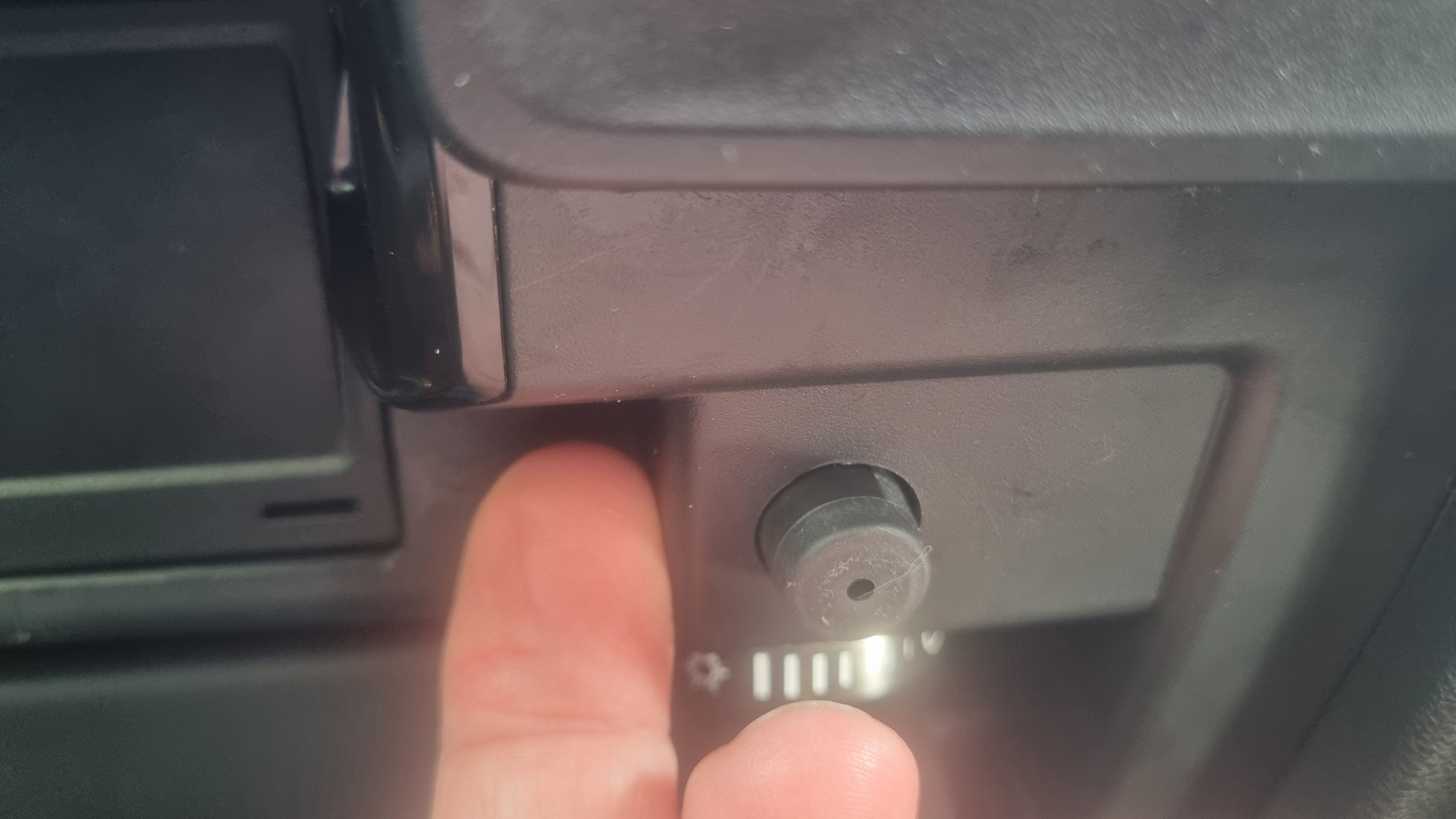

Hi. Thanks for reply. I am able to drop the box itself using the tabs. I've done that to access the fuses and filter. But it's the whole frame needs to be dropped, hence the removal of the seven screws. Dropping the compartment alone will not give me access to the radio head unit. There is a video of the whole box and frame dropping with these screws removed, but mine does not. My gut feeling is that there is a screw behind the push release button  of the glove box, which stays in place when the box is opened normally.

I will for sure. I believe there may be a final screw behind the push lever. I will go at it again tomorrow and report back with a picture.
So. It turns out there is an 8th screw just below the glove box release push button. Should wear my glasses more often. Just over my finger in the picture.

All good then…..👍
Thanks for taking the time to help out. Appreciated.
