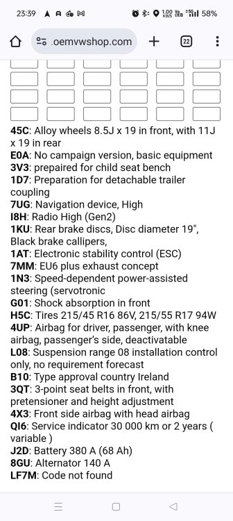

I have 1D7 preparation for towing trailer wich I presume is the same. The main difference is 3v0* vs 3v9* for estate. I presume there shouldn't be a difference as it is almost no difference between sedan and estates car base... However tried to contact a Skoda dealer and he said the same but at the same time he said then they should do 2 different model if the sedans and estates were the same... Unless it is just a marketing trick.. That's why I want to confirm maybe someone tried before the 3v9* (estate version) instead of 3v0* sedan/saloon version on a sedan/hatchback

Tried the pr decoder and doesn't recognise AHV or code you mentioned.. Unless it is a typo
Sorry, my bad - I was meant to write "1D7".
Looks like u have it, which is good.
