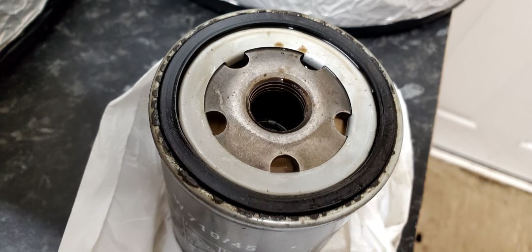

This is the old correct filter.

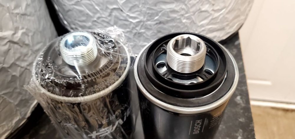

And this are the two wrong filters.
Can someone tell me why I keep getting the wrong oil filter when using the vehicle registration.

Don't bother doing this.
I've solved my problem.
It's not clear in the top image but in the orignal high resolution image that oil filter is a Mann W719/45.
The Mann W719/45 oil filter has a male fitting just like the top bottom two oil filters and as specified for a CDAA engine and even all generations of the 1.8tsi EA888 engine with a spin on oil filter. North America engines use a filter insert in a filter housing.
I am certain the male fitting has separated from the filter so now it appears the correct filter has a female fitting.

06J 115 403Q
£14.40 + VAT across a dealership parts counter.
Google images of that confirm that it includes the male threaded part. So yes, yours has left that part behind in the engine upon removal.
I have no experience of that particular filter but perhaps I could make a common sense observation....................
The male threaded protrusion has a hexagon inside suggesting to me that it can be removed for use on engines like yours which requires a female threaded filter or left in place for those requiring a male threaded one.
Another possibility is that the mating face on the engines filter housing has a male threaded "nipple" (plumbing term) which should remain in place but perhaps sometimes gets unscrewed and thrown away with the old filter so the manufacturer includes the part with the replacement filters.
Playing devils advocate if the above is correct I would have expected the nipple to have not been pre-fitted to the filter but I suspect packaging constraints dictated that it should be to prevent possible damage in transit.
Try seeing if your new filter will fit after removing the part.
I had not seen Petes post, mystery solved, do not try my suggestion, remove the old part first.
