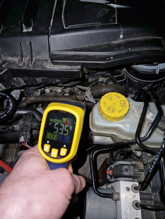

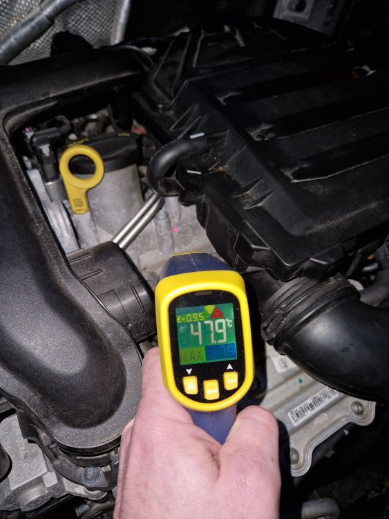

Did a quick temp check when I was about to pick the kids up from school. Was around 6⁰c out and the heater thermostat hadn't shut it off.
Temp gauge showed 55⁰c when I turned the car on, if one would assume it's linear scale
