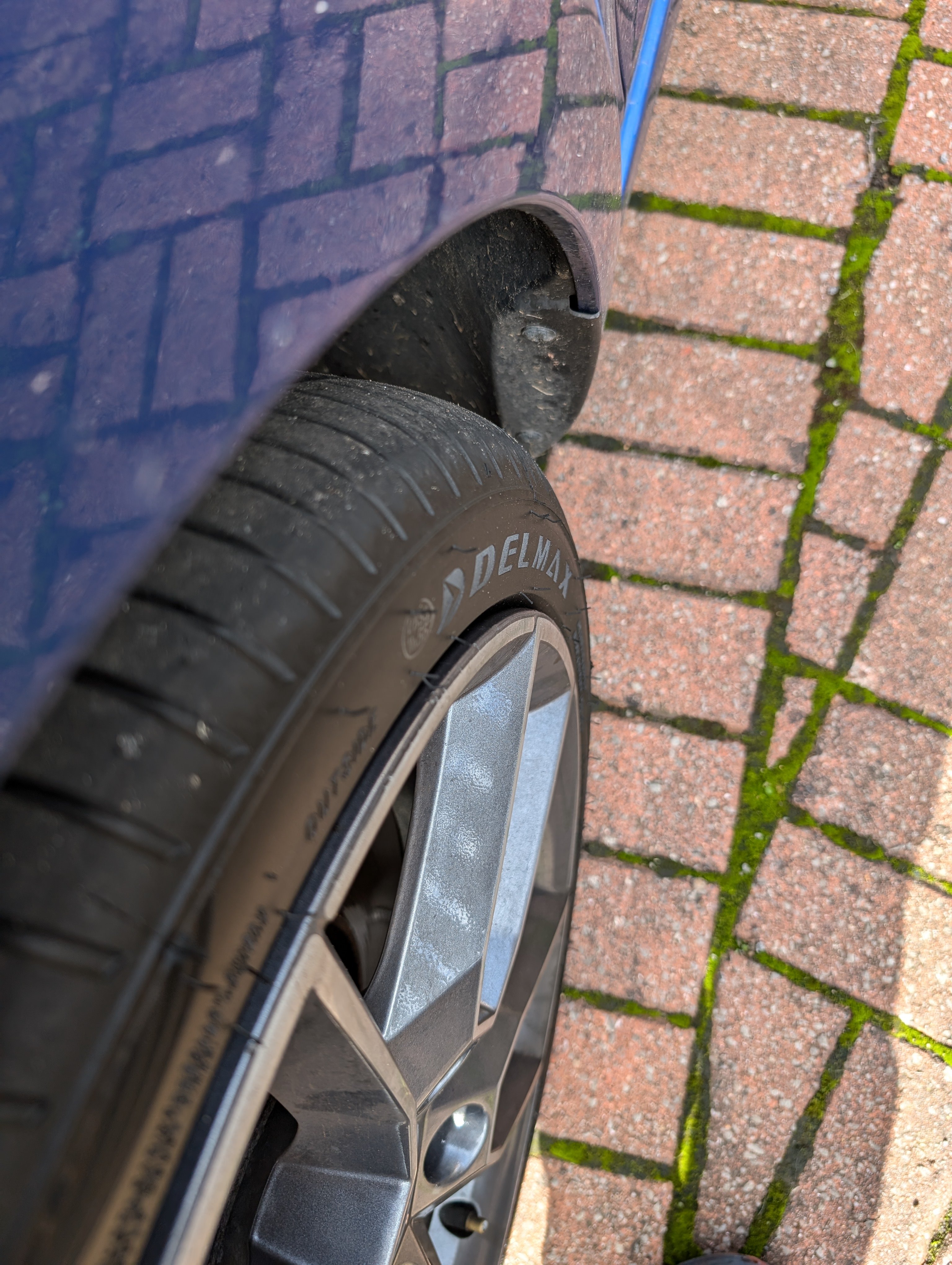

vRS 225/40 18 or 235/40 18?
Joy of joys, I've got myself back into a vRS after selling my MkII six and a half years ago. Loving it, but at present it has four odd (but tread-rich, at least) tyres that I'll want to swap at some point. Including one budget one, FFS.
My question is whether anyone still on here (it's a lot quieter than it used to be) has any experience of swapping the standard 225/40 tyres for 235/40s, purely for a bit of extra rim protection. Is it worth the extra cost? Does it actually protect the rim or not? Pic shows the 225.
Can’t comment on the 235s however I’ve just replaced a worn pair of 225/40 Michelin PS5s with Goodyear Eagle F1 Asym 6s (currently £35 off for 2 and £70 for 4 at ATS) and both have a thicker section of rubber that runs around the circumference of the alloy to give some extra protection. I think most premium brands do.
Never had any issues running the standard tyre size with the 18” Gemini alloy other than when the wife took the car out for the first time and properly had a go at curbing it! I don’t think any amount of protection would have helped in that scenario.
Wives, eh? Thanks for the response, I'll maybe risk the standard size in that case. Halfords have a very tempting deal on Premium Contact 7s (just over £100 a corner), or otherwise something on an ATS deal.
My Assy 6s did an excellent job of protecting my wheels from an errant kerb yesterday. Was expecting the worst but there's just a black rubber mark on the rim.
+protection -looks
I'm running Goodyear Eagle F1 Asymmetric 6s on the front of mine. They have much better rim protection than the Yokohamas that are on the rear (and were on the car when I got it). When ATS have an offer on I've found their prices very competitive - I think I paid about £170 for the pair of Goodyears fitted.
There wouldn't be a huge amount extra sidewall by switching to 235/40s. I haven't looked at the price difference. I'm intending to stick with 225/40s all round on mine.
