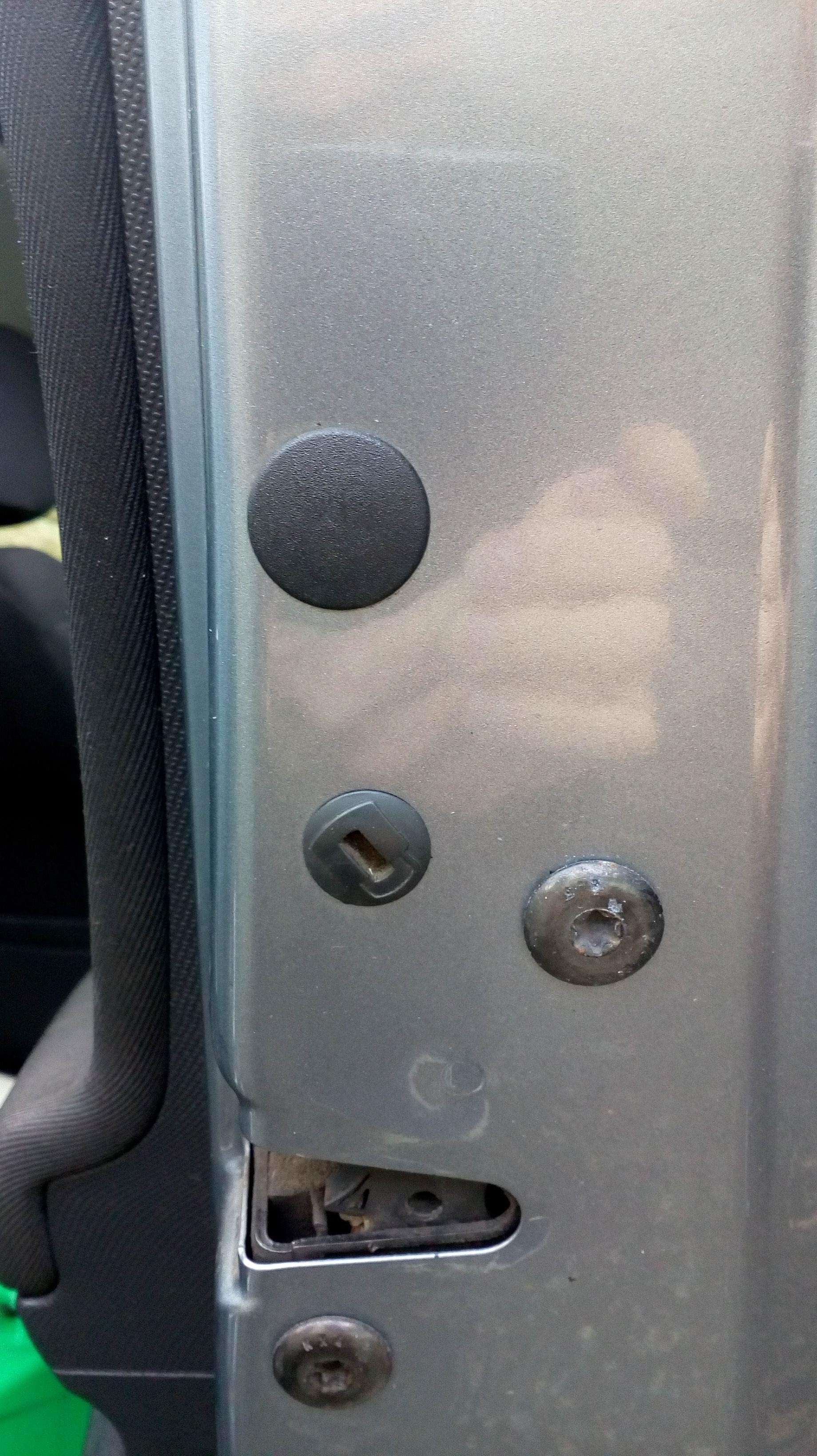

Here it is;
Remove the 2nd from the top plastic cap, insert key in slot and turn quarter turn, anticlockwise I think it was. Door was then locked from the outside as @rum4mo says.

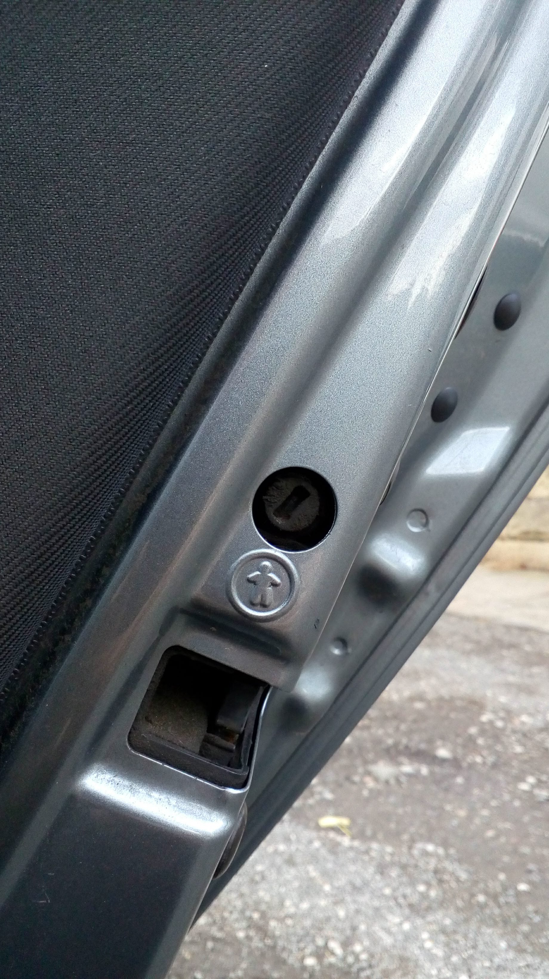

Not to be confused with the child lock;

What's the top (larger) bung for?
I think that is where the retaining screw for the lock barrel is located.
