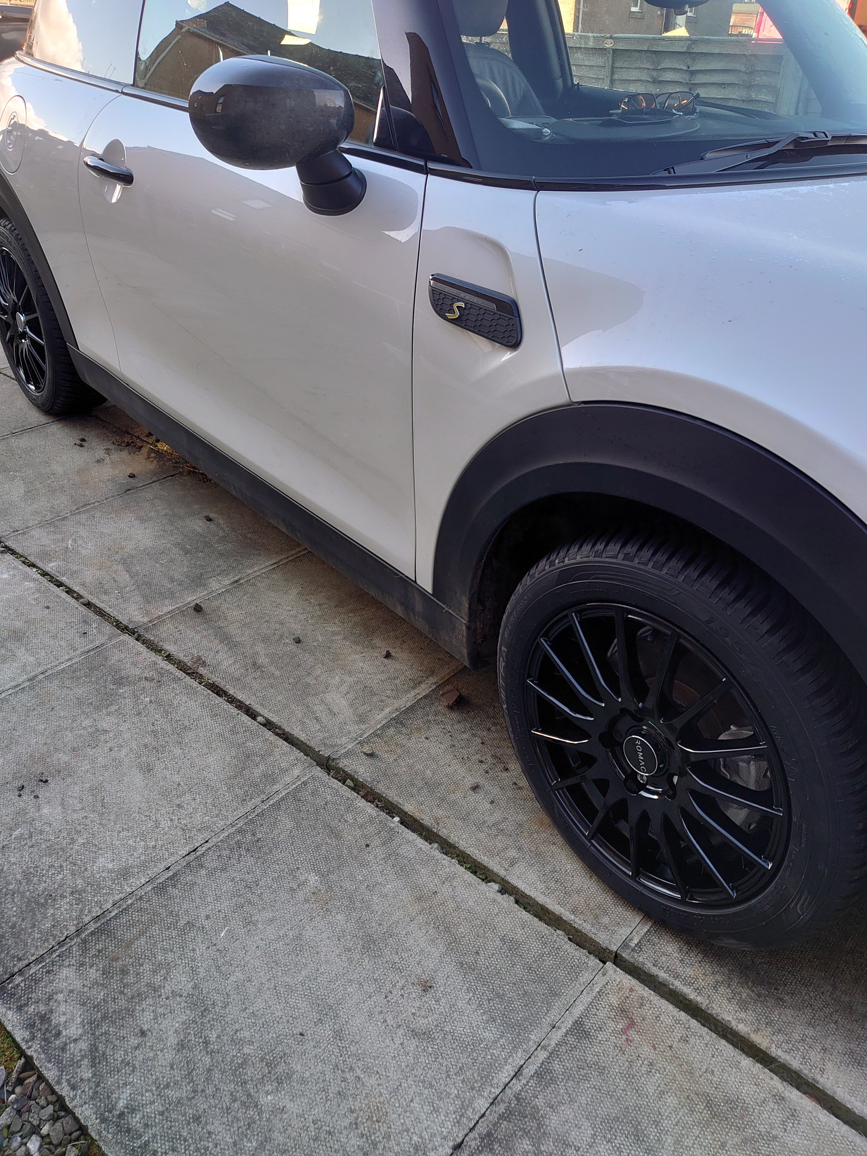

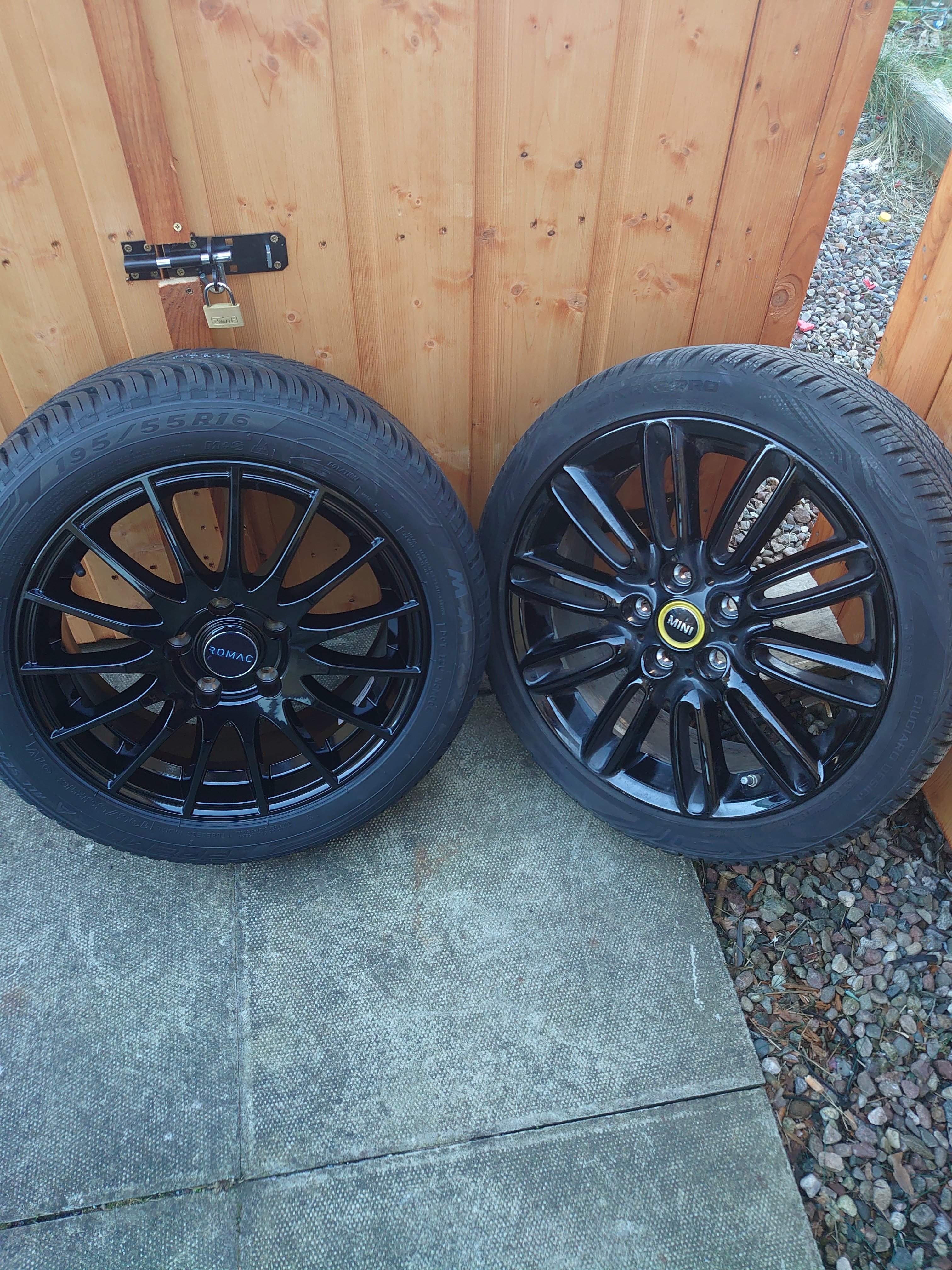

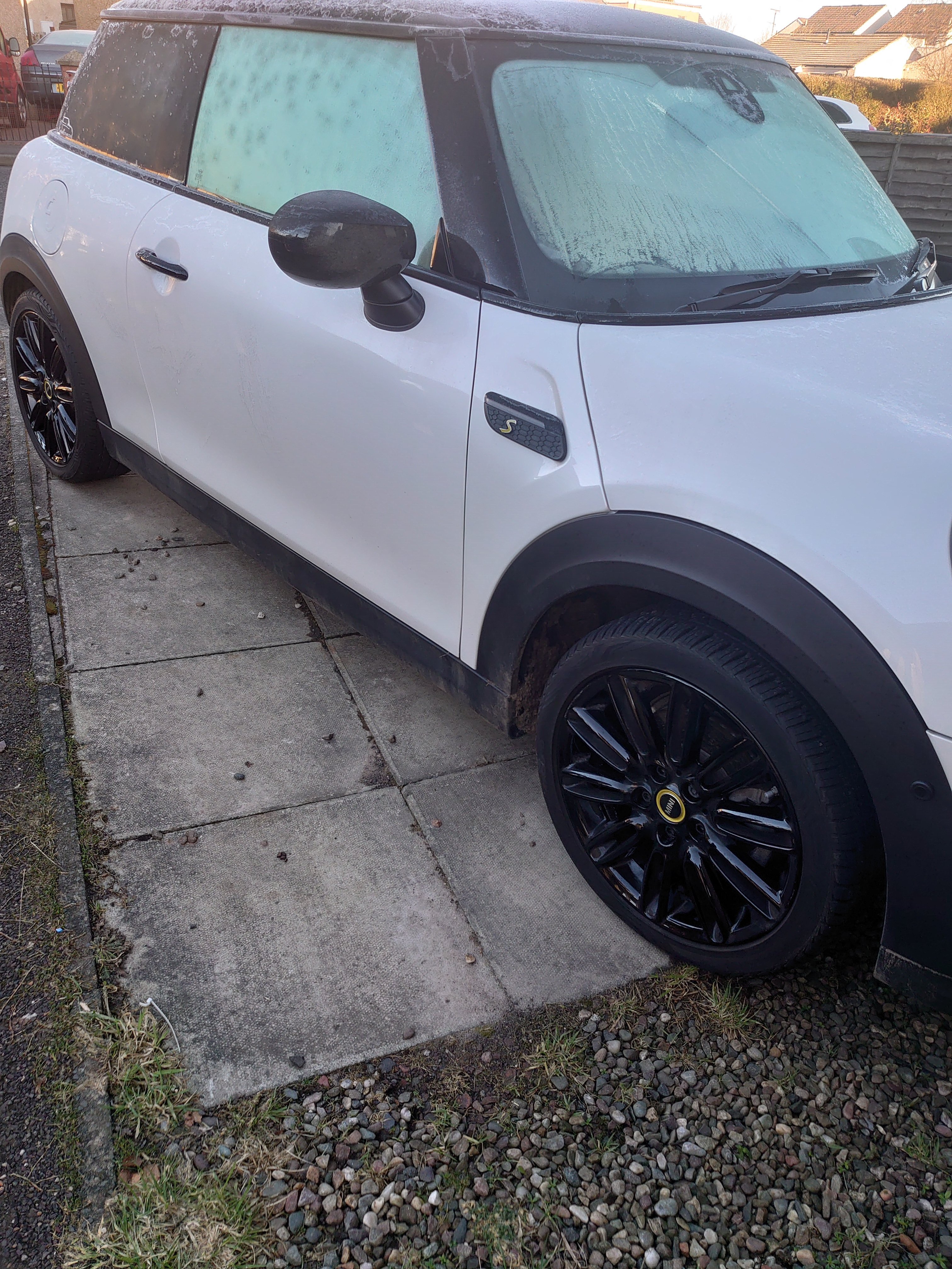

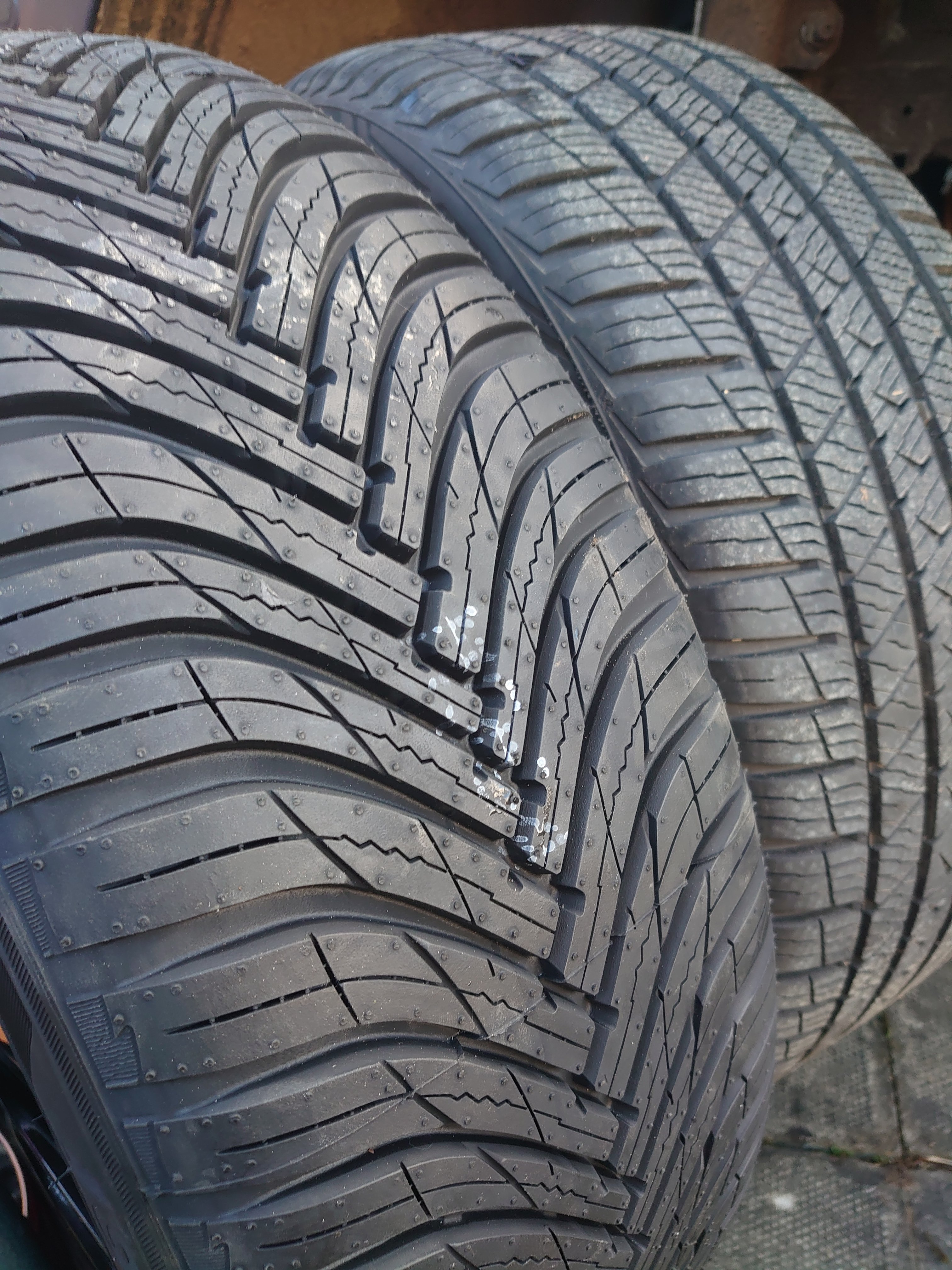

I have 16" & 17" Alloys with different All Seasons fitted.
Ones for the Summer & ones for Winter and when there might be snow.
