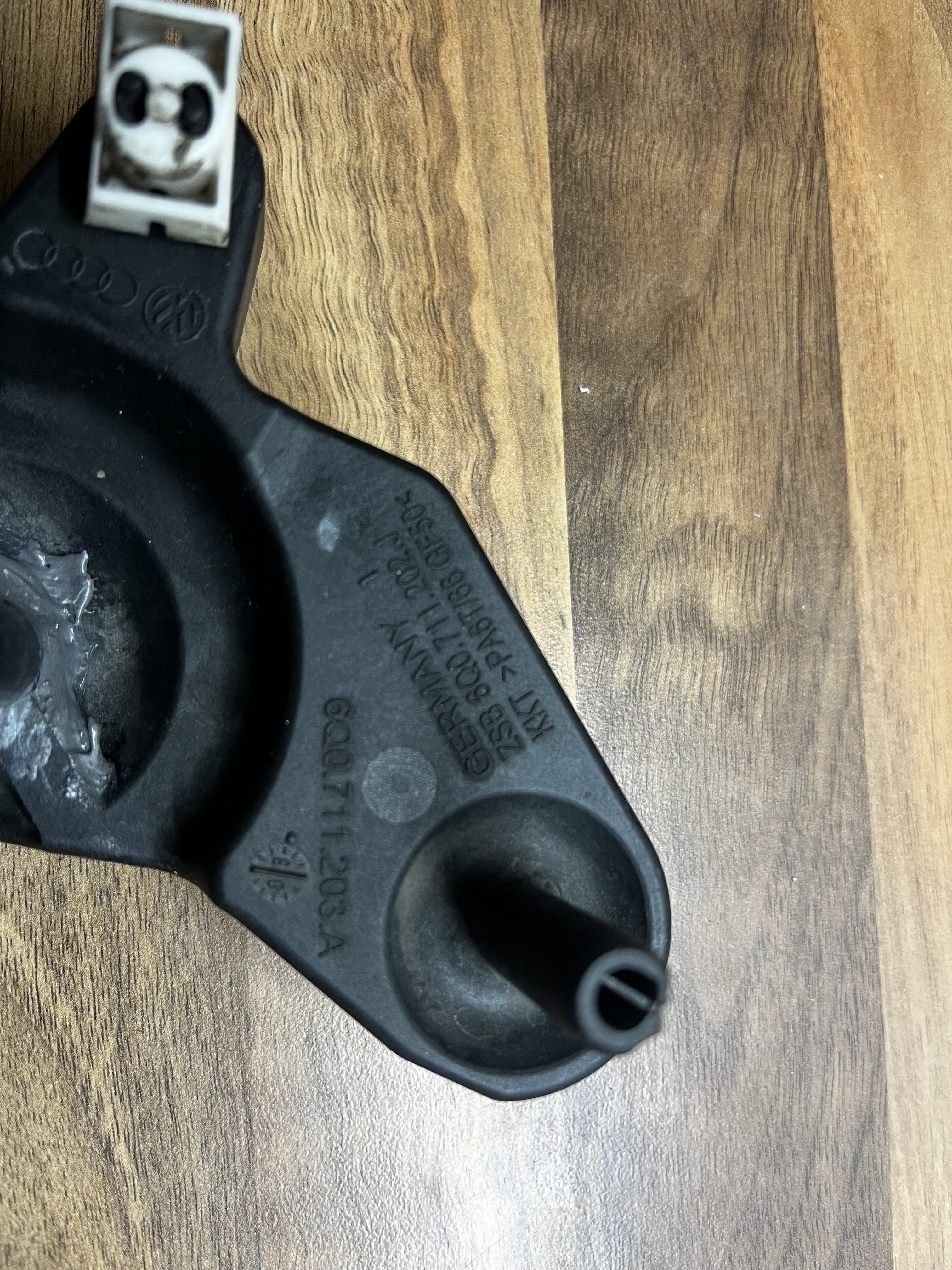

but this also is too short to reach the vertical actuator

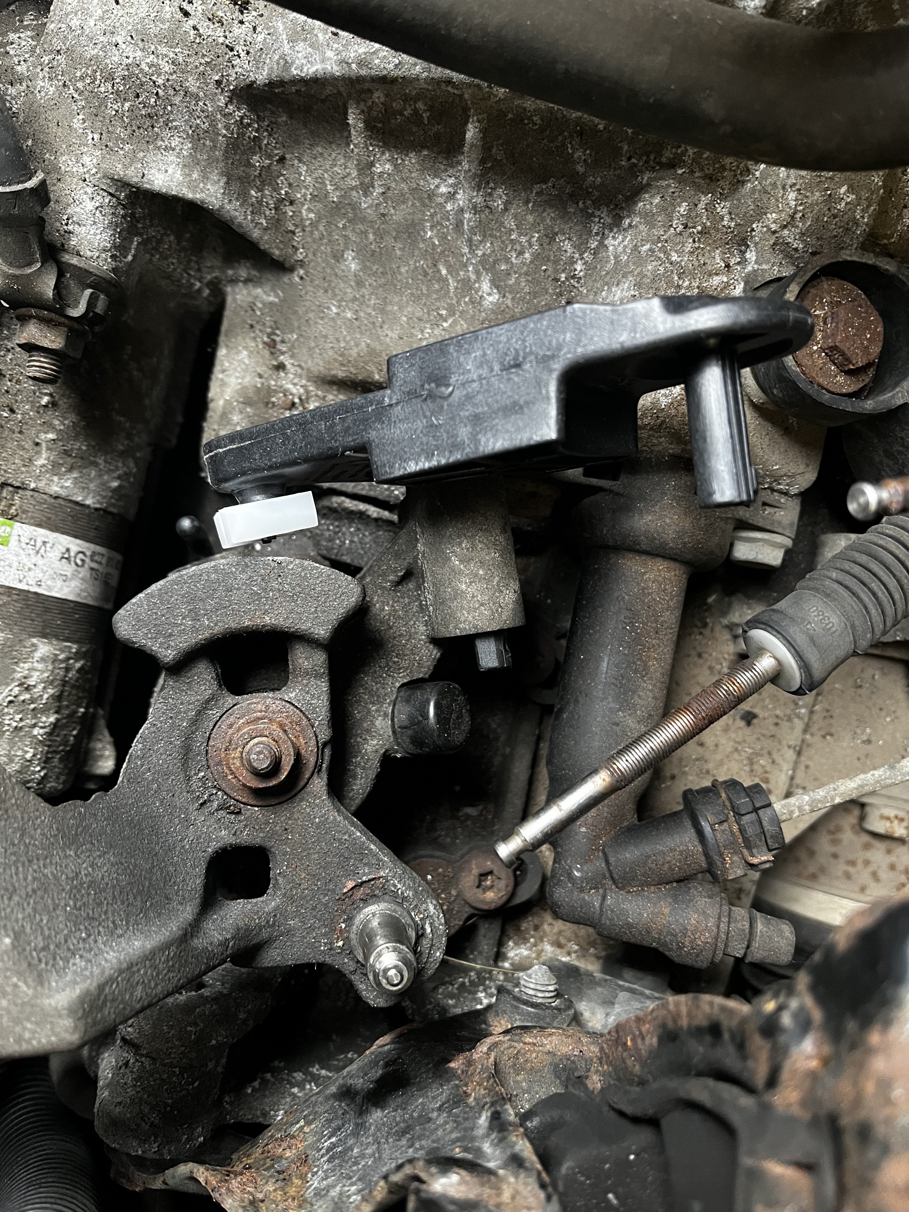

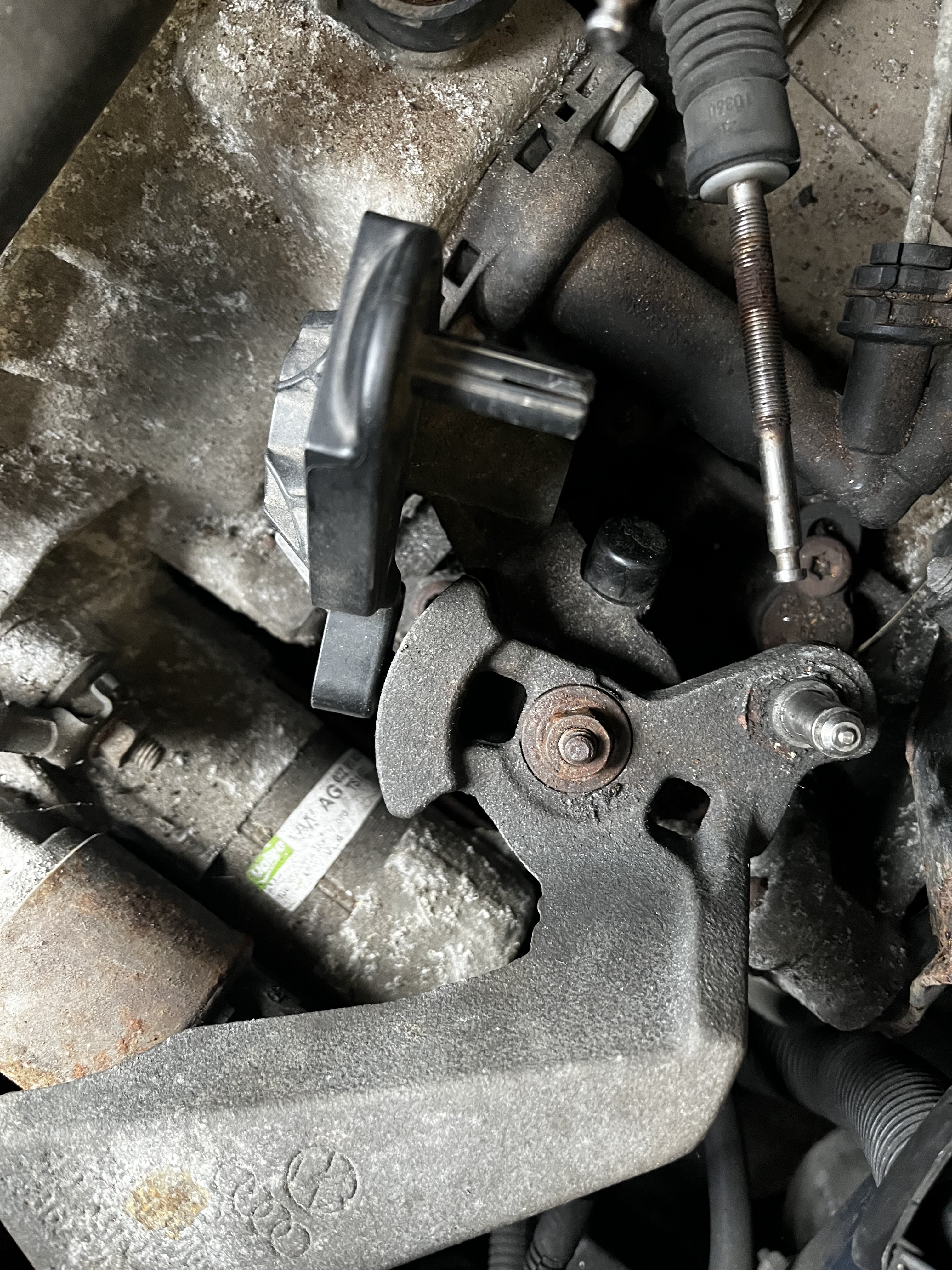

However, this revised part number is the wrong shape for the whiteplastic vertical actuator on thegearbox selector, to reach the curved metal groove as the one that was removed from the vehicle did? See picture attached.
The 1st pic shows the replacement part, the 2nd shows the old part, where the white part is not visible, as it correctly reaches the actuator.
Has anybody else had this problem when replacing this part, if you have, how did you get around it, or have I indeed been supplied with the wrong part from my local Skoda dealer?
