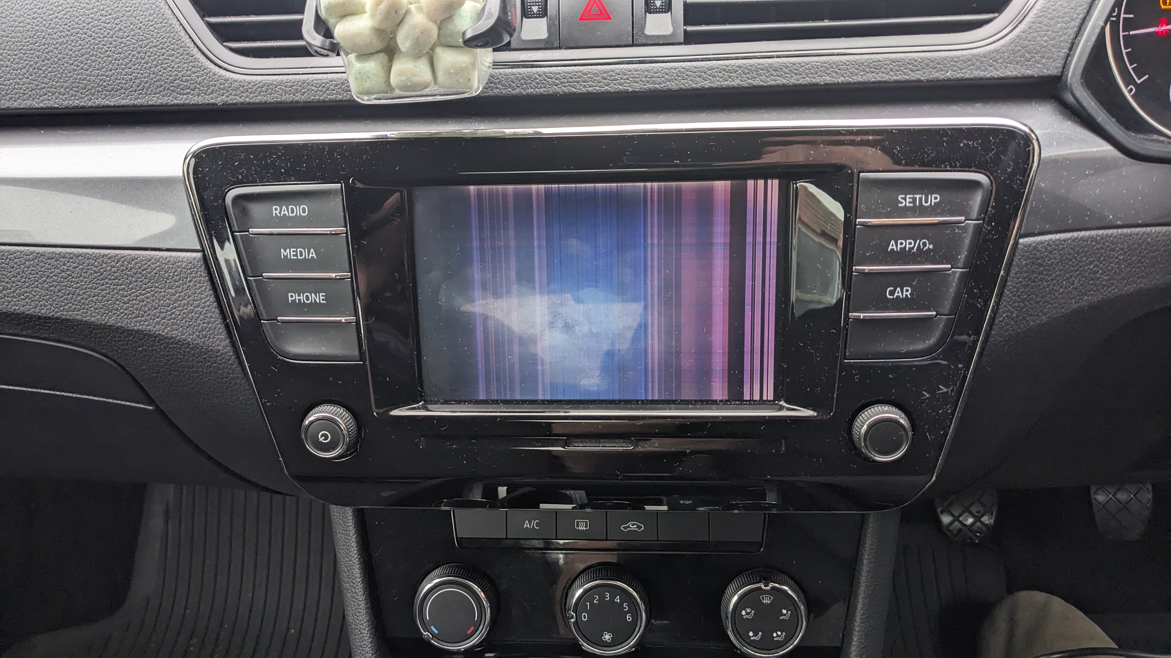

Hi. As per the attached screenshot (🙂)  my infotainment system screen has become corrupted and just shows a pattern of vertical lines whether it is on or off.
The only option Euroskoda Worthing can offer is the replacement of the whole system at a cost of just under £2k. However, I believe that the system itself is still functional and it is just the screen (or connections to the screen) that is faulty.
I wanted to ask this community what you recommend I do? Is there an option that is less than £2k? Your help much appreciated.

I think it's quite an uncommon headunit unfortunately, looks like 3V0035869C to me...
As it's an all-in-one unit, a dealer will only be able to offer a complete replacement hence the price.
If it were me, I'd be tempted to open it up and replace the LCD. You might be able to find a part number sticker attached to the rear of the LCD and then try Aliexpress/eBay or find an identical used headunit to get the screen from.

Really helpful @langers2k, thank you.
Just to close this topic, I ended up going to SatNav Systems.
They were great.
Were able to replace just the screen and some attendant motherboard type thing which obviously worked out at a fraction of the cost of replacing the whole system.
