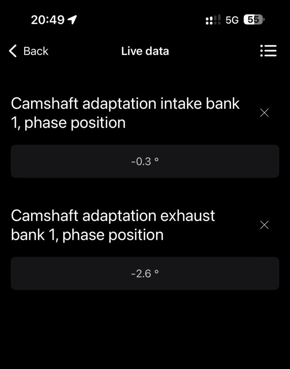

Hey gang, please see pic below. I have the CHHB 2.0 TSI Engine 2016 - 120k miles.
Just took an obdeleven scan at operating temperature after a drive, whilst idling, at the intake phase bank 1 just to look at the degree of adaptation (timing chain stretch) out of curiosity. No real reason. I get the initial chain rattle on a cold start for half a second but I'm assuming that's normal.( Was in my previous fabia tsi with timing chain!) or the tensioner is on its way out 😂
What do you make of it? Can it really be only 0.3 degrees at this age/mileage?
Or have the parameters changed and it's actually the exhaust now? Or faulty intake sensor?
I'm going to look at the inspection hole this week out of curiosity and see how far the tensioner is out anyway. But would be good to know I'm on the right parameter just to periodically look at it and keep track.
Some say the module that emits the readings changed from Bosch to some other brand in the Gen 3 EA888 and this reading isn't the correct one anymore. Any light to be shed by the great minds of BriSkoda?? Thanks 😁😁
