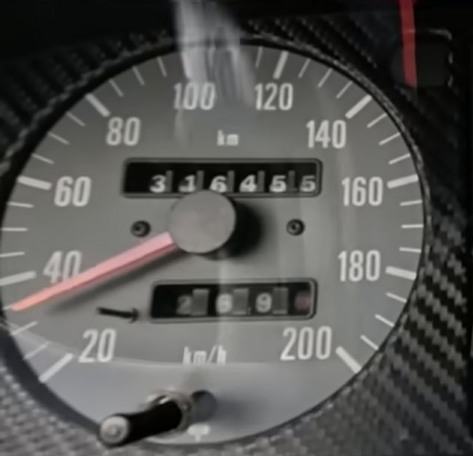

Take a look the indication, 316455 Km and still is running and adding more Km every month ! Imagine in the past how many times heard the ''why don't you sell it and buy a new car?'' from some idiots ''i know everything for every sector''.

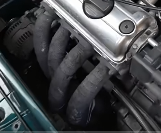

Hear wrapping on the headers

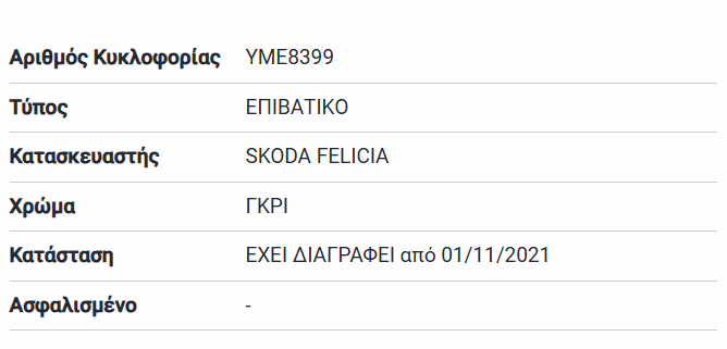

26 minutes ago, D.FYLAKTOS said:
Result: 133 Hp with 176N/m at 4,700rpm
For sure it was very reliable image.png.ff1e8045ecc7047e39023f29bd4ebf2e.png
Edited by Thefeliciahacker
Bought in 2000, heavy modified in 2010 and worked till 2021.
The guy is a rally man and has other cars to work with.
So where is the problem?
So it lasted 21 years when there are already 28 years felicias on the road
So if he had made the tuning in his car by your way
then it would last 50 years? :giggle:
Actually not!
That's why I don't advise it. Go big or go home as Americans say...
