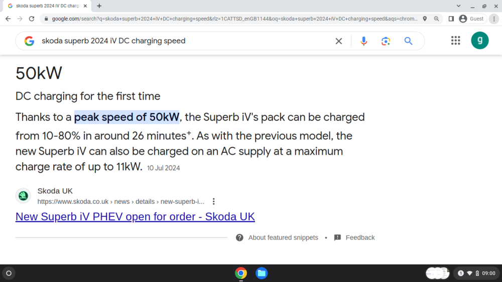

Peak Charging Speed 50 kW.
So using a charger giving more than 50 kW makes no difference.    Maybe avoid the higher powered ones.

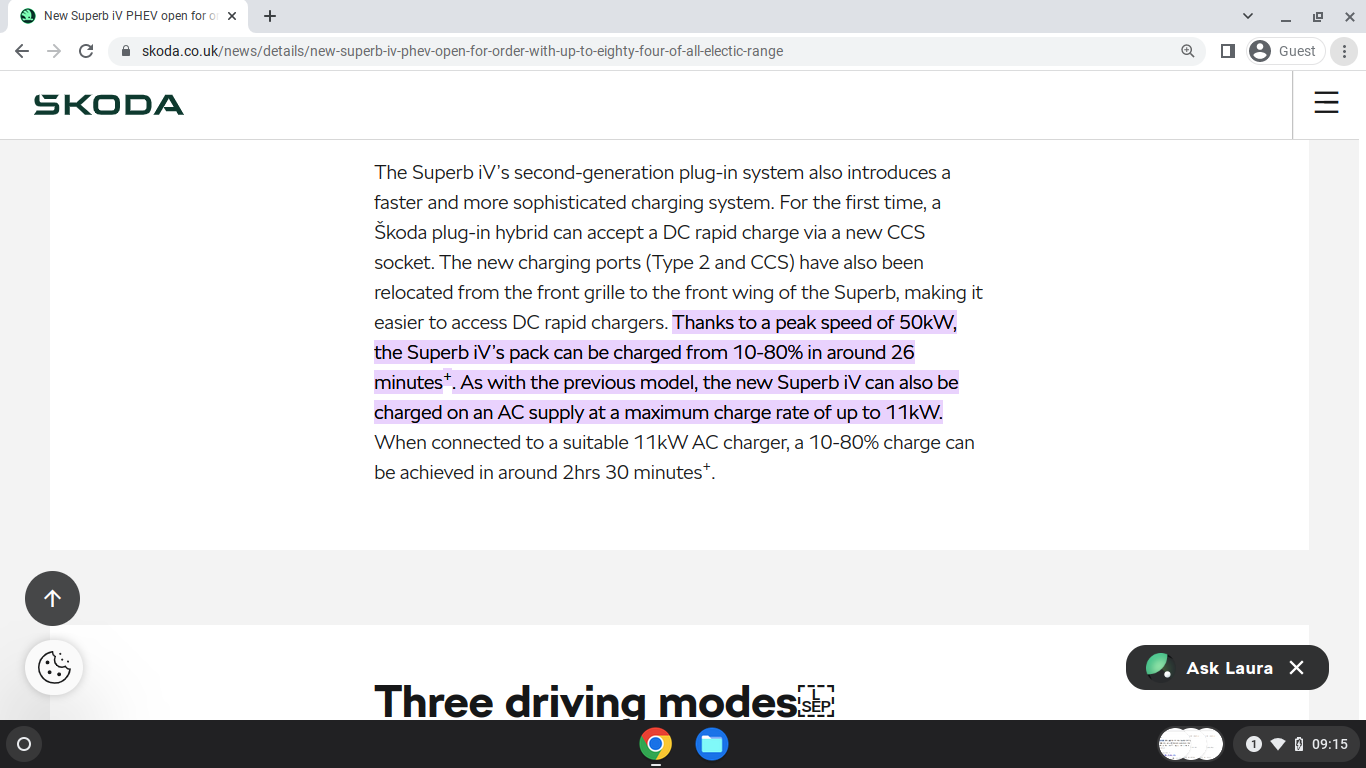

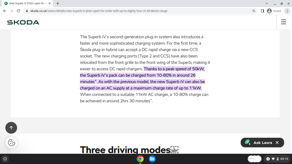

For the last 10% , 90-100% if it drops below 11 kW charging speed imight go on the 11 kW AC charger and pay less per kWh and take no longer.
10-80% is 26 minutes, not a 10-100% charge on a 50 kW DC charger.

Factory values:
The usable capacity: 100% = 19,7 kWh so 10-80% means 13,79kWh / 26 min results 31,82kWh in average in the best range.
It is unclear what value is displayed by the car and the charger, since ~12% charging loss is coming into the equation on DC. According the Skoda communication I assume they are stating the real charge and not the consumed from the charger.
