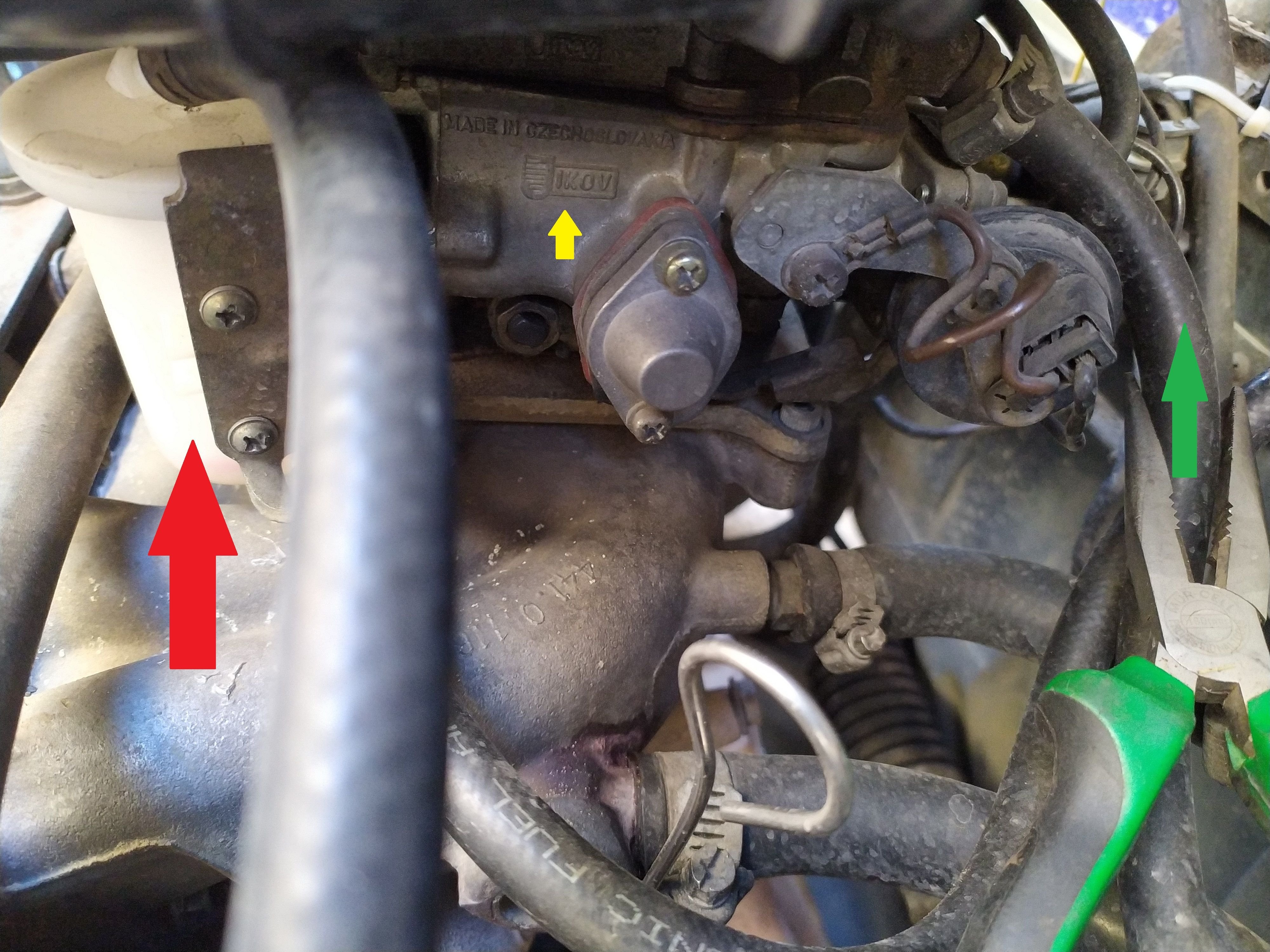

The carb on the favorit is Jikov 28-30 LEKR which is a Pierburg 2E3 clone.  (Marked with yellow arrow) Maybe they had to use original 2E3 for some exports.
If you've pulled it from another favorit, then there should be no problem with the jet setup.

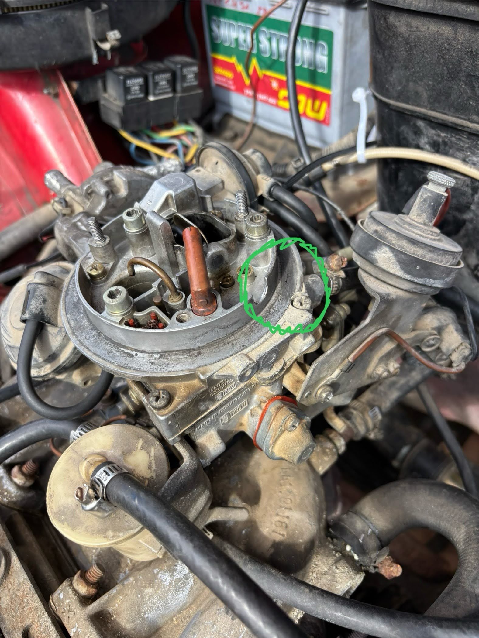

Please do this easy test:
After the cold start, wait for 1 minutes.
Squeeze the fuel hose marked with green arrow on the picture.
The engine will continue to run. Let it run until it dies from fuel starvation.
Release the hose, start the engine again.
See if it will start.
Why doing this?
This is the carburetor's fuel supply line. Cutting the fuel supply by squeezing the hose won't stop the engine immediately.Because, there is a fuel chamber inside the carb. Until it runs dry, the engine will continue to run.
Don't worry about stopping the fuel flow. The part marked with red is the de-aeration chamber. When the fuel chamber inside carb is full, there is a float in there stopping the flow from inside. Like you do now from outside. When the fuel is stopped from entering the carb, it is routed from the de-aeration chamber back to the fuel tank.
Why doing this?
The float inside the carburetor is connected to a needle with a rubber tip.
5553_automrazik-115940451-jehlovy-ventil
You've taken this carb from a car sitting in a junk yard.
The rubber tip of the needle might be hardened and not blocking the fuel flow well when the engine is cold. Causing the fuel chamber to overflow.
If the fuel chamber overflows, the engine will stop suddenly. Just like you've described and it won't work until the excess fuel vaporizes from the intake manifold.
Idle mixture screw only adjusts air flow of the idle and nothing else.  The fuel is only adjusted by replacing the jets.
Have a good luck with your interview. :thumbup:

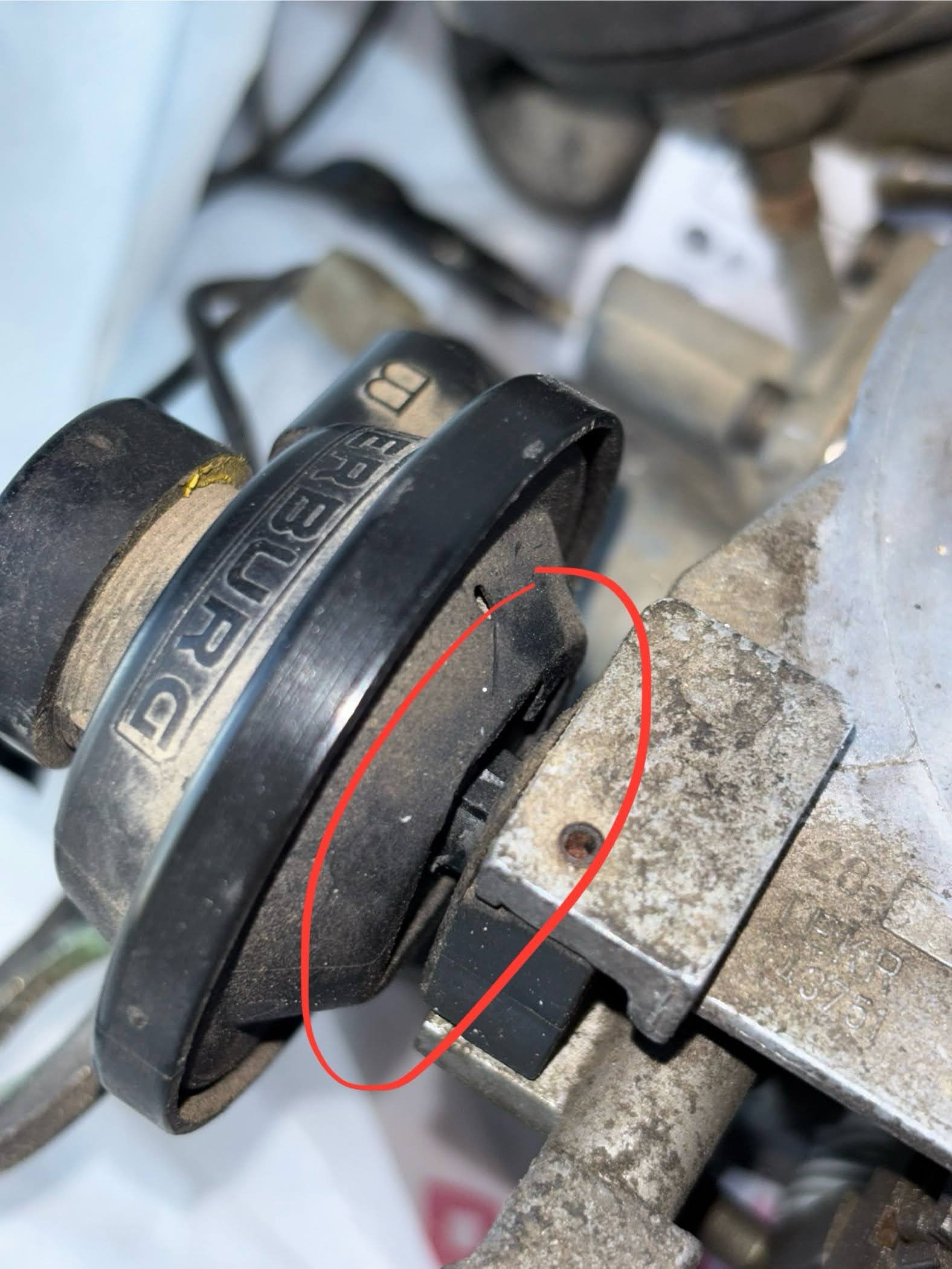

by the way, I just noticed that both of the choke pulldown units on my 2 carbs are cracked in the same place, I did check if the pulldown unit on the carb holds air by breathing in to it and it does so maybe its good and just the plastic case is bad, and because this issue still happens even when I removed the choke completely maybe the pulldown unit doesnt contribute to this.
The picture if from my other carb that’s not on the engine.

@R_Blue's float needle theory did make sense to me and I wasn't very satisfied from the result of the test with the vice grip.
So I took a small hammer and gave the top area of the carb above the float needle (green circle) a few hits so if the needle was stuck due to temperature maybe the hits will free it.
Got to the car after sitting all night, removed the air cleaner, gave the green circle a few hits, went inside to start the car, and the car didnt stall!
I was so sceptic but it worked, but before I do anything I will try tomorrow morning to start without trying to free the float needle and see what happens, and the day after that I will try to free the float needle and see if it doesnt stall again.
I will update you guys soon.
Edited by OmerGarabagi
So the float needle is getting stuck.
Every morning, the engine works with  the residual fuel left inside the carb. When it starts to stall you push the pedal, the injector inside the carb sprays the leftover inside the injector pump giving you the last seconds life and then it dies again.

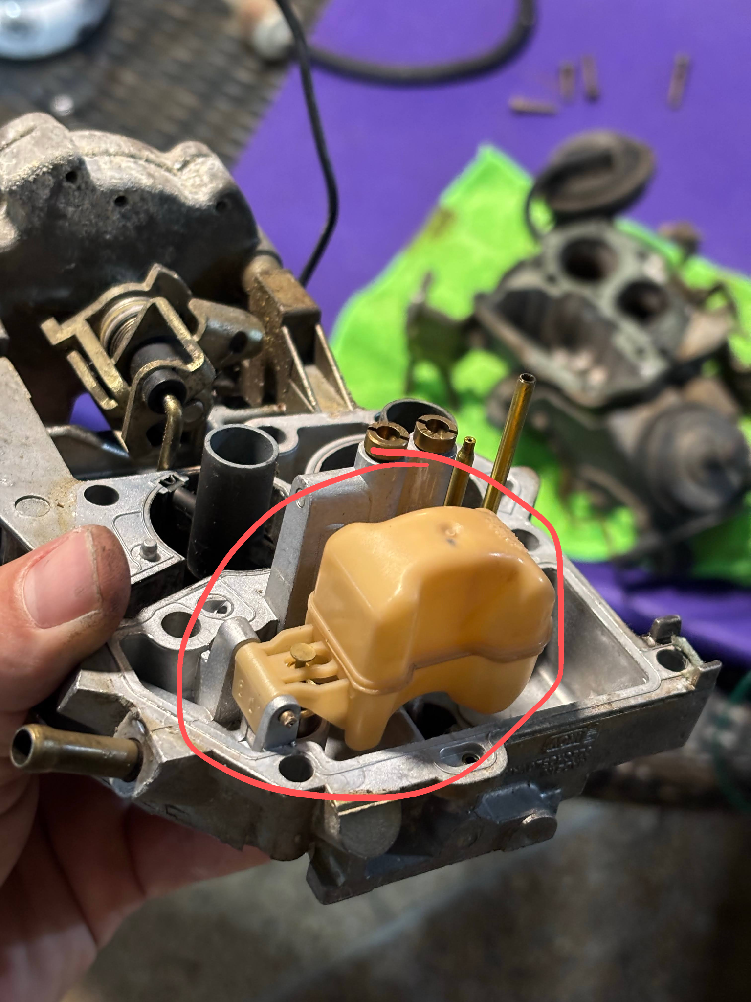

I replaced the float, needle and pin that holds them and it didnt help.
After a cold start the car ran for 2 minutes and then stalled.
My next step is to try a cold start again, let it stall then open up the top of the carb and see if there is fuel in the carburetor's bowl, if not then I will try replacing the fuel pump, maybe its acting up when cold. if there is fuel in the bowl then god help me because I replaced everything (except the fuel pump).
Hopefully I will update you guys soon.

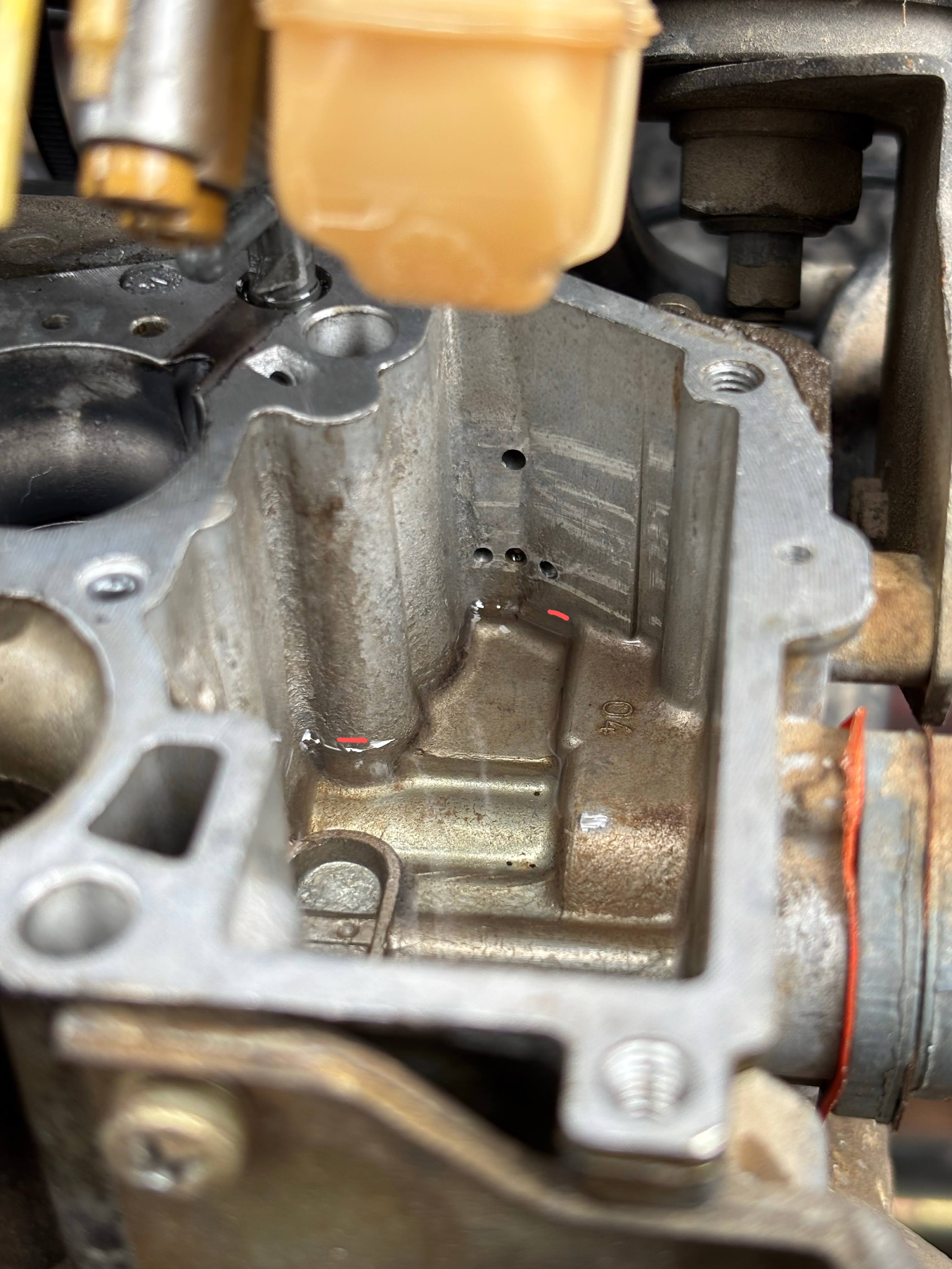

I cold started the car, it ran for 2 minutes and then died (as usual), I opened up the carb and this was the amount of fuel in the bowl (marked by the red line).
Correct me if I'm wrong but this isn't enough fuel to run, right?
I already replaced the float and needle so the fuel pump is my next priority, maybe its not working properly when the engine is cold, @nta16 the electric one I have ordered should arrive in the next couple of days.
The weird thing is that I can see fuel being pulled from the gas tank through the clear plastic filter that is placed before the fuel pump, maybe its not pumping good enough when cold (I hope).
I do not know the carb at all so better for others to comment. if the read lines are those very small red lines then, to me it looks low but the float is very deep and depends what all those markings are about.
