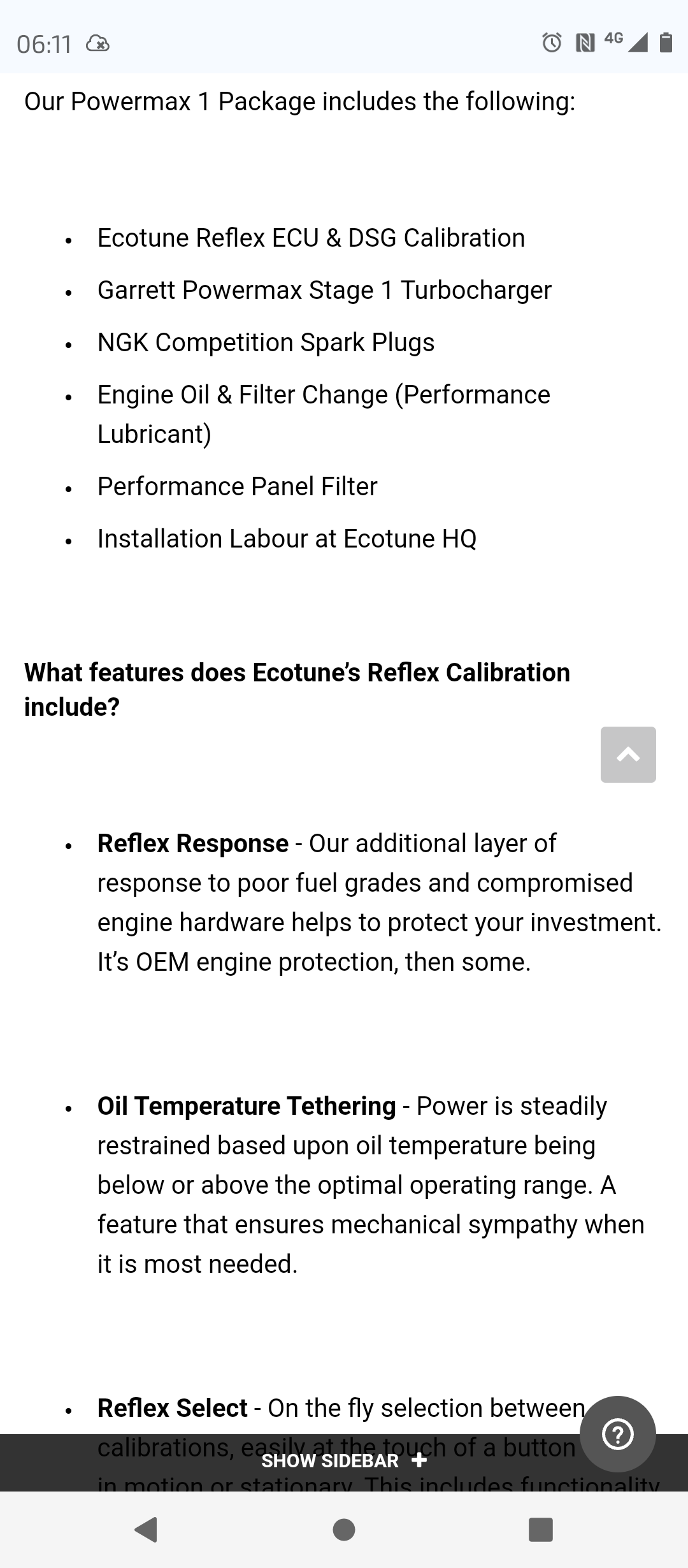

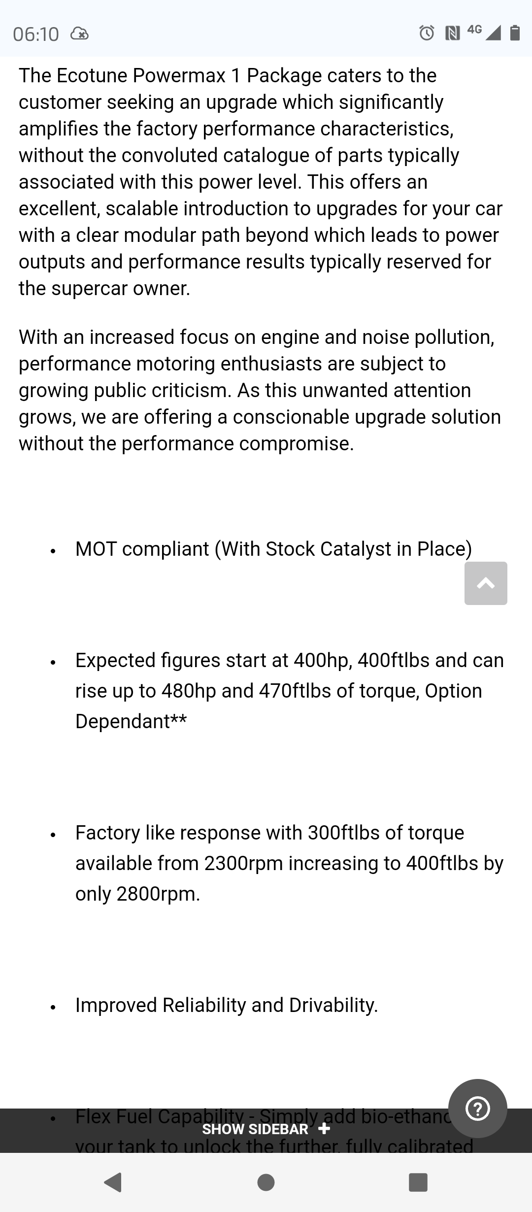

Ok, so I think I've managed to answer my own question..on the EcoTune website is a package which is pretty much bang on what I'm trying to do. A Garrett Powermax stage 1 turbo, without doing any of the extras like intercooler, downpipe, etc. Just the Turbo, an air filter and a remap. Should yield around 400 GGs which is around my target. Kind of thinking maybe I'll do the fuel pump.. maybe not, we'll see.
