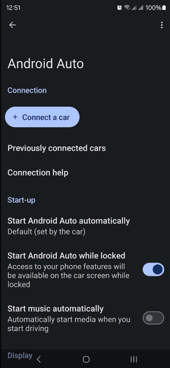

on your phone if you go into Android Auto Settings there is a slider to Start Media Automatically. Is that on ?
Shown at the bottom here:
Thanks, Aubrey.
I've changed that setting, I'll see if that sorts the issue when I go out in my car later.
That worked and stopped Android Auto automatically playing my Spotify through my car stereo.
