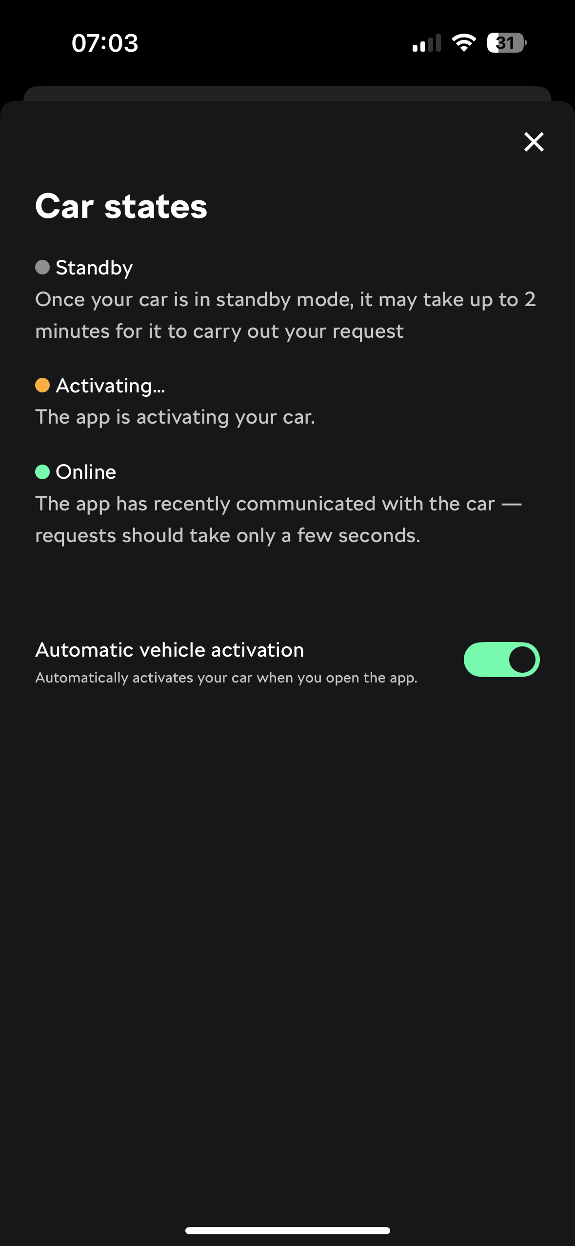

Mine sometimes takes a while to come online, as per this info screen.
Try resetting or uninstalling and reinstalling the app if it persists.
