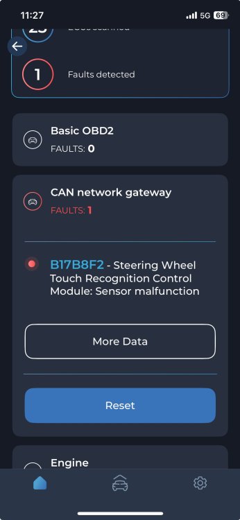

For the second time, the steering wheel touch recognition sensor has gone on the fritz.
First time, in February 2021, the car was only three months old and was having a nice long kip in the yard round the back of the dealership while it waited for delivery of a replacement rear diff, so was right at the beginning of the original warranty.
A couple of weeks ago Carista picked up another sensor failure (B17B8F2, for what it's worth), and as you'd expect the fault won't clear and reoccurs each time the car is scanned.
As far as I'm aware fixing this will require another replacement steering wheel.

If you're not 'peterziherl' on OBDEleven forum then this was his final reply to his thread -
"Twice they installed a steering wheel with the same defect, only the third time they ordered a new one from the factory (waited two months). Now it is 4,000 km and there are no more errors, and the system works flawlessly."  As at post of  Apr 13, 2022 at 7:20pm.
Before that on the thread member 'massimo23; put about the trouble codes in opening post of the thread, including B17B8F2 -
"These errors are found in VW TPI and the fix is to replace the steering wheel touch detection unit 5H0959542A with 5H0959542E."
So personally I would ask the Dealership if there has been an update on the TPI for the change of part code to let them know you know about this in case you next get someone there that wants to start any run-around about it all as some at these sort of places can.
Sorry I've no idea about extended warranties, as always you could go through the T&Cs and the fine print to see what is excluded and might be interpreted as a possible get out of jail for them.  Many agreements even from very large companies that should know better and can easily afford to get things right can have errors and omissions or be badly written so giving possibilities of unexpected interpretation from either (or more) parties and often certainly not written in plain English (or even translated to).
I would get the change done ASAP as November will soon roll round and if you need a replacement of the replacement (I don't know only saying) it might be out of warranty period only the part is covered by its own warranty and arguments about garage getting paid by who(m?) for the labour, and scan (do they ever no do a proper diagnostics other than a scan?), and wots a scan from them now £150 or summat like.
Good luck.

My car is very similar to yours I believe, and way back in Autumn 2021 I was getting annoying error messages saying that the Traffic Assist, Lane Assist and Dynamic Road Signs features were unavailable. The solution at the time was to change the steering wheel controller - which seems to be part of the steering wheel - and so this was changed at the end of November 2021.
That cured the problem at the time, but the error messages returned during the first half of 2023. This time the cure was to implement the Service Campaign 48S5, which was done in June 2023.
The error messages still occur, but are now very infrequent and easily are reset. I bought my car with a factory 5 year warranty, and all the above work was carried out under warranty with no problems,

Your car has bells and whistles that my pauper’s version doesn’t have, the consequence of which is that I haven’t had any dash warnings of impending disaster, fortunately.
i just get this recurring when it’s scanned, and as I mentioned earlier, I’m pretty sure it means a new wheel:
