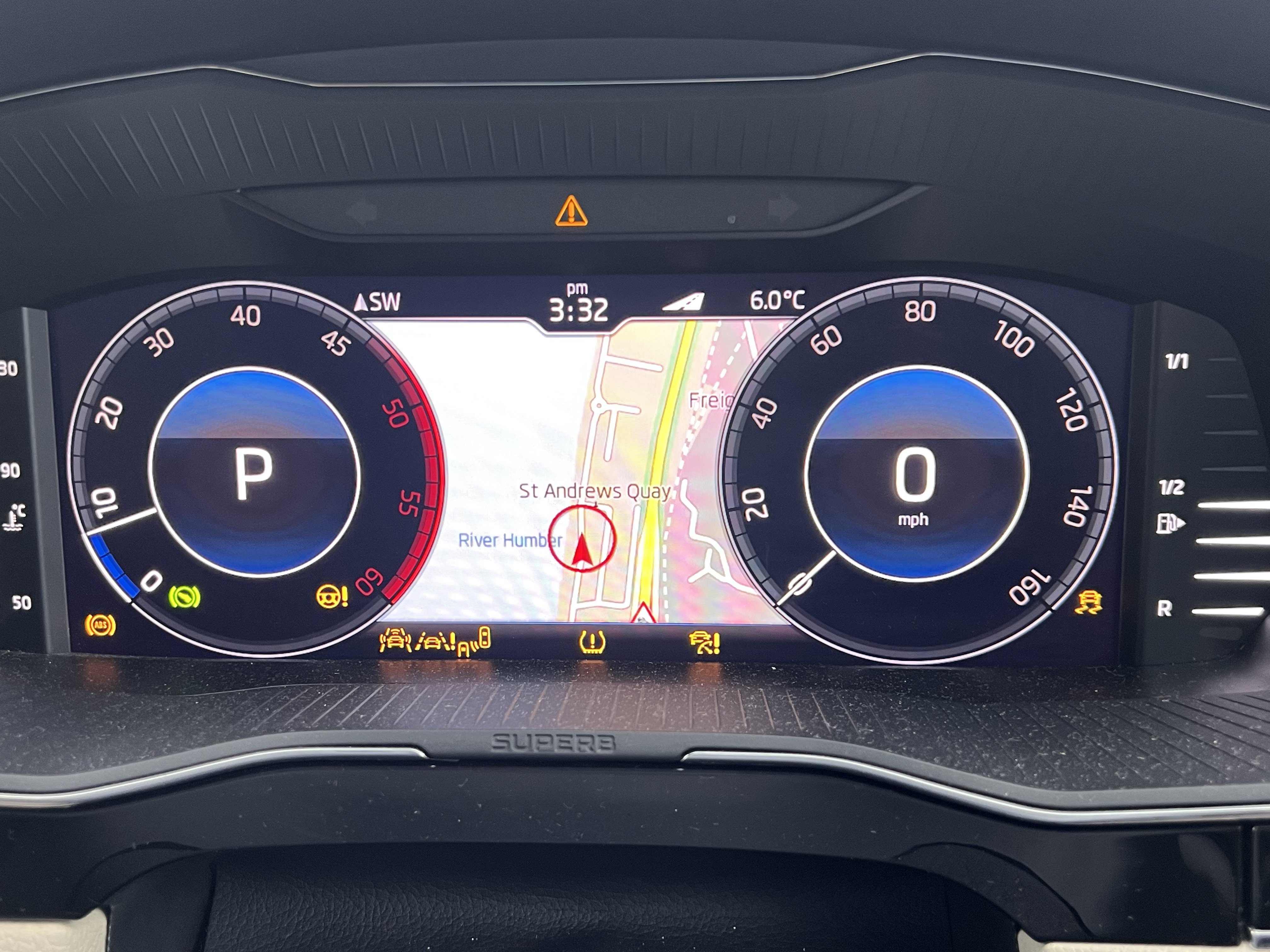

Dashboard illuminates like a Christmas Tree!
On starting my 2019 Super Estate I get multiple warning messages about failure of auto stop/start, tyre pressure monitor, ABS etc. The dashboard is a mass of warning lights.
I have had the battery checked and it is good.
Any ideas or is it back to the garage?

Sent the car to my dealer for investigation. The battery was fine. The problem was traced to a faulty speed sensor on one of the wheels! Everything back to normal now.
