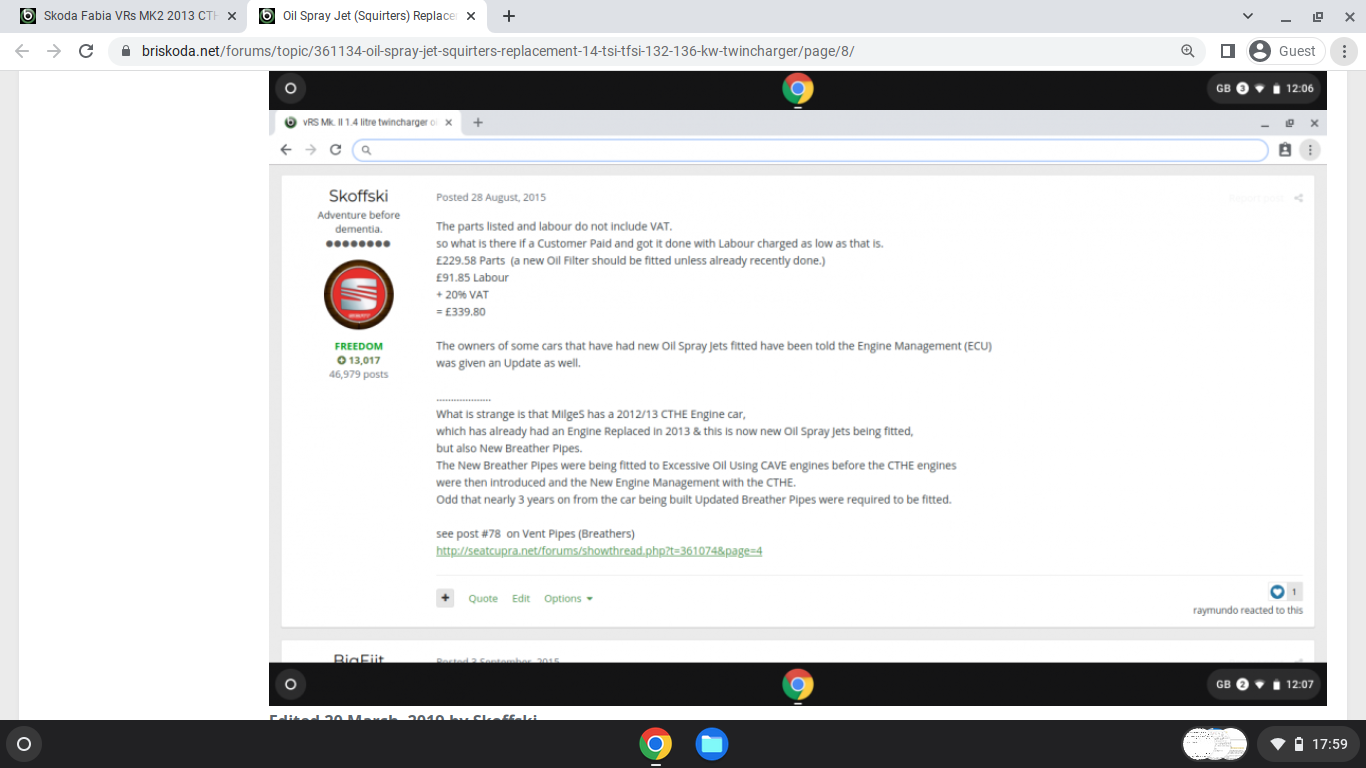

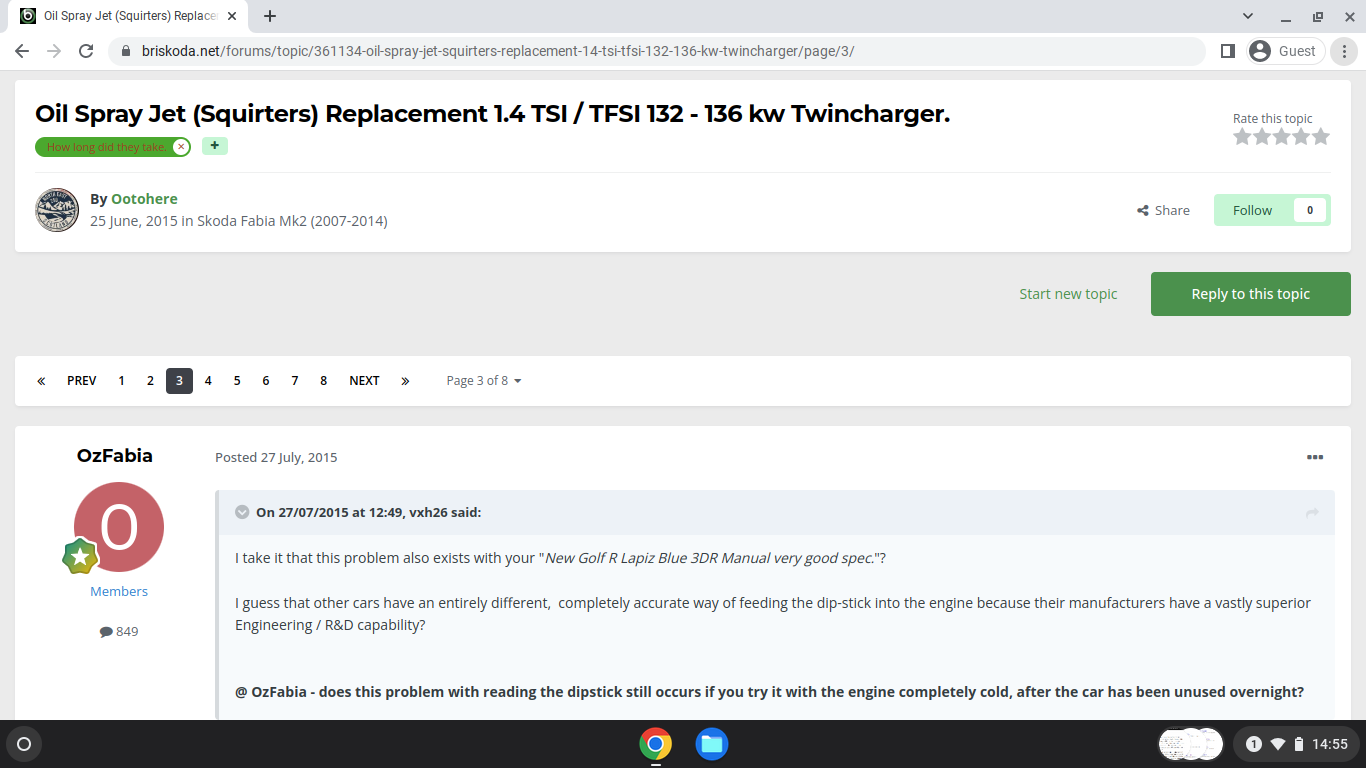

Sorry, could not link, search the thread.   Some say worked.
Oil Use Thread pinned at top of Fabia Mk2 Section. Last pages will be enough reading.
