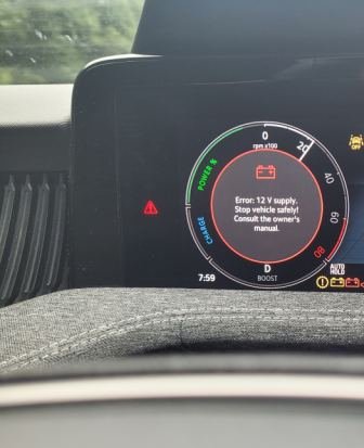

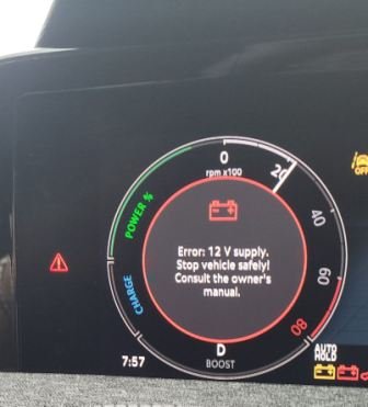

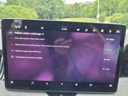

Hybrid issues from Febuary 2025 and car now off the road since July with no resolution in sight. Car was brand new in Dec 2024.
JX1 CU replaced 3 times (dealer blew each one up)
Then cable checks
Earth checks
More cable checks
Dealer back and forth to Skoda UK with neither party seemingly able to fix the fault.
Dealer won't supply any detailed information either (it's confidential apparently)
Requested rejection but 10 weeks later and no response from Skoda financial Services.
My last iV was faultless, this one has been a nightmare.
Skoda UK and Skoda Financial have been abysmal.
No VAG car for me ever again.

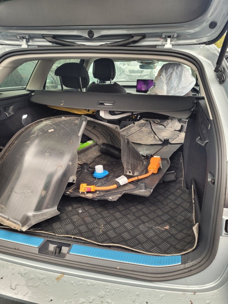

Sadly, my (very) brief Skoda Superb adventure is over. From late July to the end of October, the car remained immobile with parts of the vehicle exterior strewn about the interior. VWFS accepted the rejection.
What happened with this car?
