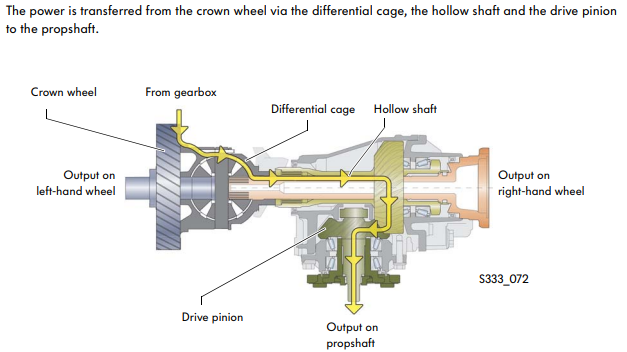

VW Caddy 4motion 2.0 TDI gearbox help. Drive to rear wheels only! Urgent help needed
