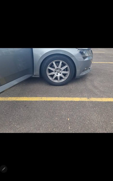

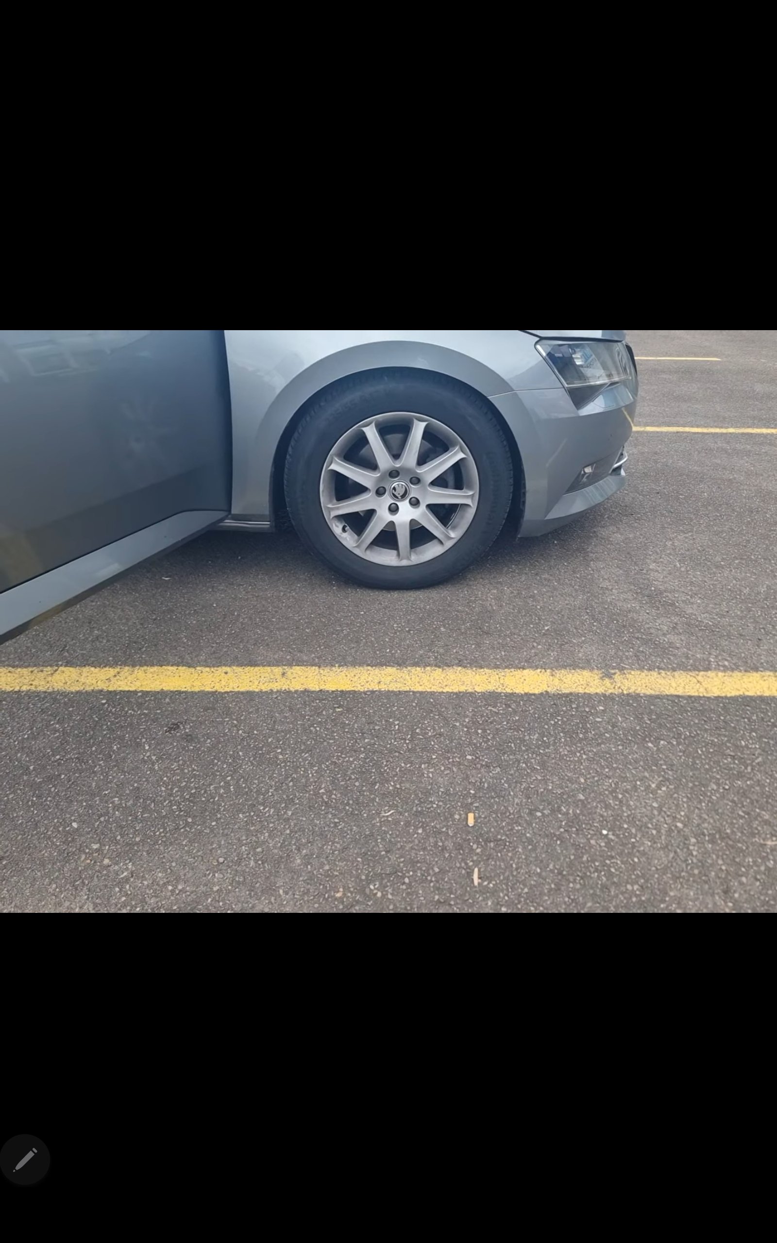

I have now owned my new to me Superb Mkiii Wagon for 3 months and 5,000 km. I have swapped out the 19" wheels for 17" and gone to 235/55 x 17 tyres to try to get more compliance on our scrappy back roads. The change has helped a lot but I have enquired about Bilstein shocks for it and been told ones for my model are not obtainable in Australia. My car is a Style variant and has Sport/normal/ economy modes selectable by push button on the console.
I would be even willing to install standard Skoda regular height (not Style or Sport)springs and shocks to get away from the paranoia I have on roads I drive on.
I have touched the front underbody down too many times at speed to not try and make a change ! Any advice would be appreciated !Screenshot_20250324_134505_Photos.jpg

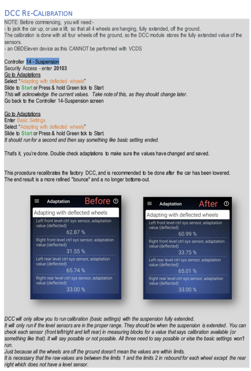

Hi JR RS, who did the recalibration for you ? What hook up did they use to do it ? I presume it's not just via the OBD cables. Where do you find the Arteon files ?
the DCC Recalibration u can perform urself using OBDEleven or VCDS.
instructions below.
the DCC Slider Mod requires specialist tools and has a lot more "complicated" steps as it also involves updating the Gateway module firmware aswell.

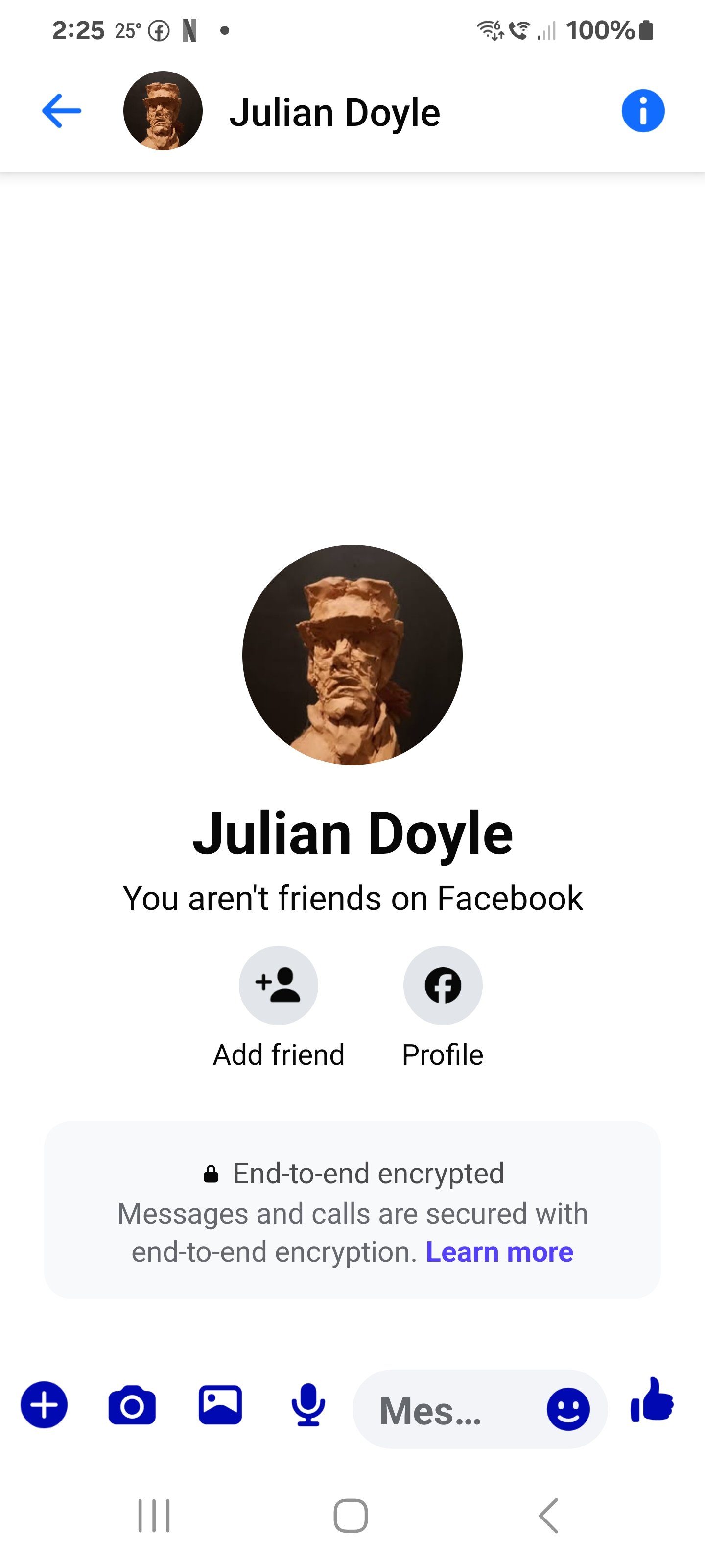

There is quite a few blokes in Sydney (Facebook does not show exact suburb, just Sudney) with that name - I am spamming them 1 by 1 now. Thanks JR - I will try this 1st before shock swaps !
he is using a cartoon (bitmoji) avatar as his FB profile pic.
Got him, started the conversation about doing it - sounds great 👍 Thanks JR !
