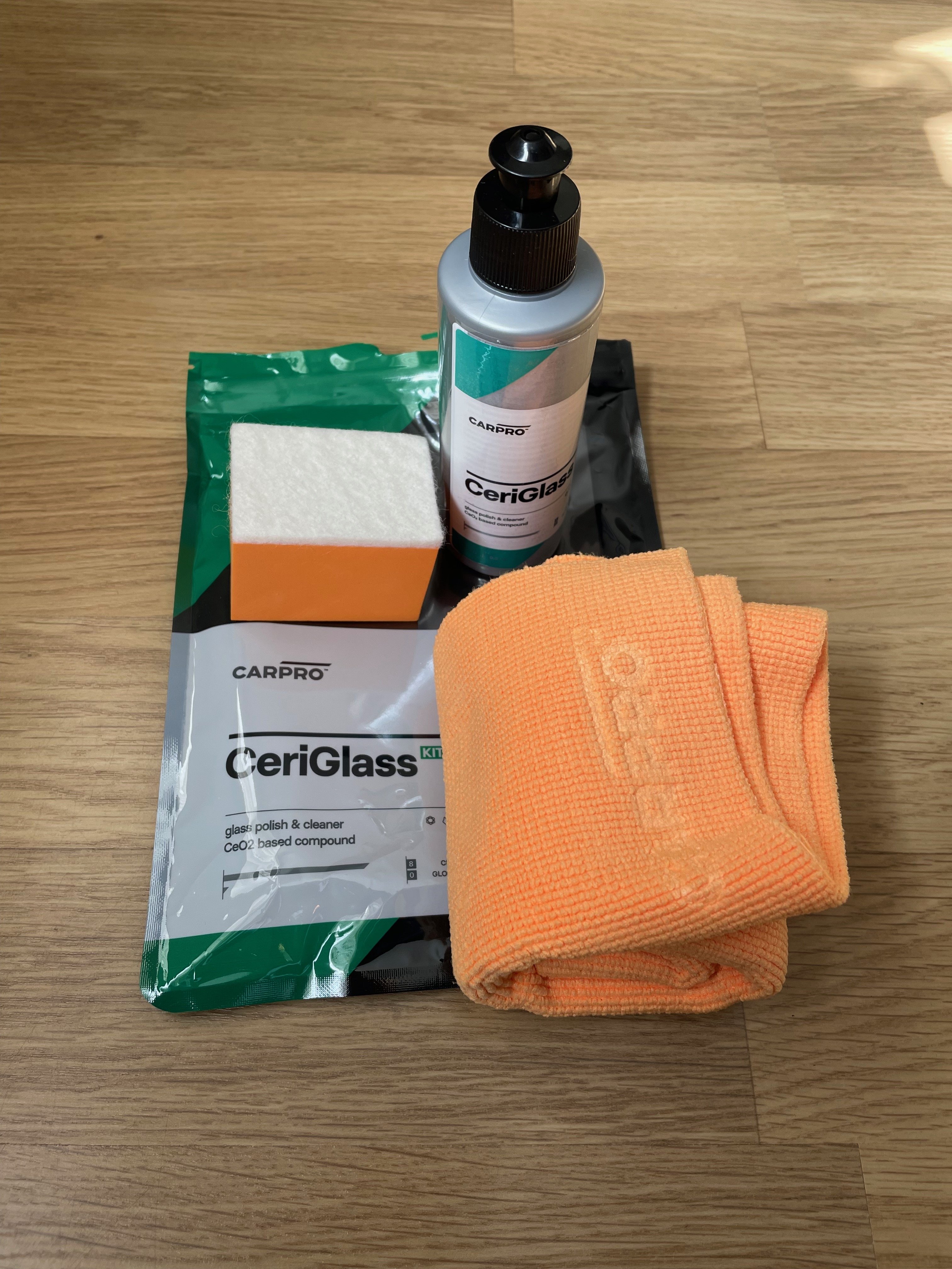

The kit arrived yesterday:
So I set about it this morning, using the provided foam and felt pad. I taped the area so I didn't wander and kept my focus. It's a shame my photography skills aren't up to showing before during and after shots, but I simply couldn't get a photo of the scratches for love nor money.
I spent several minutes of enthusiastic rubbing, cleaned it off and buffed. Then repeated this two more times. What seems to happen is that as the product starts to dry a bit, it whitens and shows up the scratches, and then as you buff it they start to disappear. I'm not convinced that I'm actually removing the scratches, but it's more likely the product has fillers in it that makes them not visible. Dunno.
What I do know is it was bloody hard work and the bottom of my thumb aches. But I can't see the scratches, so I'll take that as a bit of a win. We'll see how long it lasts 🤞

Bit late, but you can also get a car pro rayon pad which will make life a lot easier if you need to go over the screen again.
A polisher is the way to go to make life simpler, but they are not cheap for a decent one.
Could you maybe borrow one from a friend if you purchased your own pad for it maybe?
I use this type of pad along with the ceri glass to clean windscreens from fallout and grease etc a few times a year, and it will happily remove wiper marks from the screen as well.
Just tape of the trim around the glass to avoid it damaging the plastic and don’t go anywhere near paint with it.

The Ceri glass kit already has a rayon pad with it I think - the orange block with the white side to it in gaz’s pic. I only know as I’ve previously bought one separately and it says Rayon down the side.
