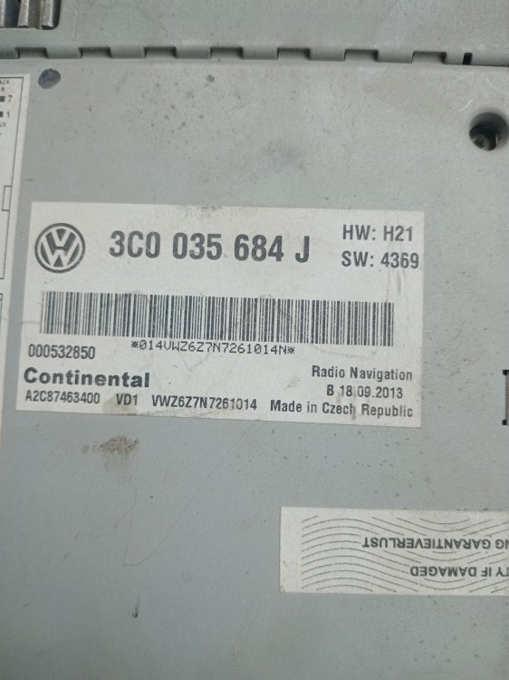

@pab567 hi, my otherwise perfect Yeti is doing the RNS510 reboot loop - would it be possible for you to send me the 6276 firmware link so I can see if an update solves the problem? Many thanks - here’s the unit label.
Download link sent in PM. You will need to re-install maps after upgrade.

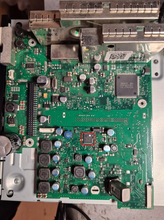

When this started, it was boot looping but it displayed the Skoda Logo and eventually worked (after x numbers of restarts).
Now I can occasionally see two white stripes / lines across the screen before it restarts.
@pab567 - Do you have the correct firmware for my unit? How long does an update take? Since the display is blank, I have to guess when the firmware update has been completed.
BR Christoffer
I've sent you link to download 6276 but I'm afraid this might be a hardware, not firmware problem. If firmware reflash doesn't help then you can try to have it repaired locally, start with resoldering chip i marked red in the picture below.
