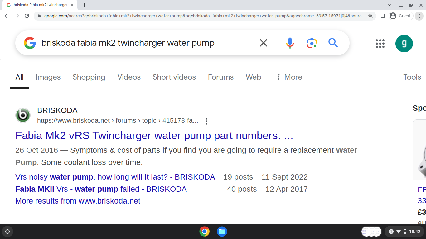

The water pump failing with a Twincharger is usually shown with a slight loss of coolant and the Supercharger Clutch is part of it and you can get a Emission Control Light or EPC light or both show, and lose the Supercharger working.

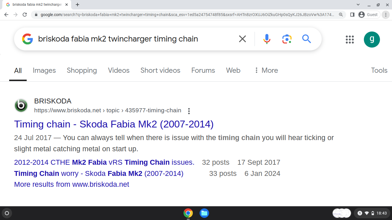

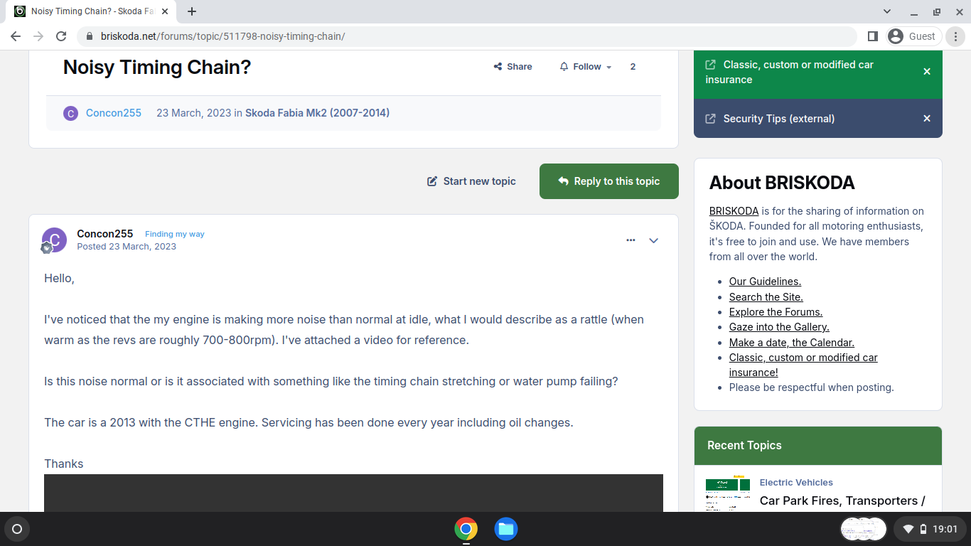

Sounds like the issue known with CTHE,s, tensioner and timing chain. Plenty threads on both issues.
