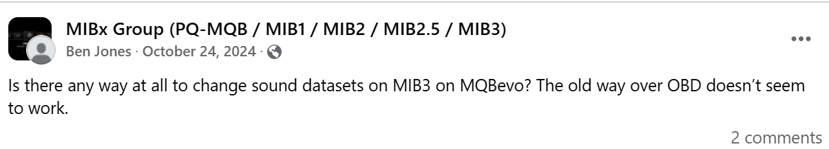

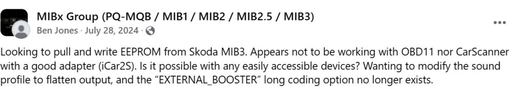

Some posts on Facebook without answer:

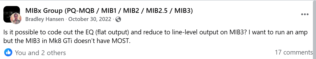

I am in the same situation but with a DSP amp installed and yes, flat EQ is mandatory.

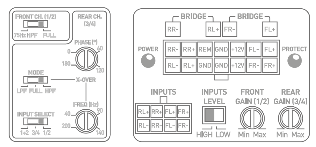

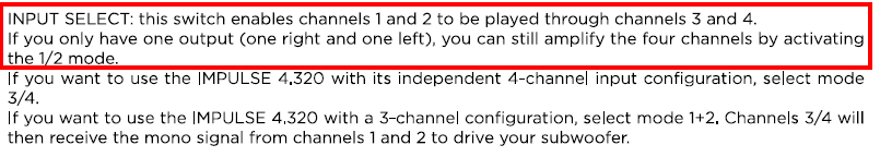

One of few possible solutions (workarounds) is to install AMP, for example Focal IMPULSE 4.320, which has ability to play signal from front speakers to rear speakers. With that you can bypass "bad" signal for rear speaker and have amplified all 4 speakers (FRONT L+R and REAR L+R) with "good" VW (Škoda) signal for front speakers. You will obviously lose "fader" ability on your head unit, but you can set it on Focal IMPULSE amp via front and rear "GAIN" knob. Probably you will have front sensors sound on both front and rear speakers, and you will loose rear sensors sound.

I’m also tackling the same problem. I have a VW Passat B8 FL (2021) and I’m getting the exact same error. I’ve tried using both Car Scanner (with Vgate iCar Pro 2s) and OBDeleven (EEPROM) – got the same errors you’re experiencing. At first, I thought it must be SFD-related, but after getting OBDeleven, I noticed it doesn’t prompt me to unlock anything. I did some more research, and it seems like my car isn’t locked.

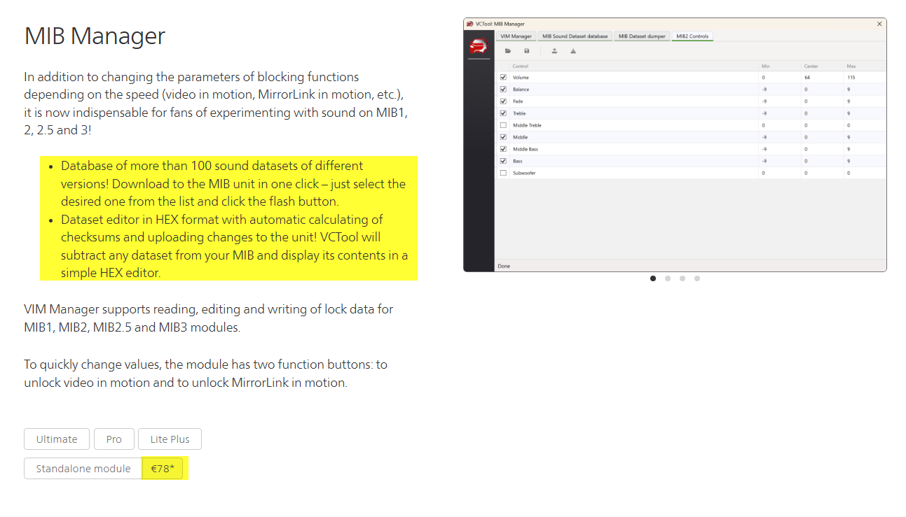

The VCTool app seems to be the most capable when it comes to reading and writing datasets. They even have a store where you can purchase factory datasets. They also recommend using different OBD adapters and explicitly advise against using ELM adapters, so there might be something to that.

As I see on their webpage "MIB Manager" module costs 78€? Is this correct?
Also, The generation of SFD tokens, requests to the Stock Service and FoD Tweaker module are not included in any subscription and are provided for an additional fee!
Can you please explain what did you done with VCTool?
