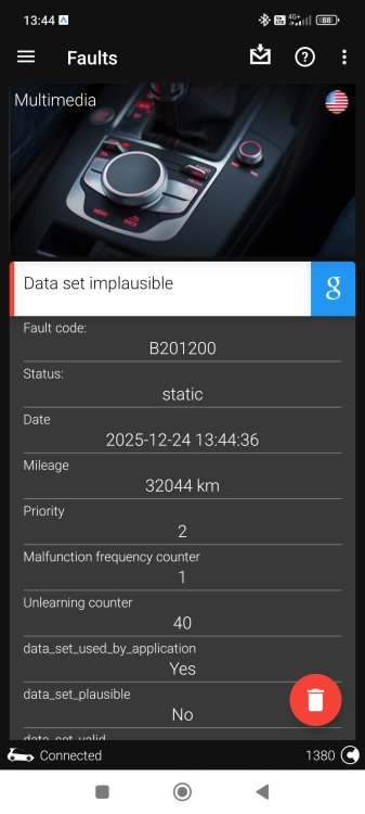

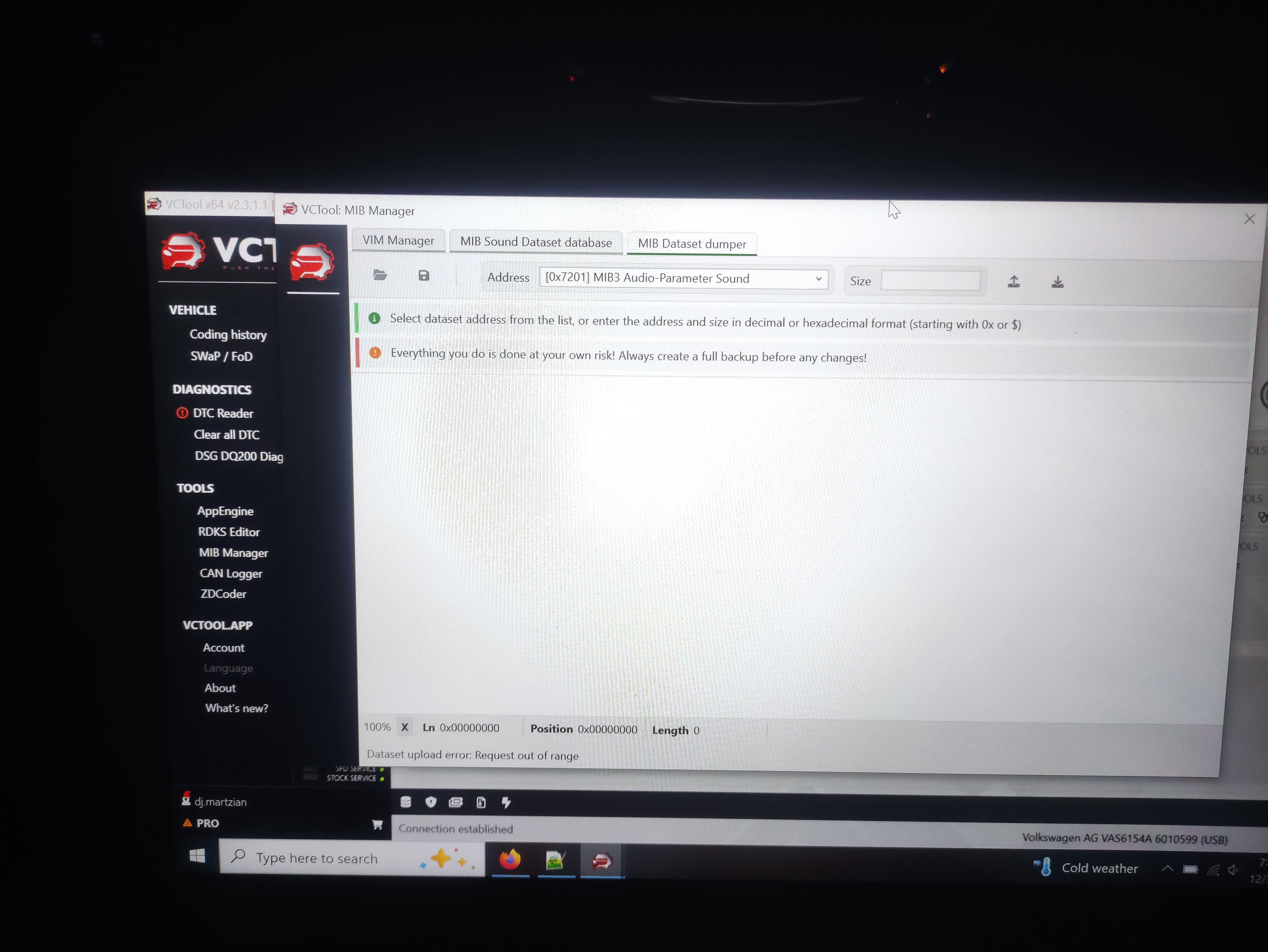

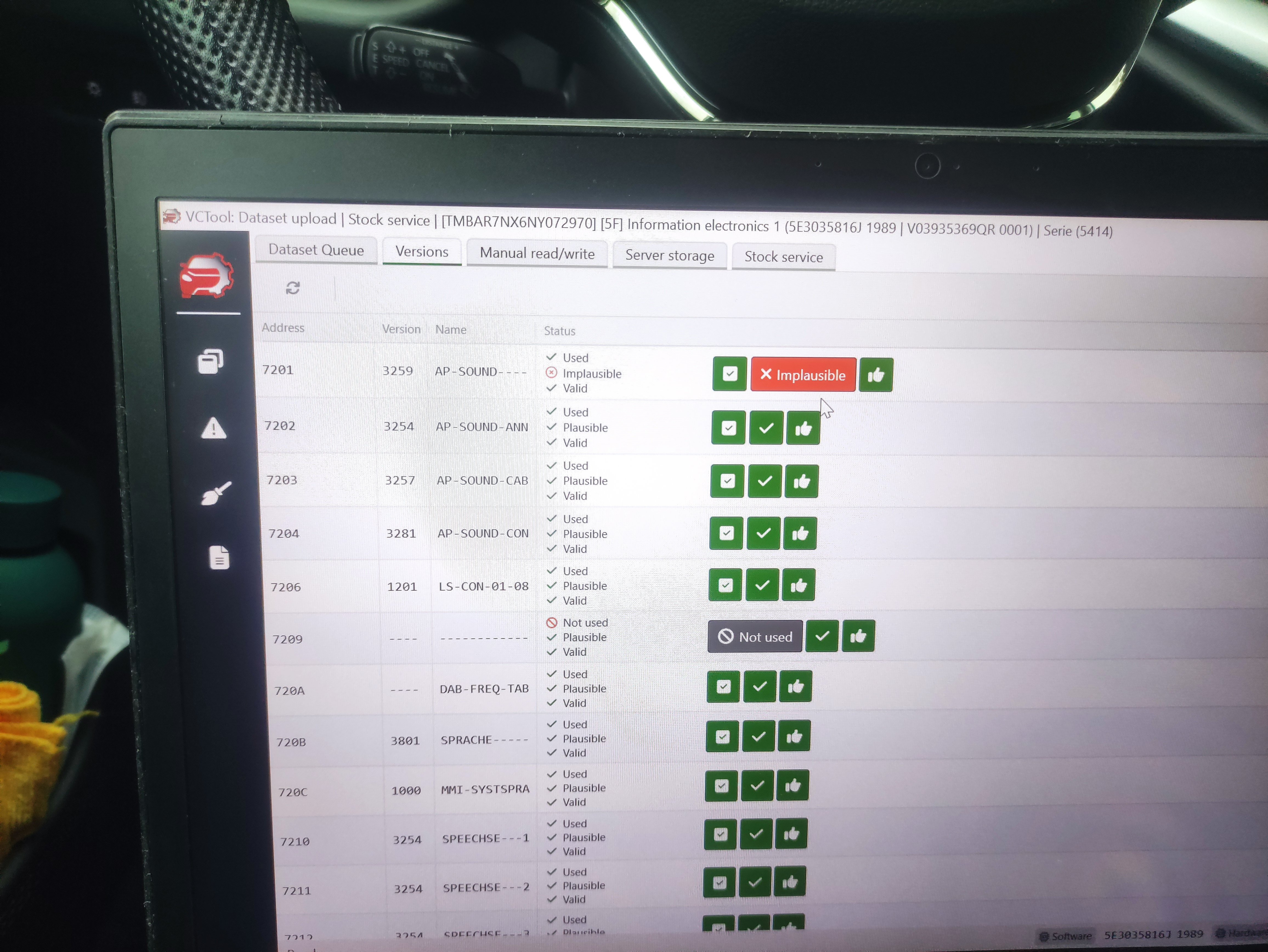

Hello @trinajstich ,
I've uploaded Dataset #16 from VcTool. The sound is indeed better than stock one.
I've also tried to restore on Stock dataset, but I wasn't able due to: "Requested out of range!" error.
Beside this, a static/permanent DTC "B201200: Dataset Implausible" is generated and can't be deleted from [5F] - MIB3.
Can you please check for errors in your [5F] control unit?
Bear in mind, that I have a valid PRO subscription and I did a backup on [5F] before changing the audio dataset.
Thank you
Happy Holidays!

The 5F now detects manipulation because the data set is no longer plausible for the hardware or software.
This can only be fixed with a data set that the device considers OK.
If you still have a warranty on the vehicle and the dealer finds out about this, the warranty for the radio is now void.
Hello,
Short update on ^^: With great support from VCTool guys, I've managed to restore Stock data set.

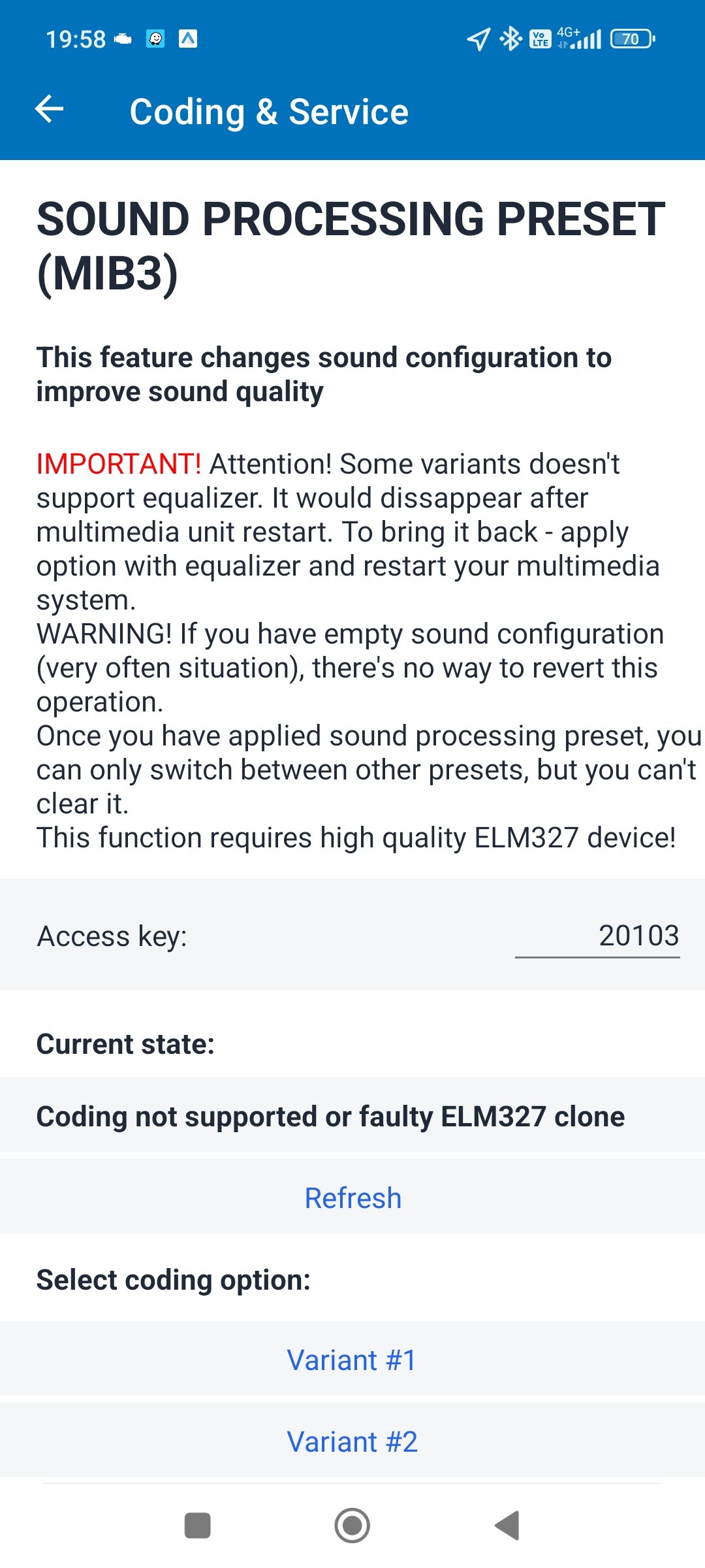

I've also been looking for alternatives and I've found the following option in Car Scanner PRO:
8. Sound processing preset (MIB3)
This feature changes sound configuration to improve sound quality
https://www.carscanner.info/coding-mqb/
Has anybody else tried it?

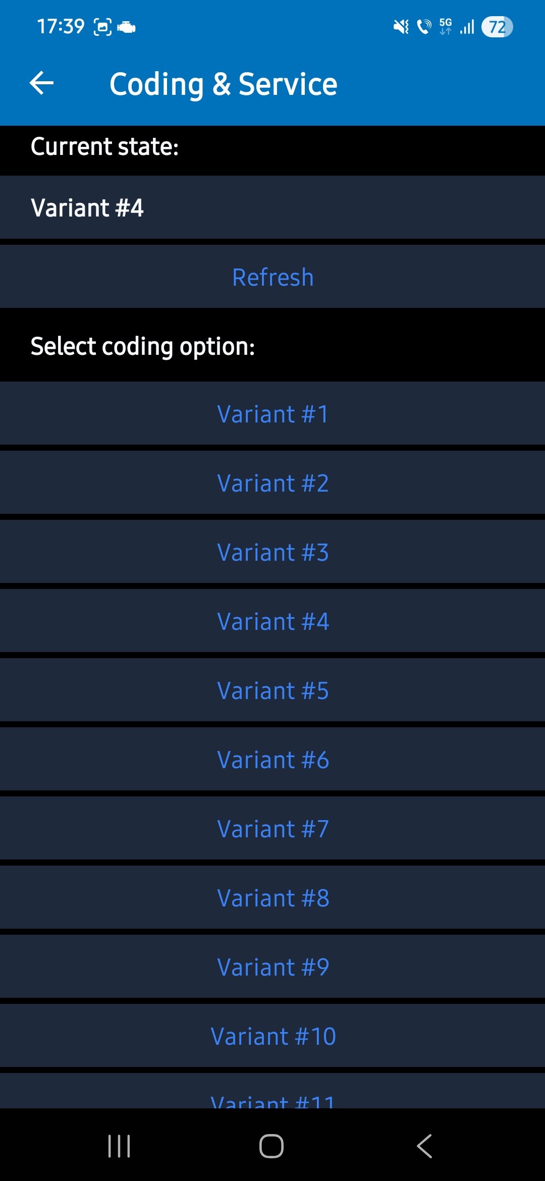

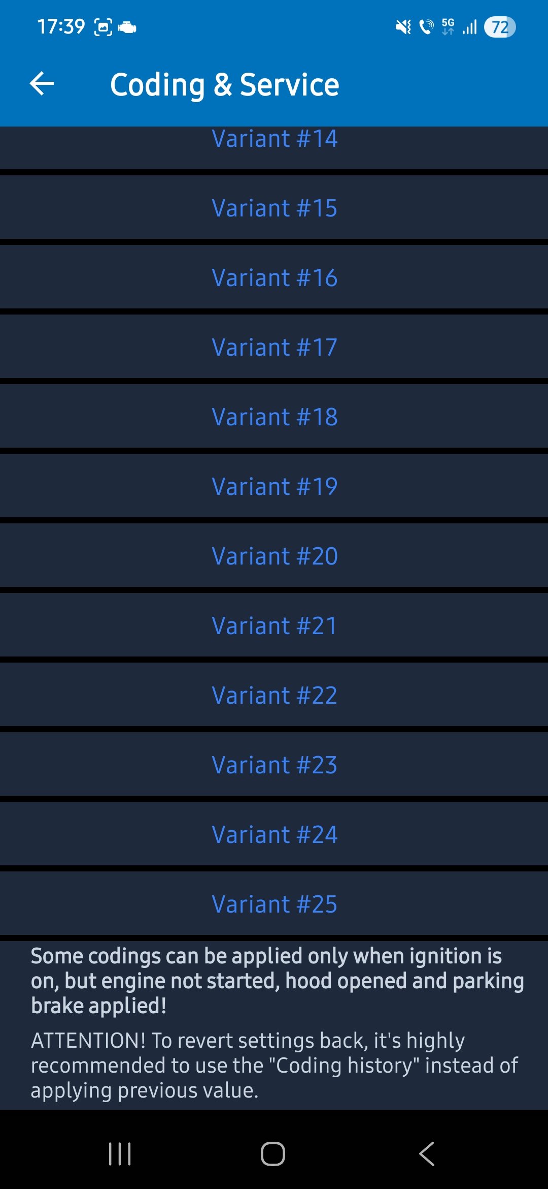

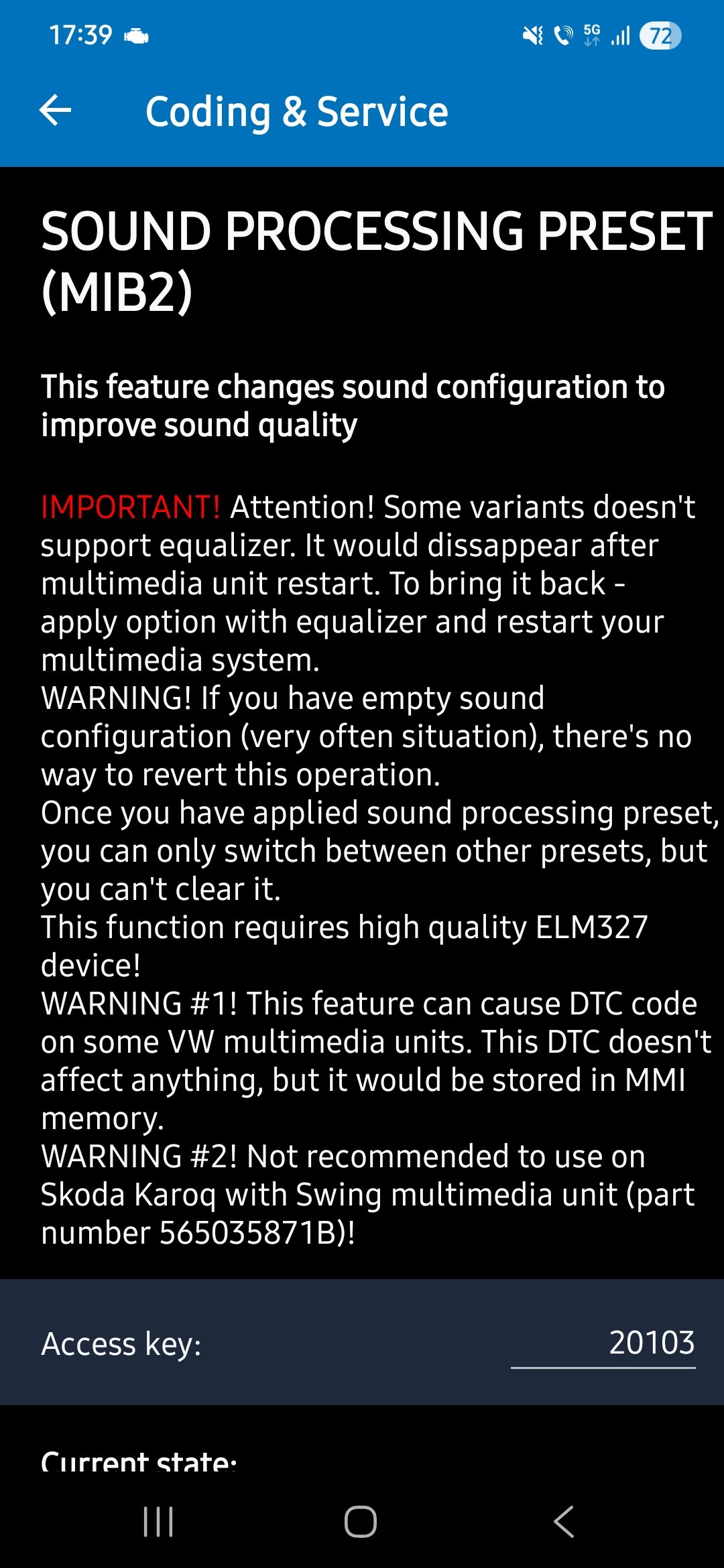

Hi guys,
I know that the Skoda Karoq is not the same as the Skoda Octavia MK4 but I just wanna say that, using an ELM327 and CarScanner app, I successfully read the dataset and I have also tried some presets and I can say that for sure, the sound is a lot better, I mean, a lot better than the stock: deeper bass, higher volume.
First I did a dump of the current dataset(the stock one) and later I have tried to modify manually the dataset using the tutorials from mqbsound but for some reason the dataset was rejected and an error code was present in the 5F module( I guess the CRC was wrong).
Then, I have tried the option #4 from the presets and now it's like my sound system came alive 😅
Now, I am planning to soundproof the door cards.
@Viorel_92
Which elm327 adapter you used? I'm getting faulty or unsupported adapter when trying to export the dataset.
JFIND JF327

Where you select profile 4 ? On carscaner ?
Yes, on CarScanner app
can you give me screenshot ?
Guys, ^^ settings are for MIB2 unit. Bear in mind this thread is for MIB3, so it can create confusion. 🙂
