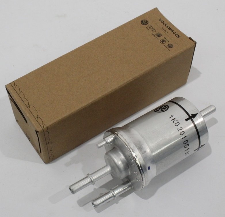

Inside the fuel tank before the fuel pump you have a 'mesh screen' filter which has 30 micron filtration rate.
Outside the fuel tank after the fuel pump you have combined inline fuel filter and fuel pressure regulator which has 10 Micron filtration rate.
( It is this Outside fuel filter that is regularly changed in accordance to the VAG-service plan. )
VAG-part # 1K0 201 051 K
Edited by 2stroke
I don’t think modern VW Group cars have a replaceable fuel filter after the low pressure lift pump - on petrol engines, now.
Edit:- in fact, at least on my wife's August 2015 VW Polo 1.2TSI 110PS, there is no filter where that item used to be located - just in front of the RHS rear wheel.
Edited by rum4mo
In UK at least I've not seen fuel filter as part of any VWŠkoda "service" or "maintenance", the Dealerships would be more than happy to have the revenue and profit for parts and labour if it was part of any schedule, and if it wasn't, but it's never been mentioned to my wife, plenty of other premature and unnecessary (and expensive) work has been mentioned though.
