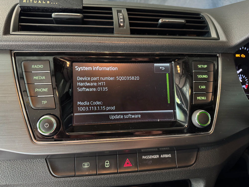

Just bought a 2015 Mk3 Fabia (RHD if it makes a difference) which has MirrorLink but doesn't seem to have CarPlay, it doesn't seem to have a radio unit in the glovebox either.
Having a read it looks like it could be as simple as changing out the unit behind the screen?
Here's the current specs under system information:
Device part number: 5Q0035820
Hardware: H11
Software: 0135
Media Codec: 1003.113.1.15 prod
Any info/price on how to get CarPlay or an upgraded unit would be great, thanks!
Picture of unit
Indeed you need to change unit behind the screen (infotainment reader, glove box unit). New unit must be patched to enable new features. I can deliver such unit, in Plug&Play version - drop me a PM if you are interested.

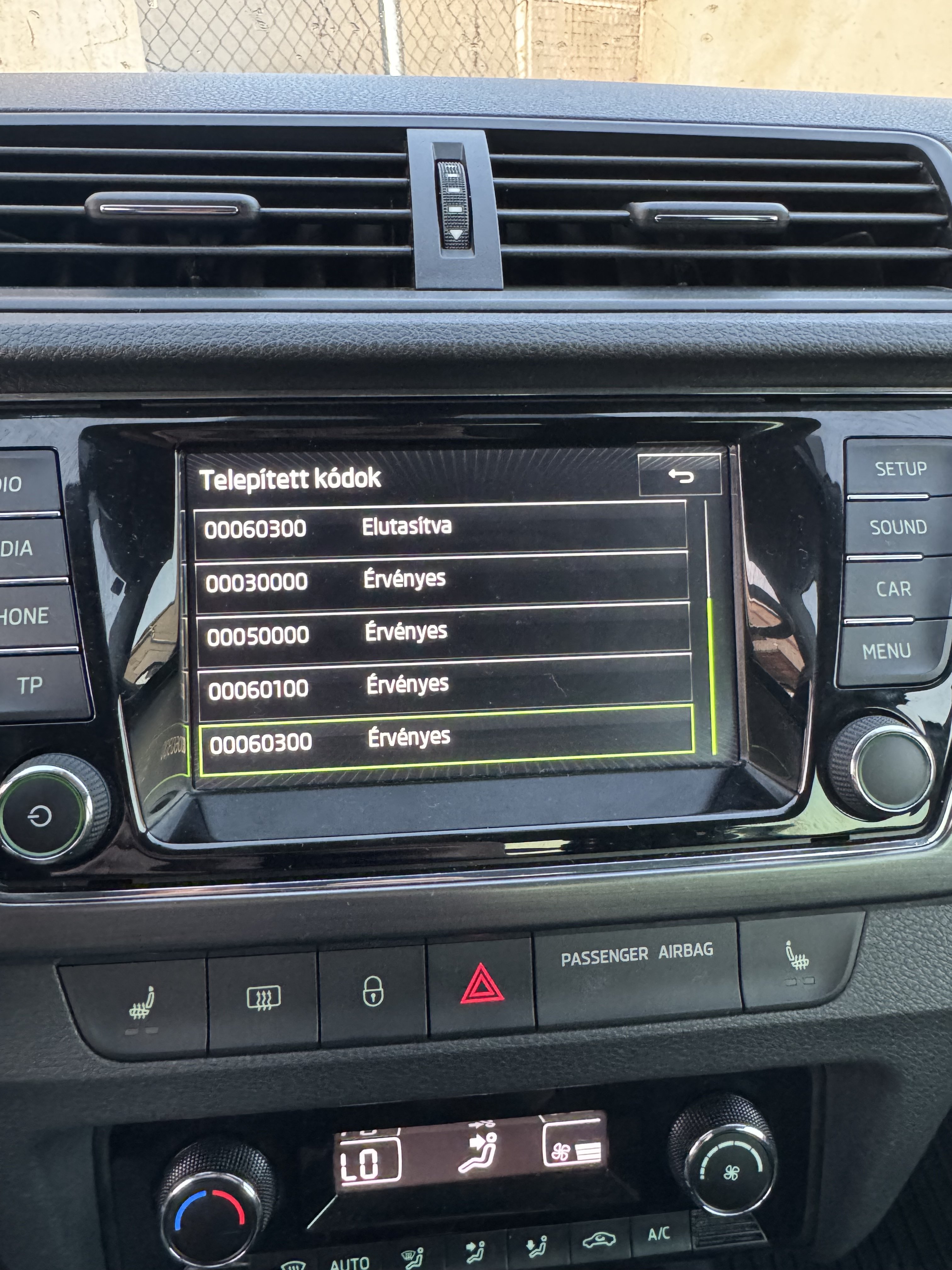

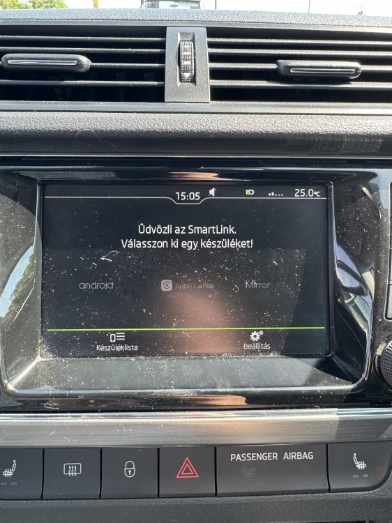

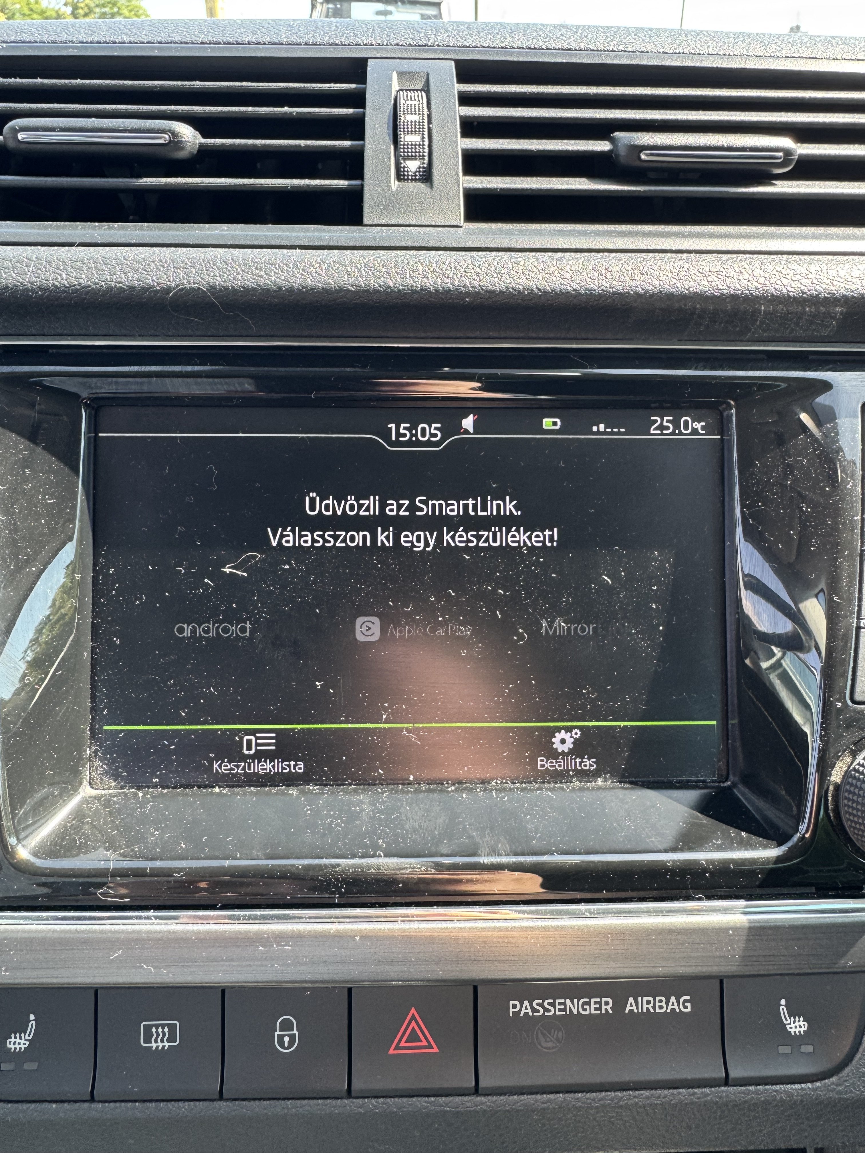

@pab567 Can you help me? My device: 5Q0035840A Software: 0245 SmartLink is available But I just can't connect to Apple CarPlay. Error message: This function is not enabled Do you know any solution? My account is new, I can't send you a private message.
Probably SmartLink is not enabled. Do you have any diagnostics tool to turn developer mode on?
@pab567
I have an original VCDS cable.
But if it's not activated, why do I see Apple CarPlay there?
It's easy to get them on the display (by adjusting adaptation channels) but if FEC/SWaP code is not inactive or missing then it will not operate.

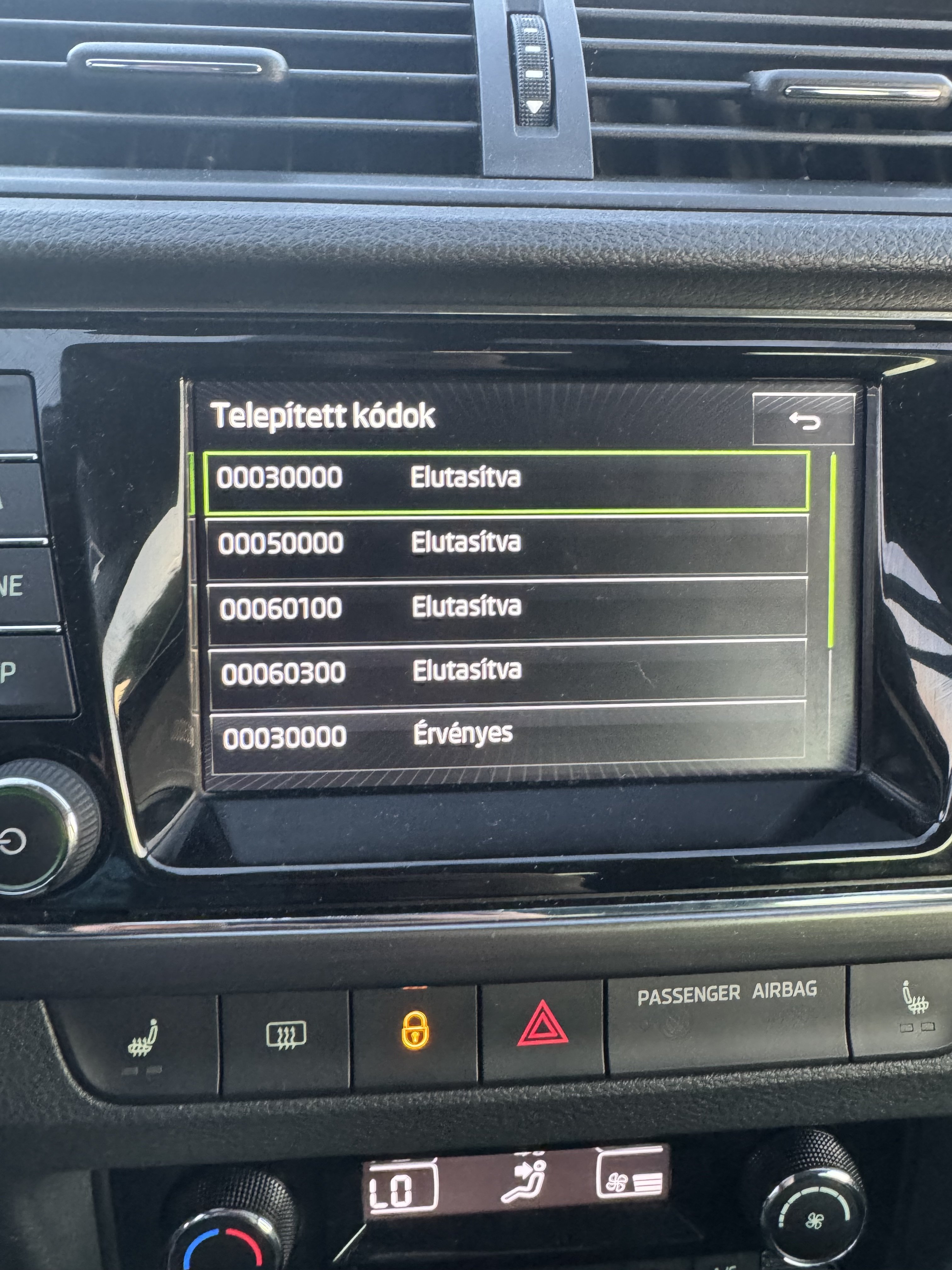

Turn developer mode on, enetr service mode and check list of installed FEC/SWaP codes.
@pab567 It was requested at the time of purchase so I'm sure it's activated.
Swap codes are active
Edited by Ganari
I have seen couple of cases where FEC/SWaP codes became invalidated...

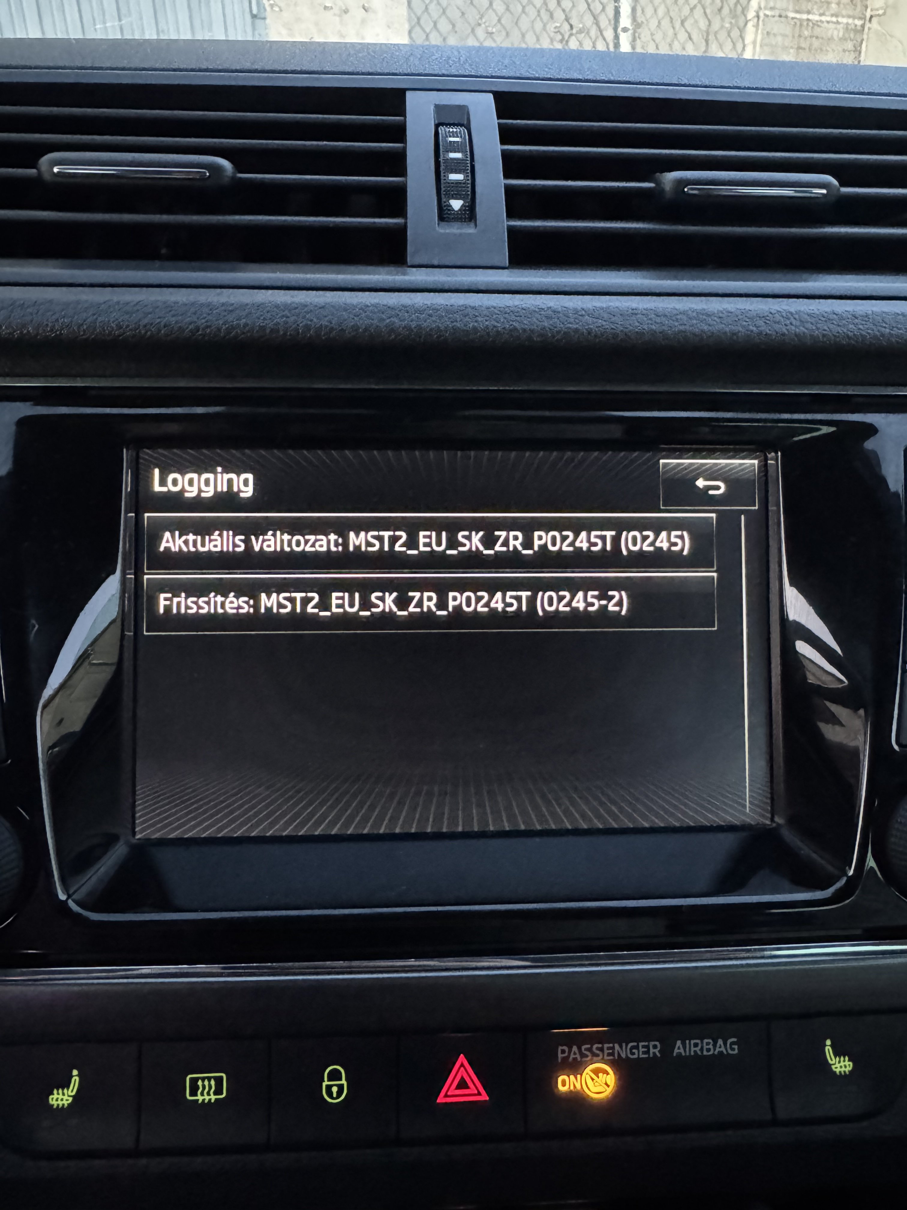

it's activated but still not :D Can you send me the MST2_EU_SK_ZR_P0480T software?
@pab567
Edited by Ganari
Is it possible that these are two completely identical software? and that's why it's being deactivated?
@pab567
I don't see valid FEC/SWaP codes for Aple CarPlay (60800) and Android Auto (60900), just MirroLink (60300) is activated. This is probably the root cause of your problem.
