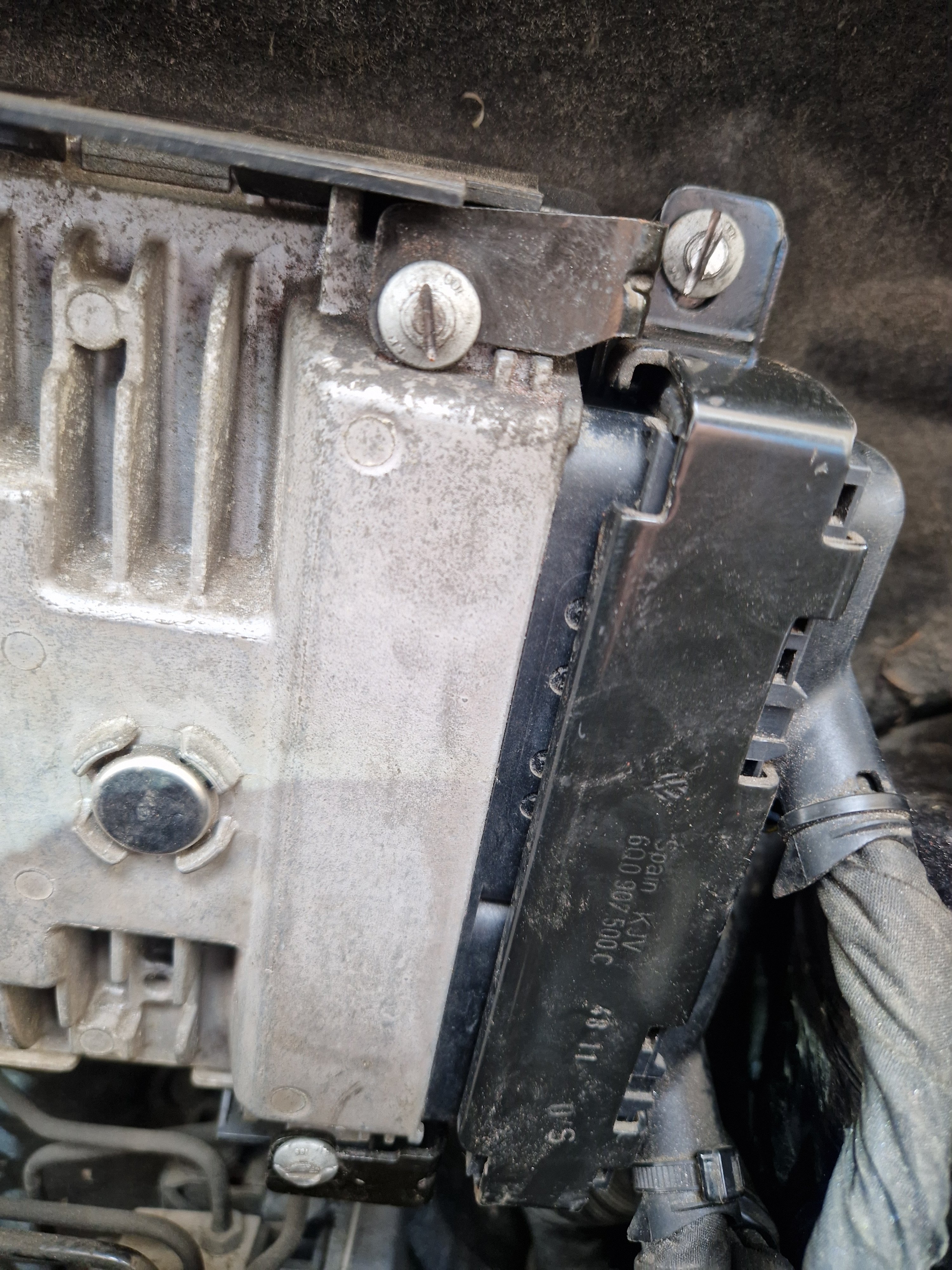

On a 2012 Roomster 1.2 TSI but probably widespread amongst other models, hence posting here.
How do you get these fasteners off, please?
Want to buzz out some wiring and can't get ECU connectors out until these are undone.
You’ll have to drill heads off
  • Sponsor
Dremmeled slots in them and used a big flat screwdriver.
