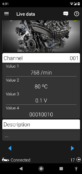

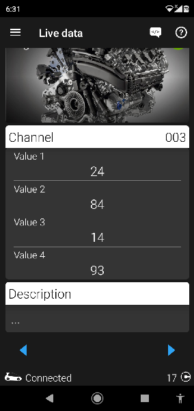

Here is what i saw in my smartphone when i connect the OBD 11 in the port.
Idle
Engine temperature or coolant temperature?
Lambda sensor?
Value 4 is?
What are these indications?
Makes my nervous that i paid for this reader and does not say what it measures (plus does not have that fancy applications with digital gauges).

@lewiswal47 are you able to help with below at all please. Surely there's a stage you see before seeing below, see D.FYLAKTOS's text and photos below and something to explain what the channel and value numbers each refer to.. -
"Here is what i saw in my smartphone when i connect the OBD 11 in the port.
Idle
Lambda sensor?
Value 4 is?
Makes my nervous that i paid for this reader and does not say what it measures (plus does not have that fancy applications with digital gauges)."
