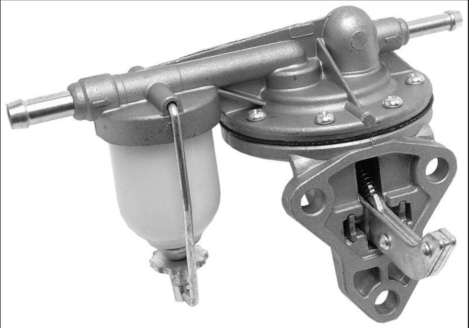

Also, for the love of god I cannot find a fuel filter for my fuel pump, I have been to every mechanic in the town and searching online for a fuel filter for my pump but cannot find it at all
This is what my fuel pump looks like, can anyone help?

For filter do you mean a filter to go in that white fuel bowl - or you could fit a disposable clear see-through in-line filter in the fuel hose before or after the pump.

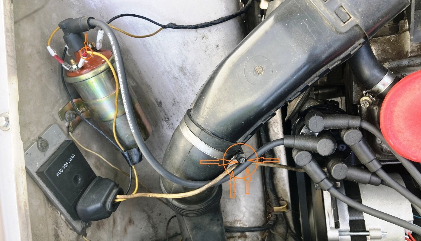

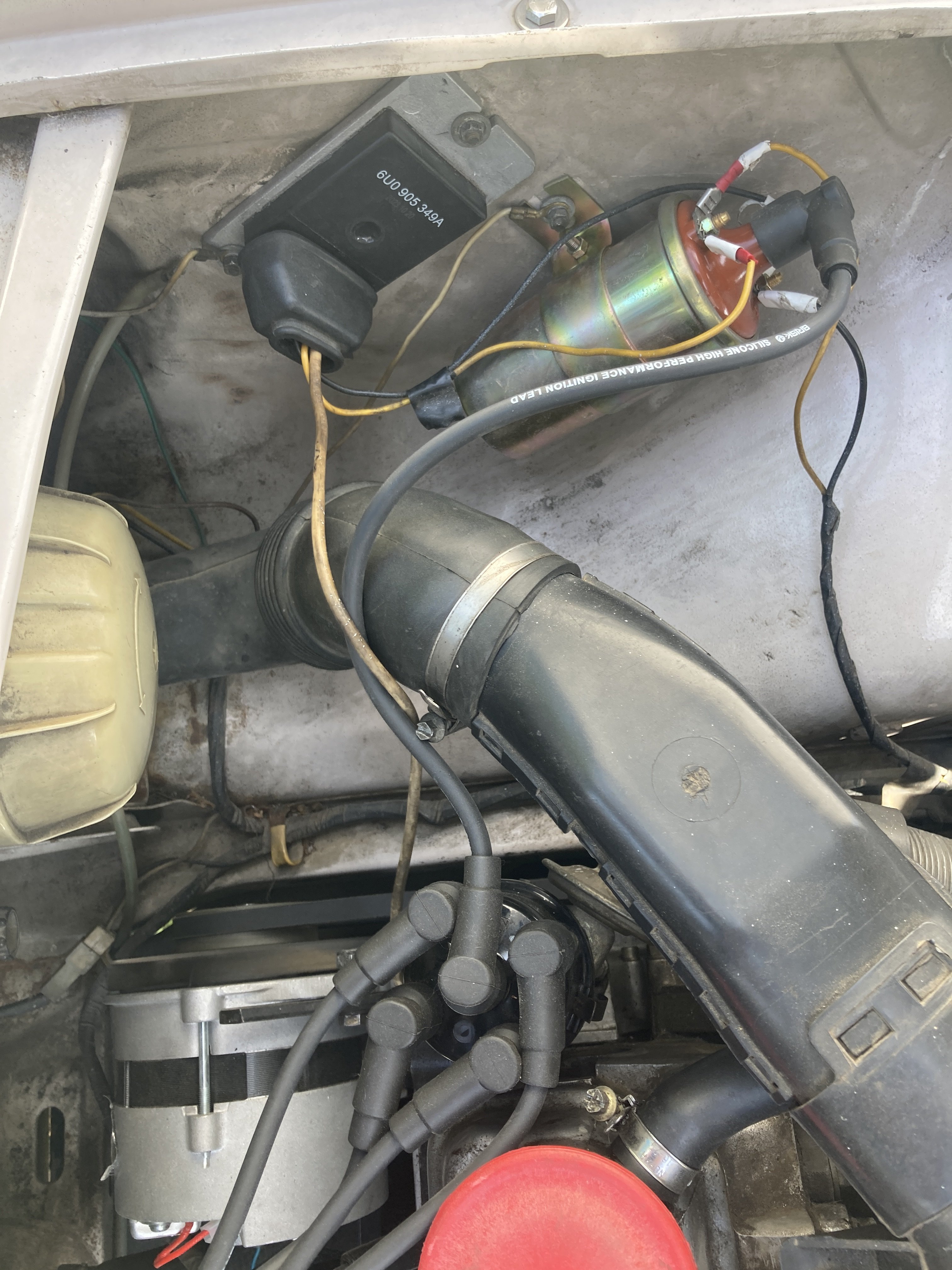

Regarding the previous pictures, the ignition coil is new, and I changed it yesterday, the ignition amplifier as well, I know the ignition amplifier is a Chinese one, but there is absolutely no difference in the car's operation between the new one and the original one ( I took them both for a test drive).

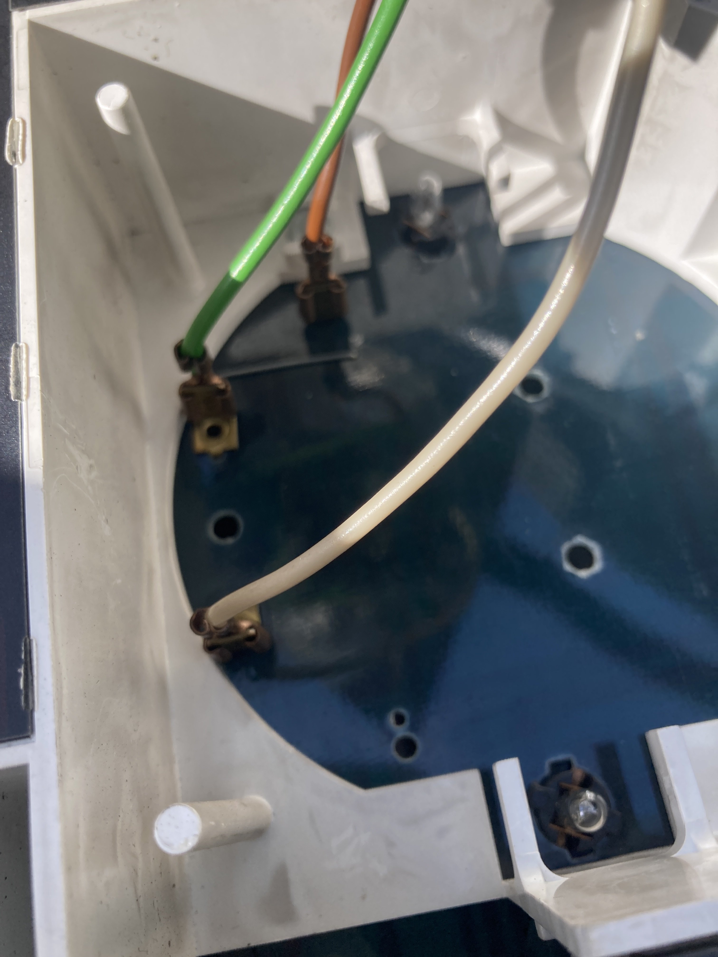

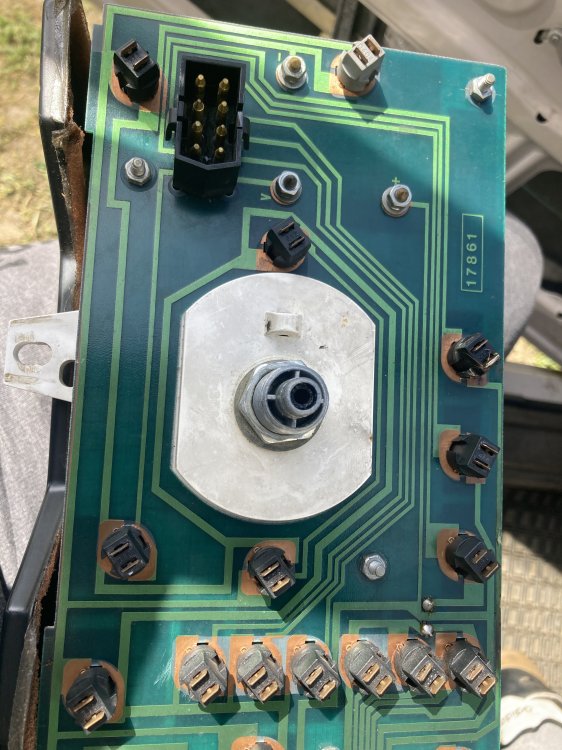

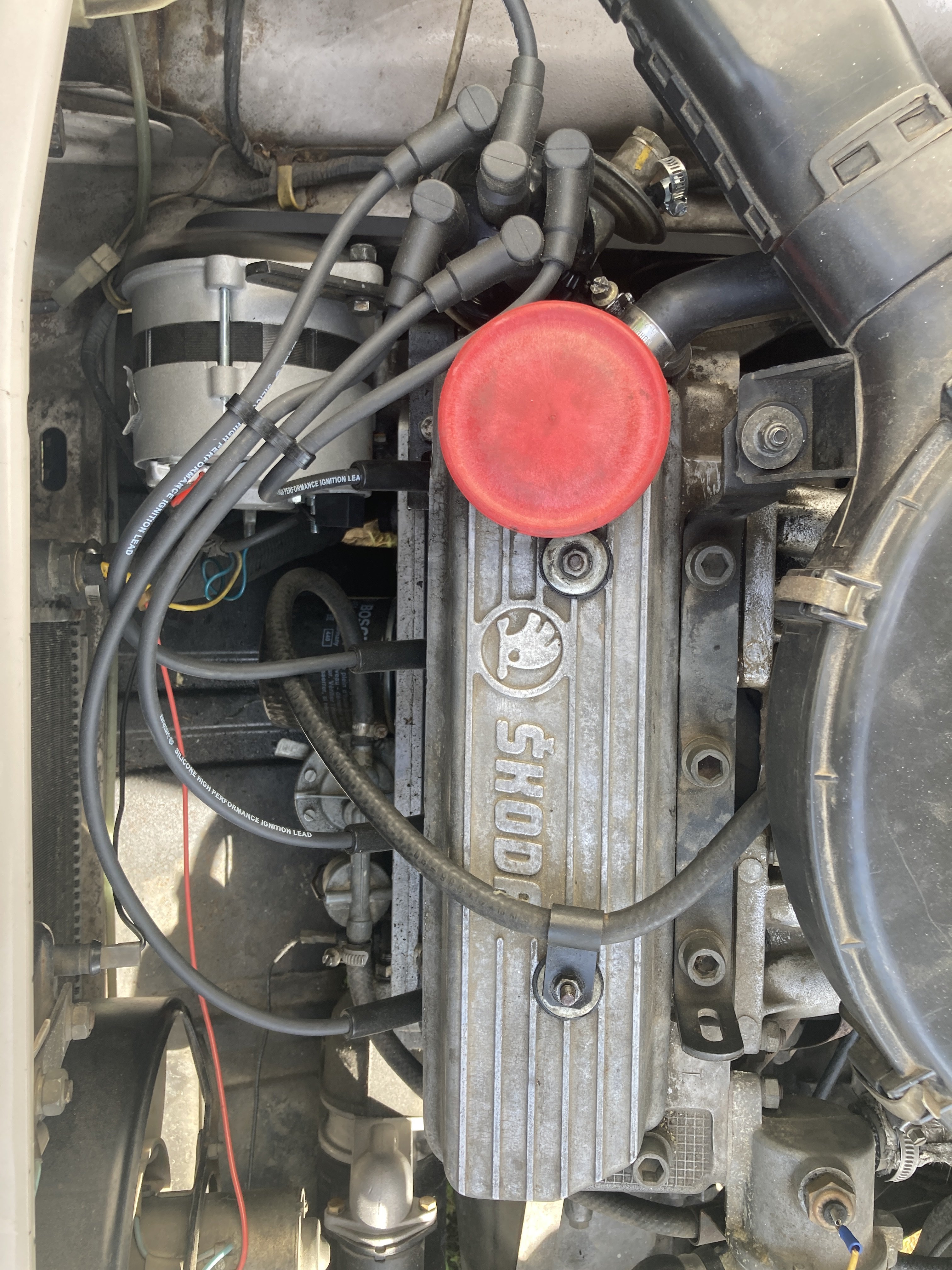

Also there are pictues of the engine bay and the instrument board as well.

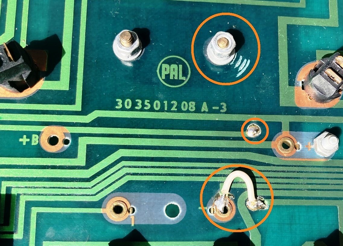

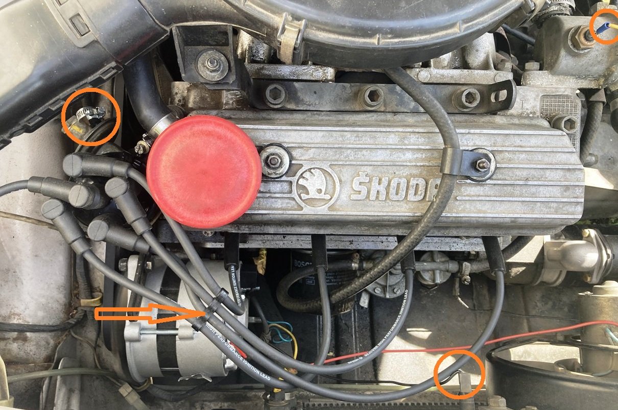

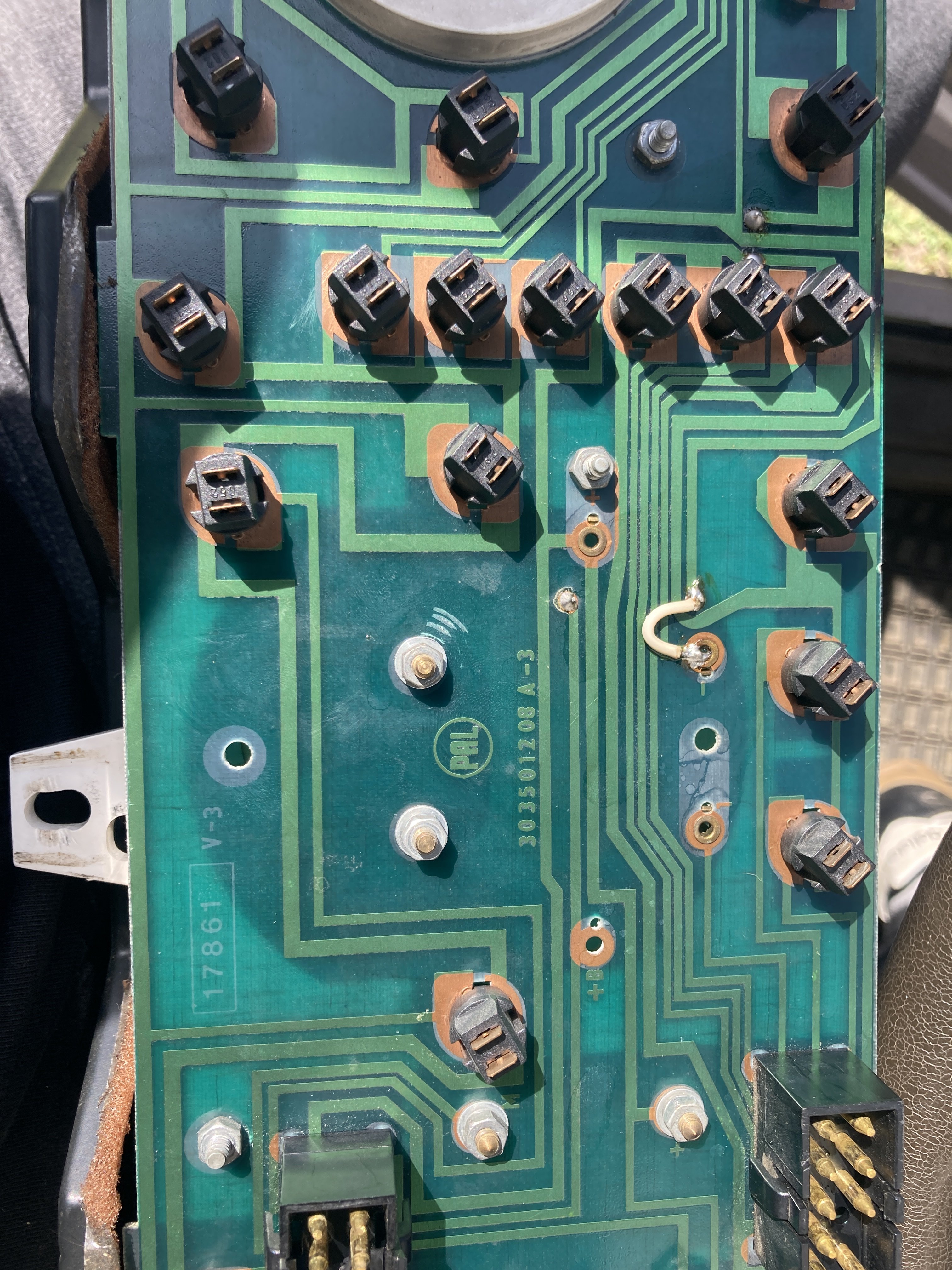

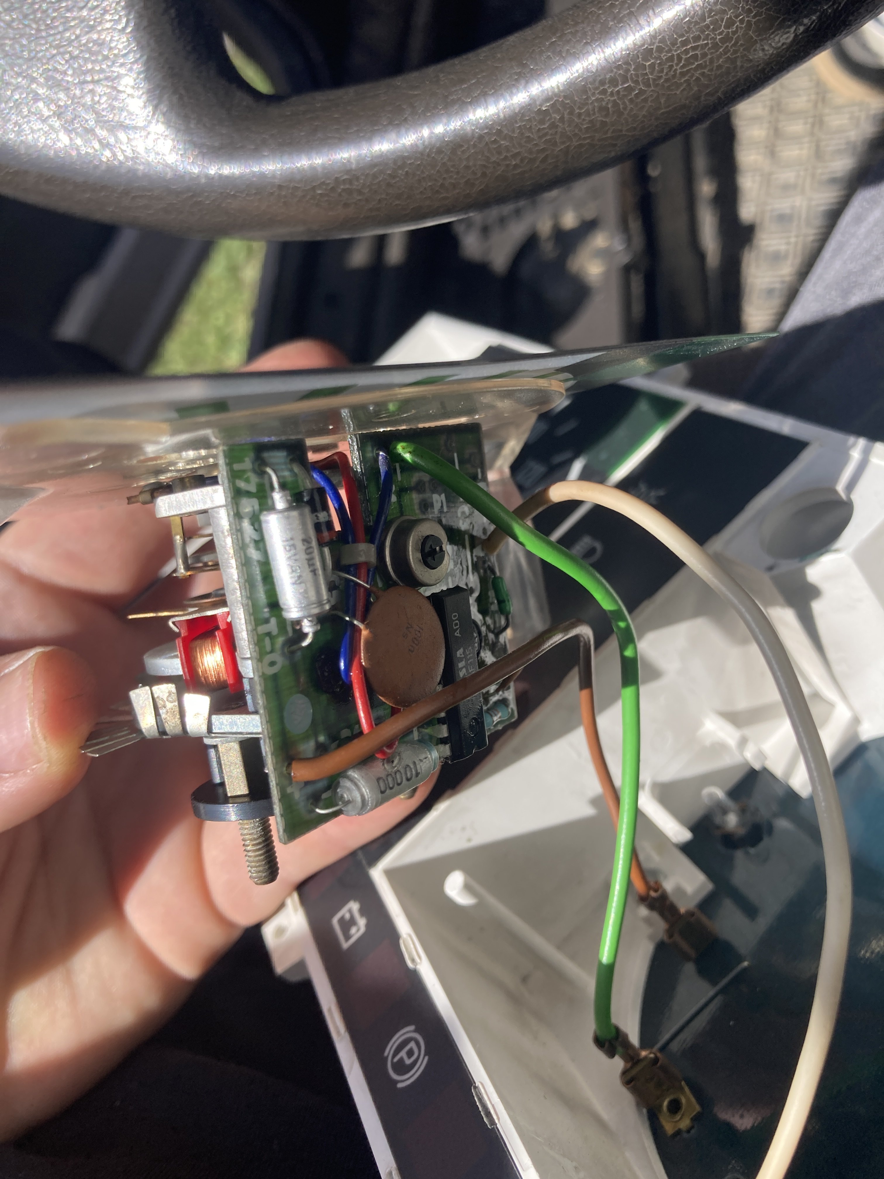

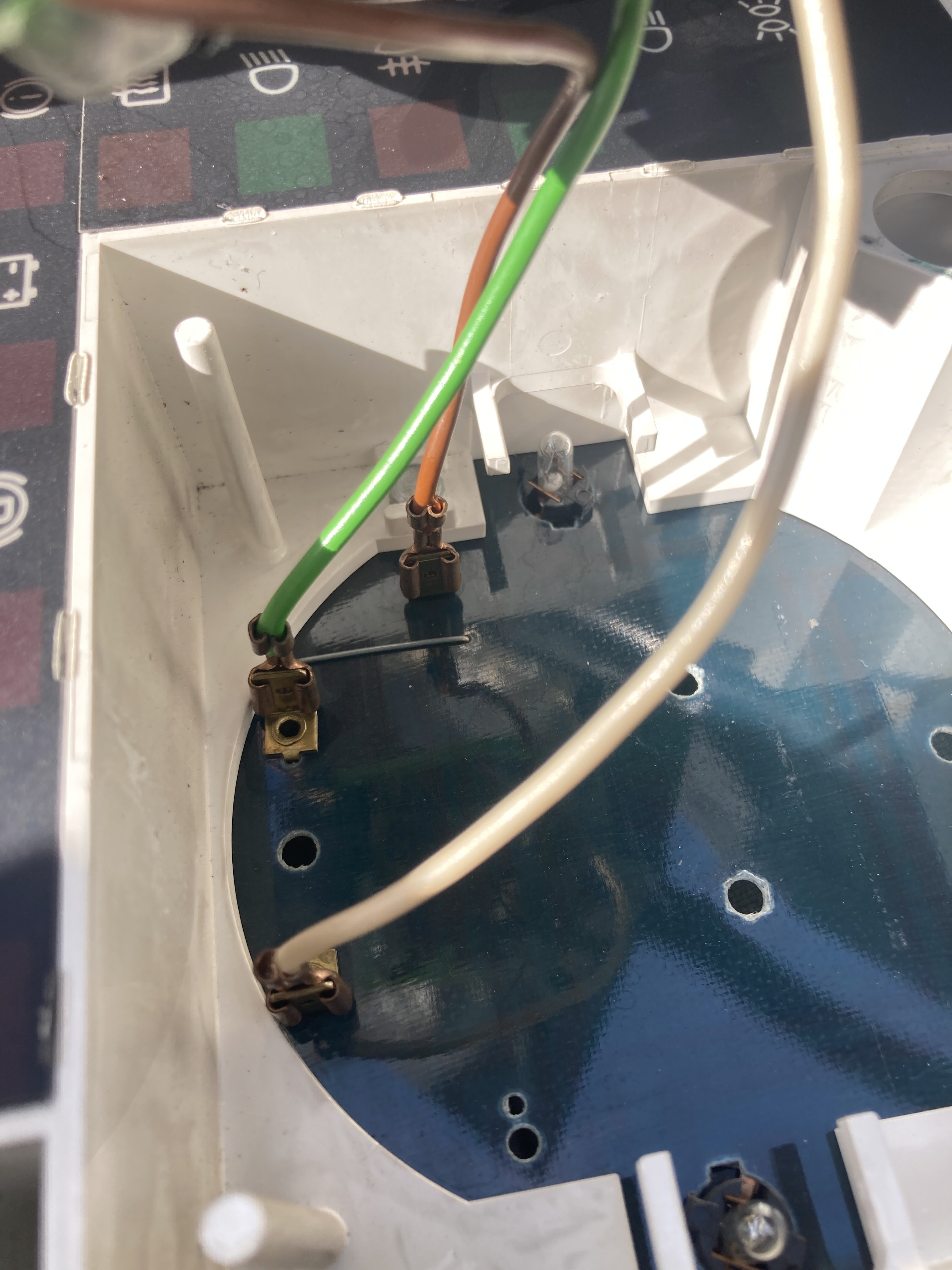

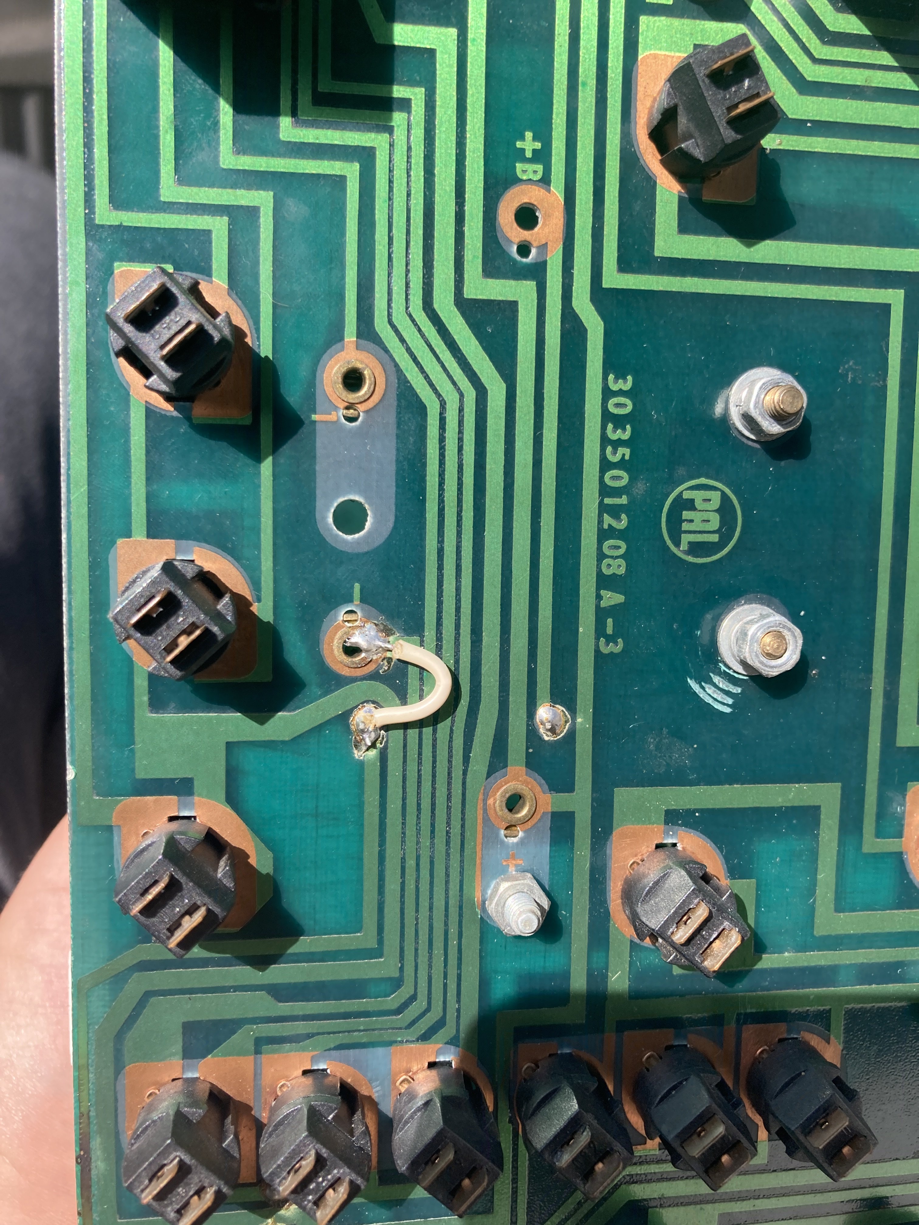

I am not criticising you just trying to help you now and for the near and further future, the things I highlight in the following photos may not at present be causing any issue(s), or they might, but you would be best to tidy up the wiring and cable routing and secure as required, independent of other cables, wires and hoses, so as not to possibly cause issue(s0 in the future and to tidy up or redo crimp connections for better more secure fit and location and prevent moisture or other ingress, shrink-wrap over secure good crimped joins or use connectors with shrink-wrap covers already on them. The wire to connectors has to be a good solid clean connection that is secure and protected.
You don't want wires and cables touching or other wires or cables or against other items particularly metal items like hose clips.
Hose clips are best as close to fit size as possible (allowing for getting them on).

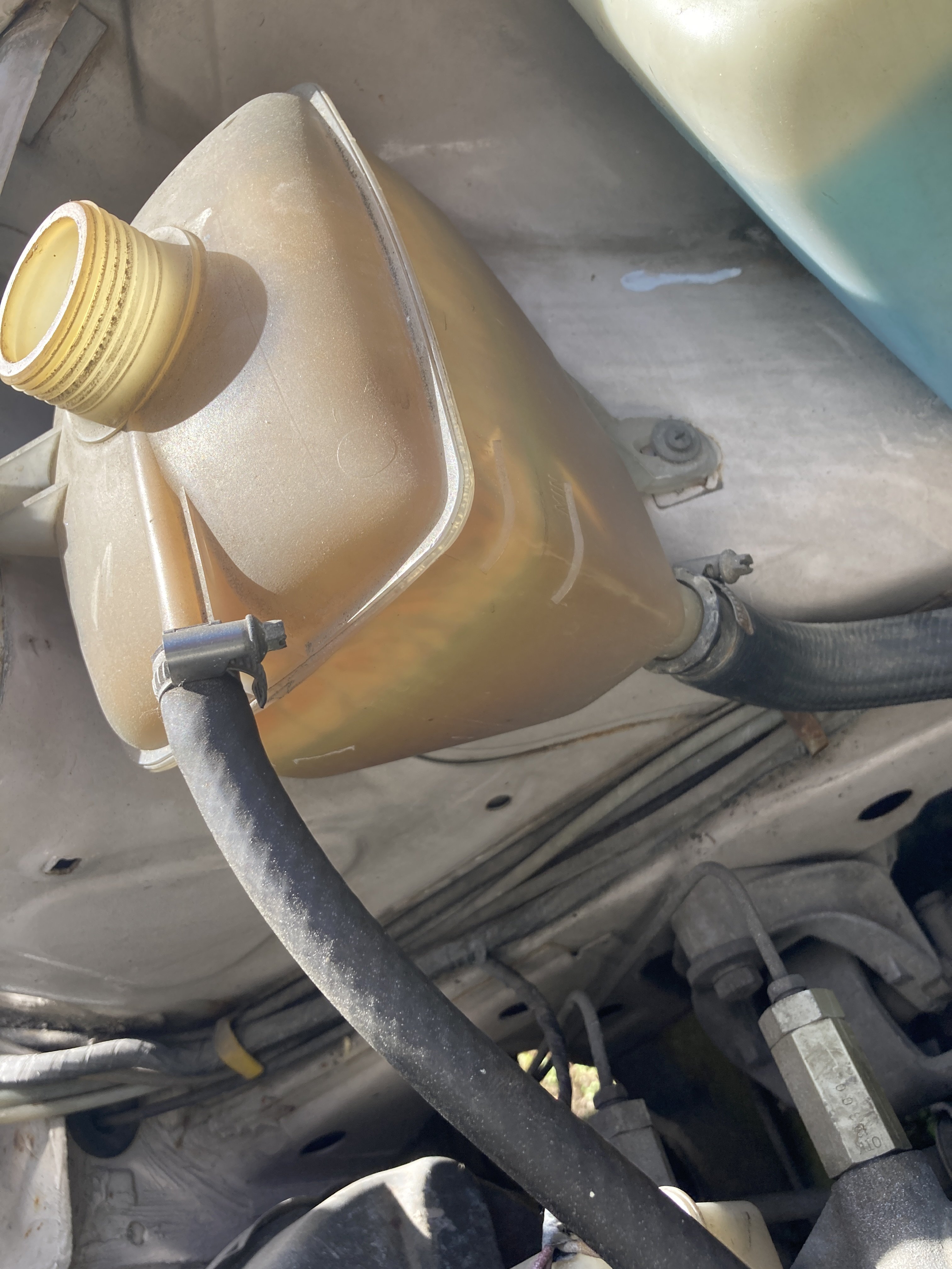

Coolant level in photo is between 'Max' and 'Min' lines so OK as long as that level hasn't drop too much and too fast from where it previously might have been (subject to levels taken at about same temperatures).

If these are for the "rev counter" then at least it seems to be working good, but more thread protruding passed the nut would be good (without damaging anything of course)
Under the 'Media Options' symbol added to the photo, very top right - see below., Oversized cheap hose clip would be good to replace at some point perhaps. HT lead pushing against wire may not be good for either, if you pull a little of he HT cable back behind the HT leads separator comb this might be sufficient.

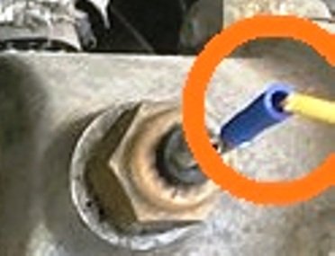

A poor looking connection on this, that could get contaminated and the wire(s) could get fatigue and break causing poor connection and readings, that needs sorting as soon as possible and reconnecting or new connection with wire insulation inside connector sleeve and wire(s) firmly connected to connector.
On coil, again yellow wire to crimp connector is poor and unprotected. At hose clip the "king lead" HT cable from coil to distributor the HT lead is touching the hose clip screw, so too is the white wire, both are touching each other and one is wrapped round the other, both want to be clear of each other and the hose clip, the white wire obviously want to avoid being near the drive belt if it needs securing.
Poor electrical connection can cause all sorts of issues and be intermittent and difficult to find so it is best to prevent as many possibilities of this as you can and it is good practice to have wires, cables and hoses as well routed and not crossing or touching as possible. Also to keep all electric and other connections as clean, secured and protected as possible.

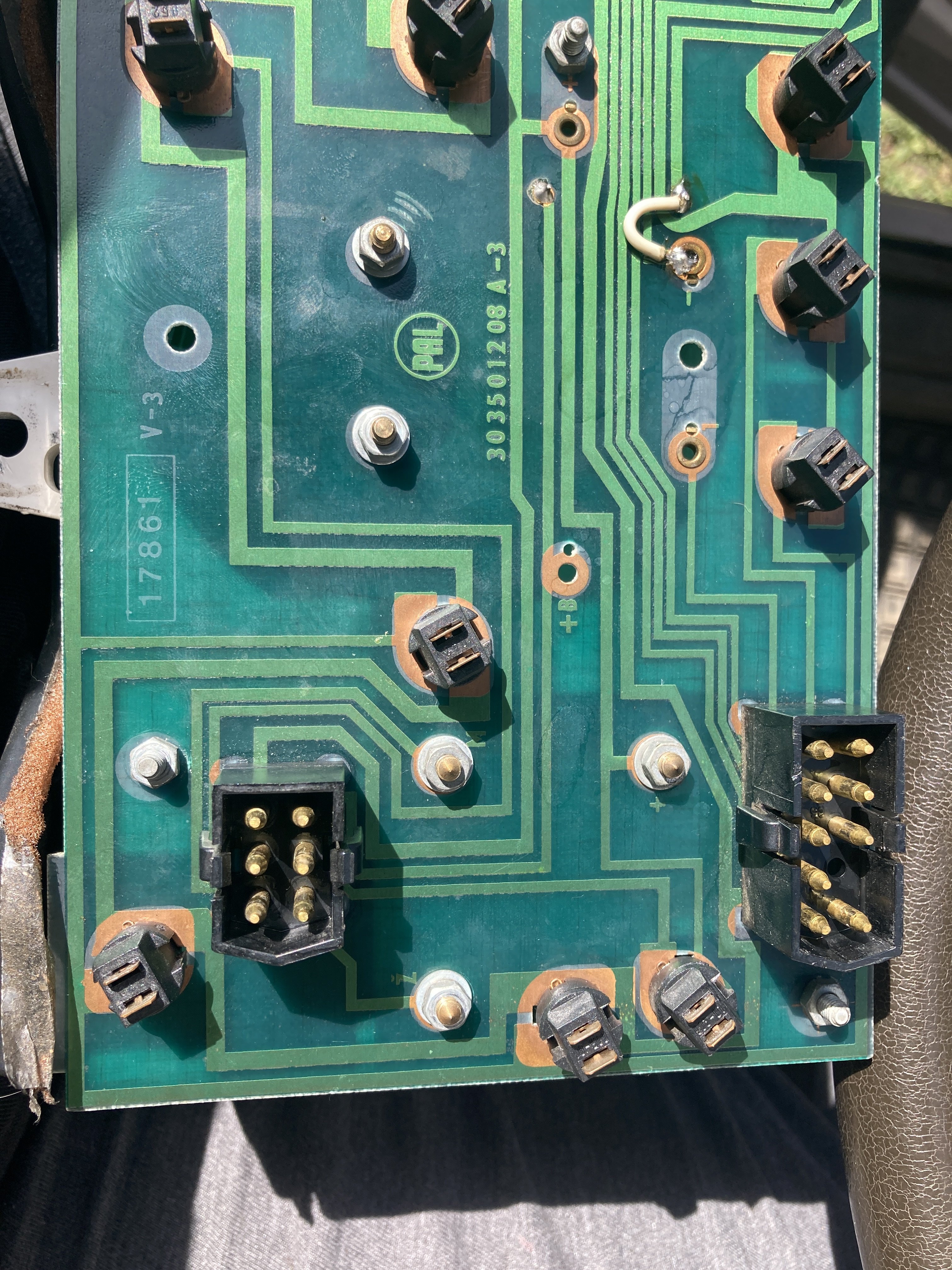

The pictures of the instrument board were taken just before I reassembled it back, to everything should be fine there. I will secure the electrical connections in a few days when my parts arrive. Then I will also change the head gasket.

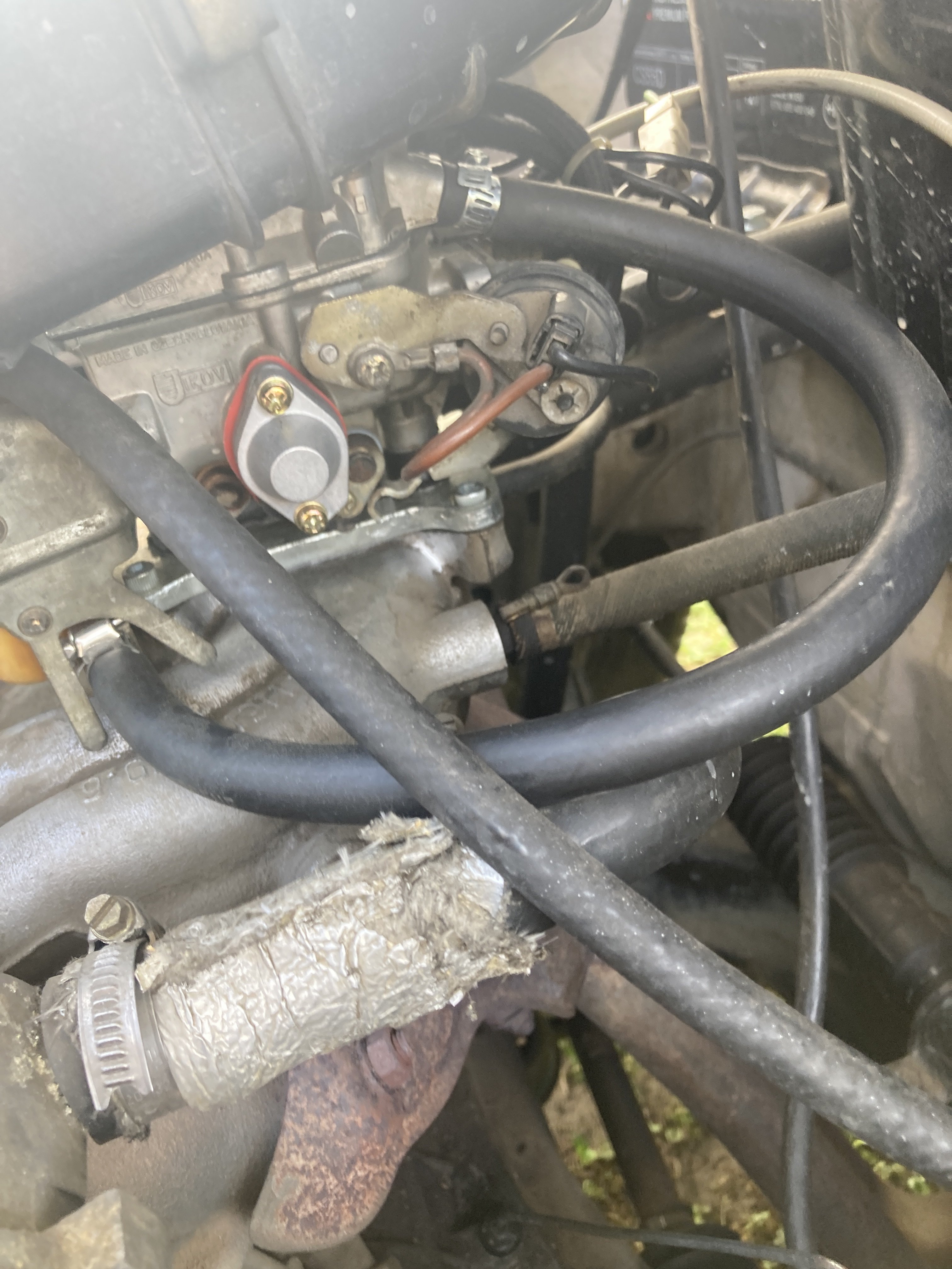

But a quick question. I am also suspecting a vacuum leak at the carburettor spacer plate as it's a cheap one. When I was replacing the carburettor spacer plate I did everything as Ricardo said in a certain post but recently I got a hold of gasket paper of 1.5mm thickness and I feel like that would do a much better job at sealing rather than Reinzosil alone at the spacer plate. As I wrote in a previous comment I couldn't find a vacuum leak with a carb cleaner, and I don't understand why, I even tried using a homemade smoke machine but still no luck. It was like that even on the first try when there actually was a vacuum leak. Can anyone explain why I couldn't find the vacuum leak at all? I tried the carb cleaner method on the first try and spent 2 500ml bottles but no luck, then 30 minutes trying with a smoke machine but still no luck. Anyways back to the question.
Can a vacuum leak cause the jerky engine as it's in my case and could it be that after just approx 1500 - 2000 km driven the seal broke on the carburettor?

I would not want to speculate why you didn't find a leak as I don't really remember the engines and carb set up at all and I was there with you when you were looking. Using carb cleaner is perhaps an expensive choice particularly after the area is cleaned.
I have no idea if 1.5mm gasket paper is as good choice or not and don't know if you are using it only one or both sides of spacer but if using a sealant that does have to be applied correctly with both surfaces clean and not have excess sealant going inside where it might come off and clog or stick elsewhere internally whereas paper if you cut it right (scissors, hole punches, ball pein hammer) paper should stay where it is put.
