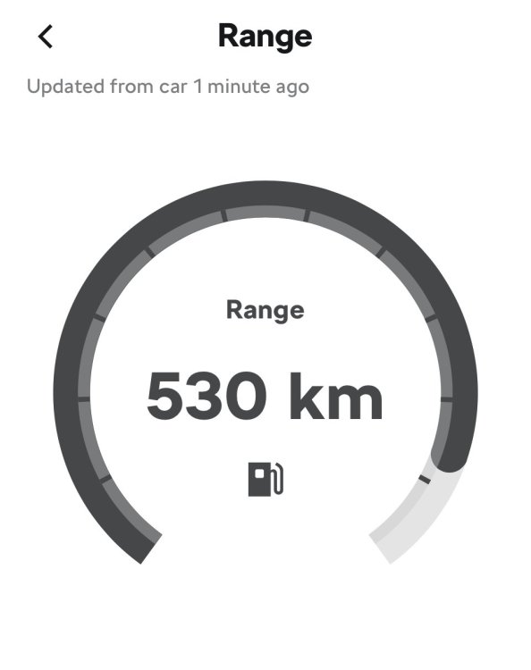

I thought I filled up at the garage yesterday but was surprised when I got back into the car and only saw 580km range on the dash. I thought ok that the pump must have auto shut off early so I did my drive for 40 mins outs and back. On the way back I noticed that the range had increased to 620km. Until then a full tank max range was 730km. I will test it again but I’m interested to know if anyone else has noticed this? Apart from that nice update in the Skoda app 7 day challenge counter 👌🏻
I'm overseas so not sure, but I believe it has been a bit warm in the UK lately???? If so the density of the fuel is affected - you may be getting normal litres/volume, but the fuel density is less and consequently it weighs less. This is probably affecting the indicated range depending on how the range is calculated from the tank contents. I'm in Australia and my range can vary post fill up by 50km depending on temperature. Best to fill up in the early morning as the fuel in the petrol station tanks should be cooler and denser.
Thanks for sharing your experience and yes this could be an explanation. I’m in France and it has been very hot as well but not too much when I last filled up around 10:00 am. I will monitor it going forward.

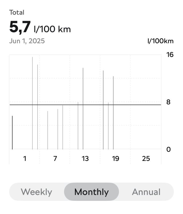

Lowest I have listed in the Skoda app is 5.7 l/100 on a motorway drive just under 3 hrs. Seems better than listed but higher when inner city. I often leave is in D mode and stick to the speed limit without too much crazy acceleration. Just relaxed mode.
