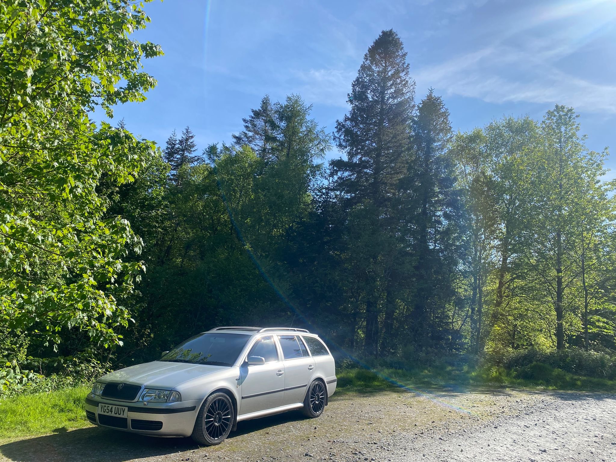

I’ve actually loved having this car I bought it just for a runner and fell in love haha, so much soul. Trying not to put too much more money in now though!
Just noticed steering has a slight left pull - wheel alignment didn’t remedy it. I’m wondering what else could be? Tyre pressures are even, tread wear is even. Maybe a suspension bushing?
Much obliged :)
Could be top mount or binding caliper on front. Check the rears as well. My old octavia was bad for rear calipers seizing. Mainly handbrake mechanism not releasing properly and pads getting stuck in sliders. I would also swap wheels on front left to right and see if it pulls the other way. Make sure tyres are not single direction.

Ah yeah that’s a great idea cheers I’ll try swapping the wheels first and have a see if that feels different, thanks for the advice
