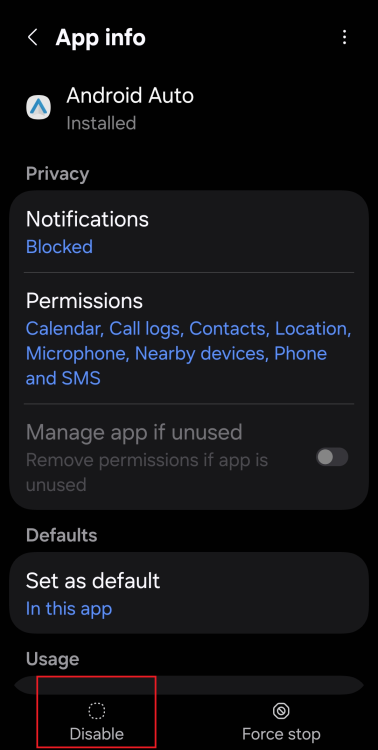

On your phone go to Settings > Apps & scroll to Android Auto. Tap on it to open & at the very bottom left of the screen is a Disable option.
Edited by Rbz5416
@Barneyboy48 you should be able to connect you phone using just Bluetooth. It all becomes so much easier that way. If then uses the built in Phone functionality of the Amundsen unit which means all the steering wheel buttons work and the phone contacts etc display in the centre of the dash …
Thanks for this.
Thanks for this. What effect does this have?
