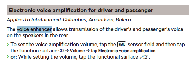

The Kodiaq had a system that amplified drivers voice and relayed it to the rear speakers for rear passengers, this gave the same echoes as your experiencing so perhaps the superb has the same system.
It could be turned off in the infotainment unit under voice enhancement.
Could be the 'voice enhancer', not the best feature of the car...
As above, turn off the Voice Enhancer in the infotainment menu.
